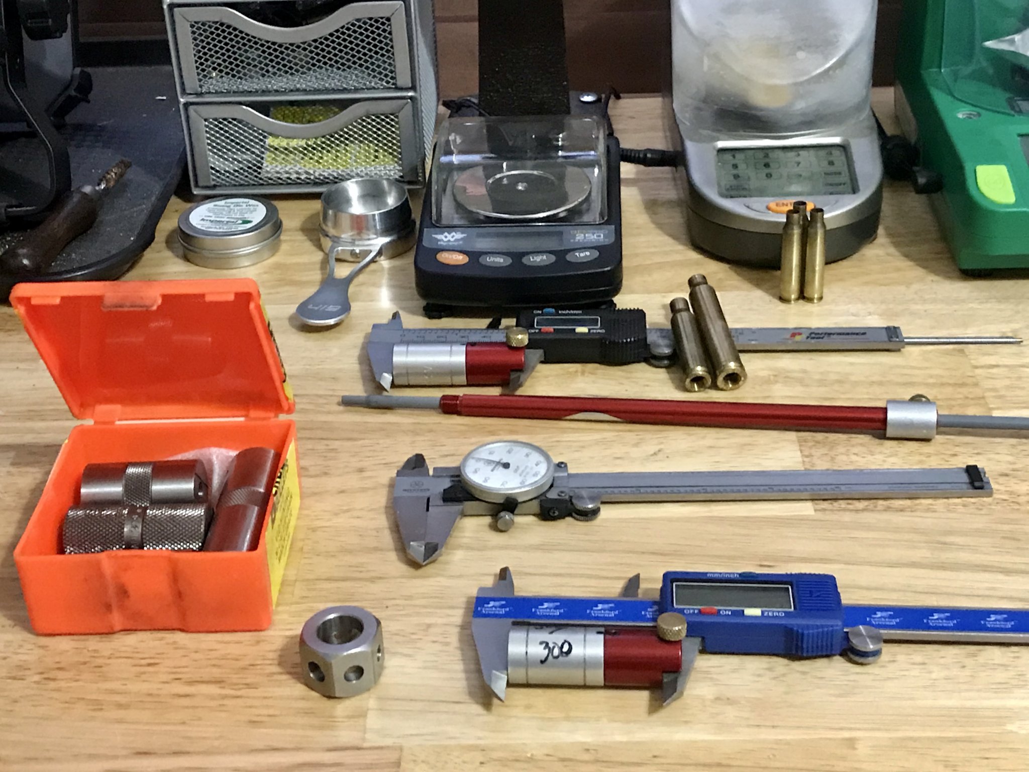

Gotcha....in addition to the above reloading kits,you will need measurement tools to set up confirm things like shoulder bump, bullet seating depth, case overall length, etc.
I’d also recommend purchasing two pairs of dial calipers, Hornadygauge with their headspace comparator set & a modified case for 6.5 creedmoor, a good bullet comparator. I’d also advise getting a good reloading manual (I use Berger and Sierra) as they have a lot of good info on reloading methods and practices.
Here are my versions of the above mentioned measurement tools:
hope this helps...please feel free to ask questions as you need to...reloading is fun (at least for me) but there is a lot of information to absorb when you’re first starting out...

Hornady lock n load single stage press kit will get you going minus the measuring tools that you’ll need.
Calipers.
hornady comparator. + insert for caliber
Hornady oal tool + insert for caliber
Bullet puller just incase. If you go slow when seating you’ll hardly need one.
dies for the caliber you’re shooting. I recommend Redding fl bushing die for sizing. I’m using a hornady custom grade microjust seating die.
Get yourself some mtm cartridge boxes for storage and to hold rounds for the trip to the range.
The scale will probably be your first upgrade after awhile.
I just bought the rcbs chargemaster lite on sale from Natchez for $219. I really like it.
I can seat bullets while it’s dropping the next charge.
You don’t need one right away but a chronograph is pretty helpful for sd and es numbers to know you have a good consistent load.
