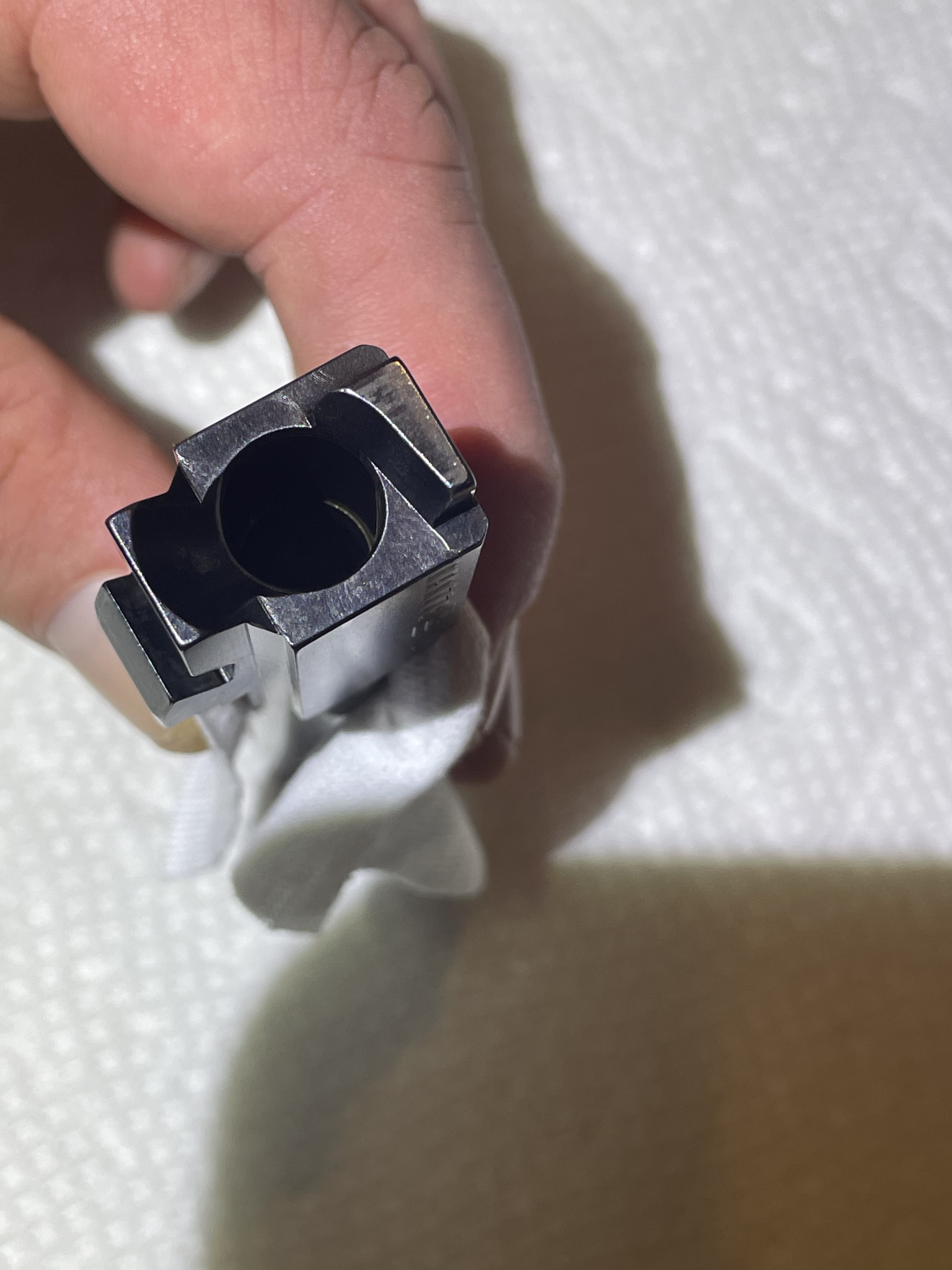

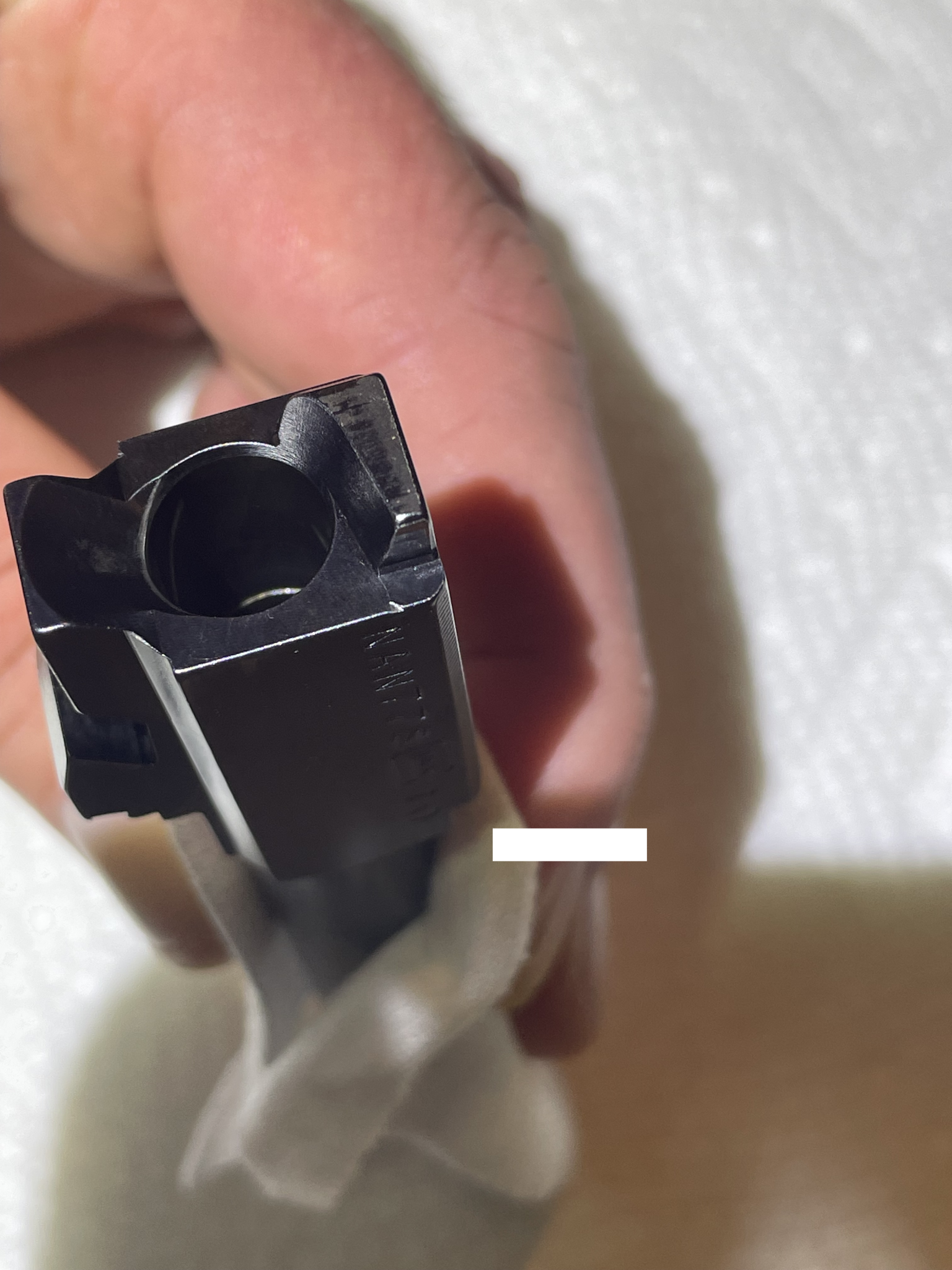

    To start with- I should begin where all good stories begin, at the beginning and what started this exchange. I have a G19.3 purchased NIB in 2009 and the pistol has been an absolute rockstar ever since I owned it. I don't mean to overestimate the round count but after 15 years, I'd say that it likely is in the ballpark of 10K rounds. All factory ammunition using brands such as S&B, WWB, UMC, Blazer, Magtech, etc. There was about 1-2K rounds of NATO spec ammo and maybe 500 rounds of +P. I know that I've replaced the recoil spring at least twice (so minimum of 3 OEM recoil springs since owning it NIB).
    So with that said- I'm a bit on the neurotic side when it comes to cleaning my firearms, doesn't matter if I put 50 or 500 rounds through it, it just bothers me to go to bed with a 'dirty' pistol. Well about 2-3 years or so ago, I was cleaning the pistol and noticed that there was a chip on the outside of the barrel with what appeared to be a hairline fracture that went from the chip all the way to the 12 o'clock position of the barrel. Truth be told, I already had a backup G19 so I took the Gen 3 out of rotation figuring I'd bring it to a GSSF match and have an armorer look at it for free but between COVID, work, and life, what was supposed to be a pause intended to only be a couple of months turned into years and this year I finally had the craps of having a pistol on the sideline for so long and decided to reach out to Glock's customer service.
    Before I get too far, I know the pictures aren't of the greatest quality but I'll throw the pictures of the issue I'm describing here below-

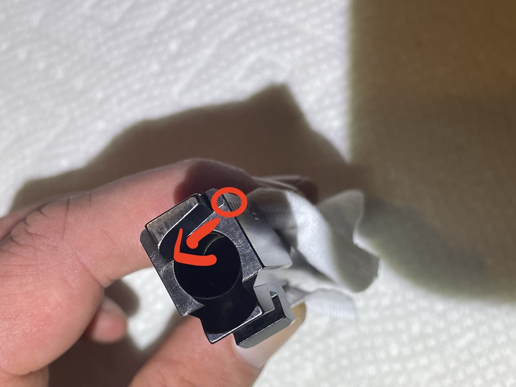

    Since I know it's not the best quality, I'll also throw in a crudely edited picture of the area in question...
    Not sure if it'll come through but as members here are well aware, this is the part of the firearm subjected to tens of thousands of PSI each and every time a round is fired during normal operation so naturally I was concerned about metallurgical issues at this point which is what caused me to seek Glock's opinion on the matter.

    So as I was saying, I was concerned about a potential barrel defect identified while cleaning my G19.3 and after my original plan of having a GSSF armorer look at it turned from months to years, I reached out to Glock's customer service team (of which I've heard nothing but glowing reviews.

    So to recap, I'm on the phone now with the Glock tech the evening of 14NOV to discuss the barrel. This recap has gone on longer than I was hoping for so I'll try to be brief to wrap this up...
    They completely agreed with me that the rear of the barrel was indeed chipped and contained a fracture. They also determined that the damage wasn't caused by negligence on my end or accidental damage such as dropping it. They deemed the damage they observed to be the result of 'normal wear and tear' on a part with a limited service life and as such was not a material defect. They then said they were prepared and ready to sell me a replacement barrel as soon as they had my credit card information.
    We had a brief discussion about the location of the damage and that it appeared to be the result of originating from the outside of the barrel and working it's way in towards the chamber which would be contrary to the forces that exude pressures from inside the chamber outwards during normal operation to which they agreed was very unusual and odd to them as well but they believed it to be the result of a steady diet of high pressure rounds which caused accelerated but normal wear & tear. I disagreed with their conclusion about the 'high pressure' element but at the end of the day, that's what they decided. I asked if they'd ship the barrel back that I sent them and I was told company policy prevented them from returning parts determined to be unsafe. So they had me between the proverbial rock & hard place with a pistol I can't use without a barrel.
