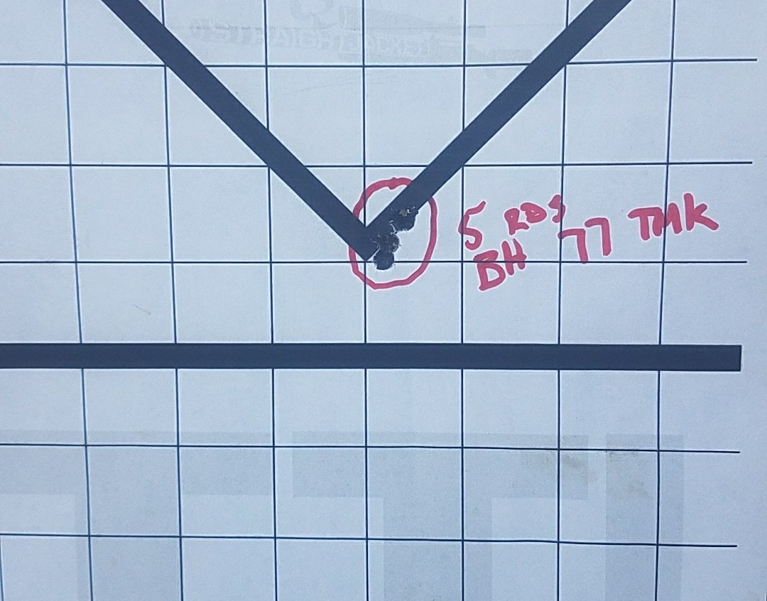

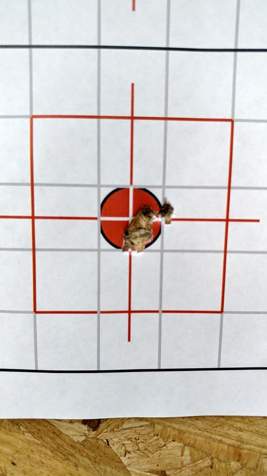

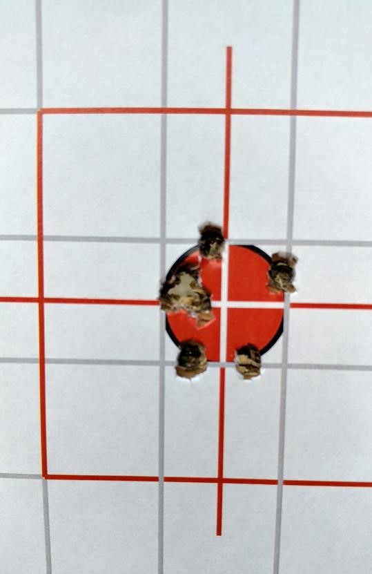

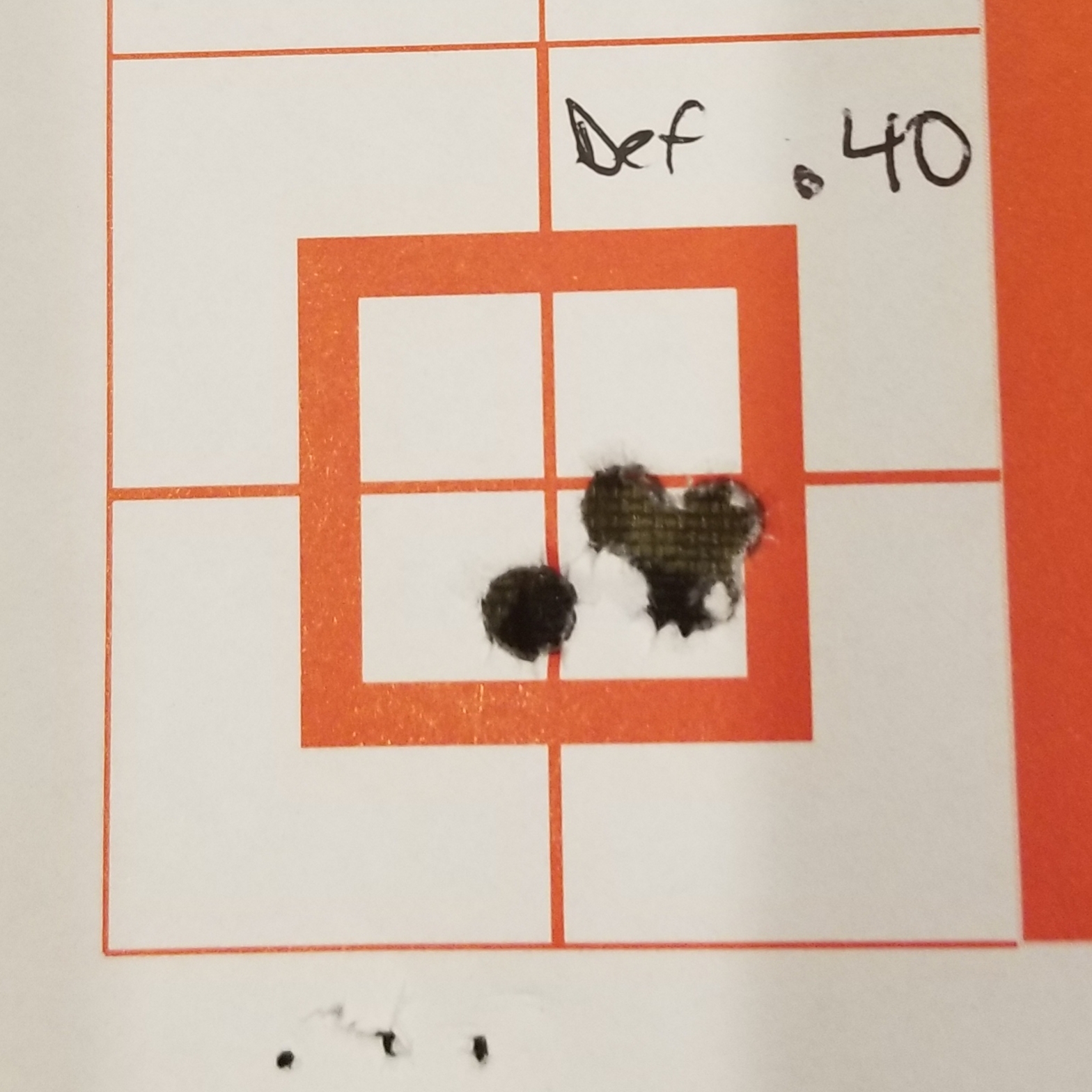

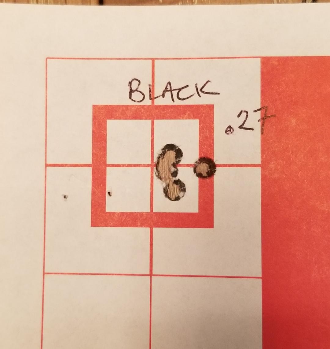

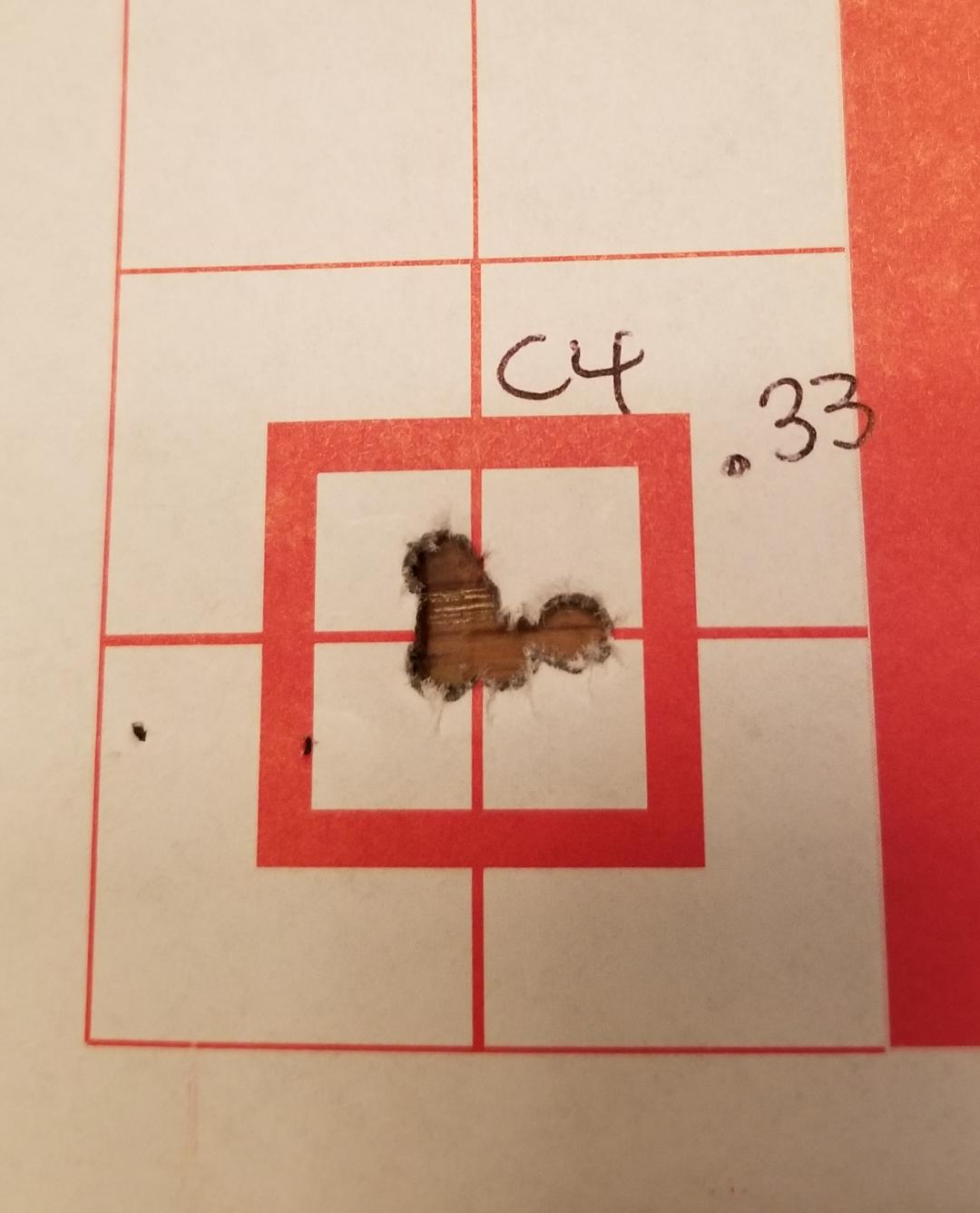

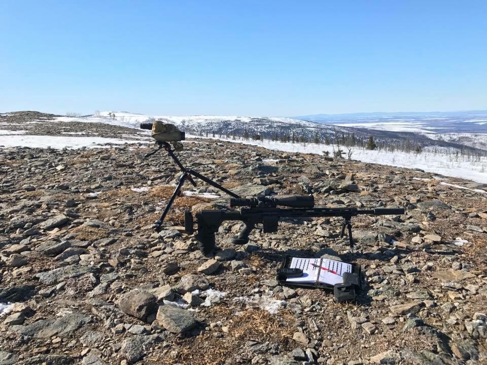

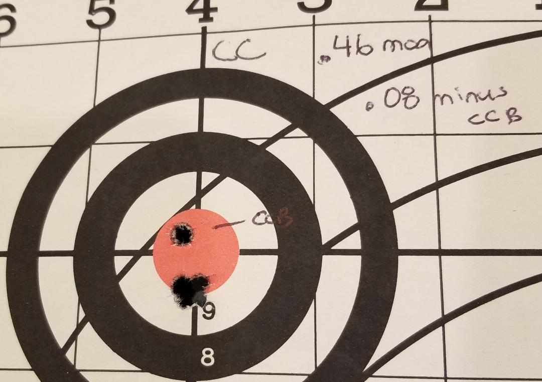

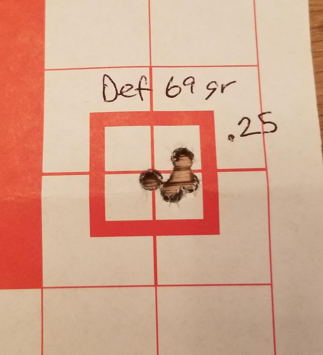

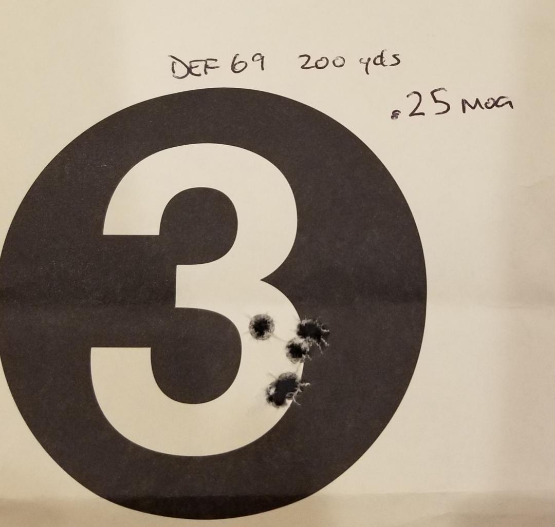

My JP routinely does this.....all 5 round groups with commercially available/factory ammo. Copper Creek, Defender, Hornady Black.

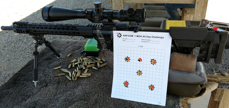

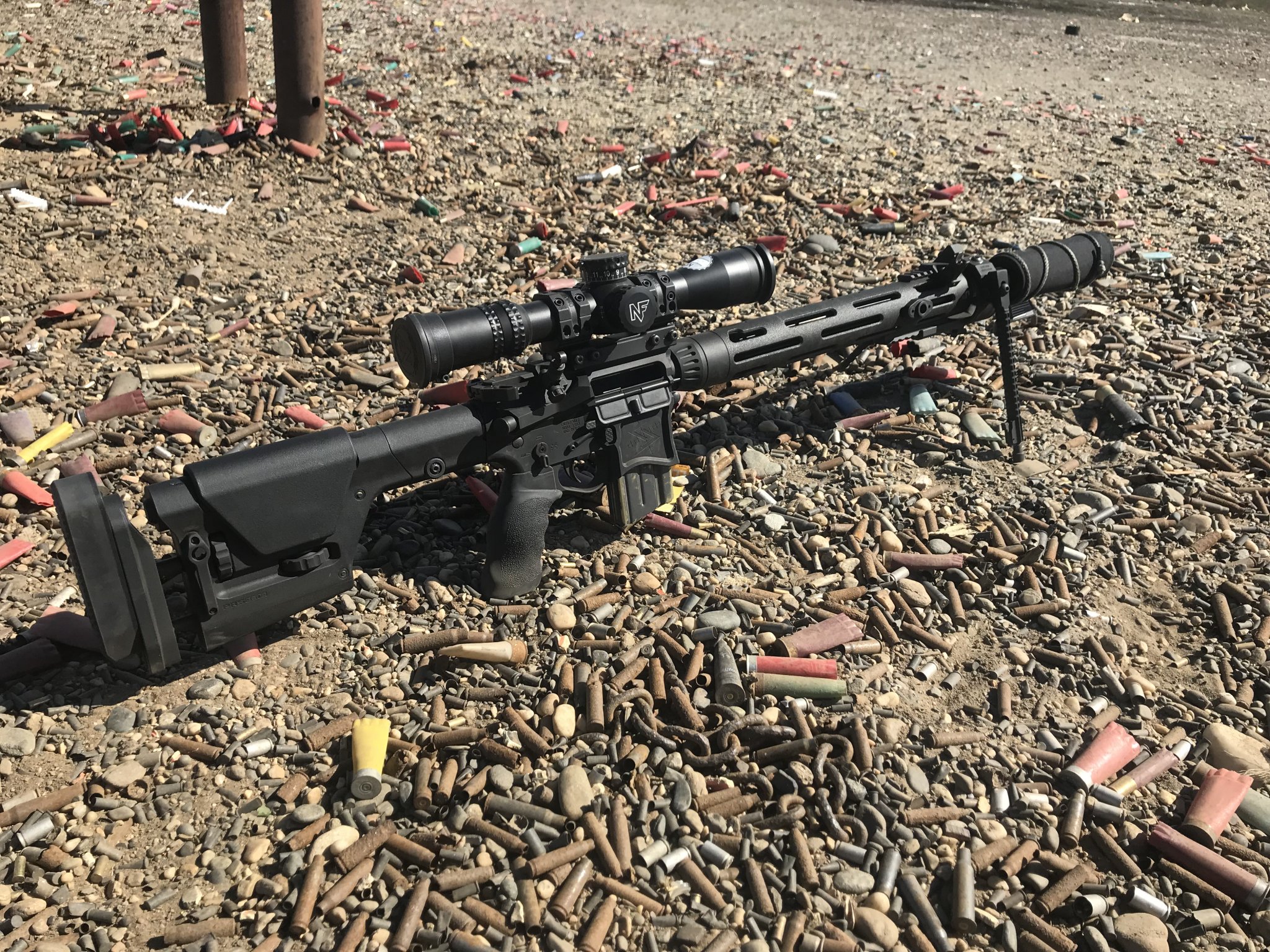

I just finished this build. It's .5 MOA. I bedded the barrel into the receiver and lapped the receiver face. Made huge difference. I didn't use super high end components. Rock River upper and lower. Rock River BCG. Wilson Arms 24" SST Fluted Barrel w/.223 Wylde Chamber. SLR adjustable gas block. It's shooting just under 1 MOA with cheap American Eagle 55 gn and 1/2 MOA with Federal Gold Medal Match.
Federal 69 gn. Gold Medal Match
55 gn American Eagle

That’s what I would do. I used Loctite 620 for bedding the barrel. Don’t use the wheeler tool for lapping the receiver. Buy the brownells tool. I wouldn’t worry about the play between the upper and lower unless it’s excessive. I’ve only built a couple ARs. If you’re anywhere near Dayton, Ohio I’d be glad to help you do it since I have all the tools. If you buy a new barrel I’d get a bolt with it that is head spaced for that barrel. Also, get an adjustable gas block.

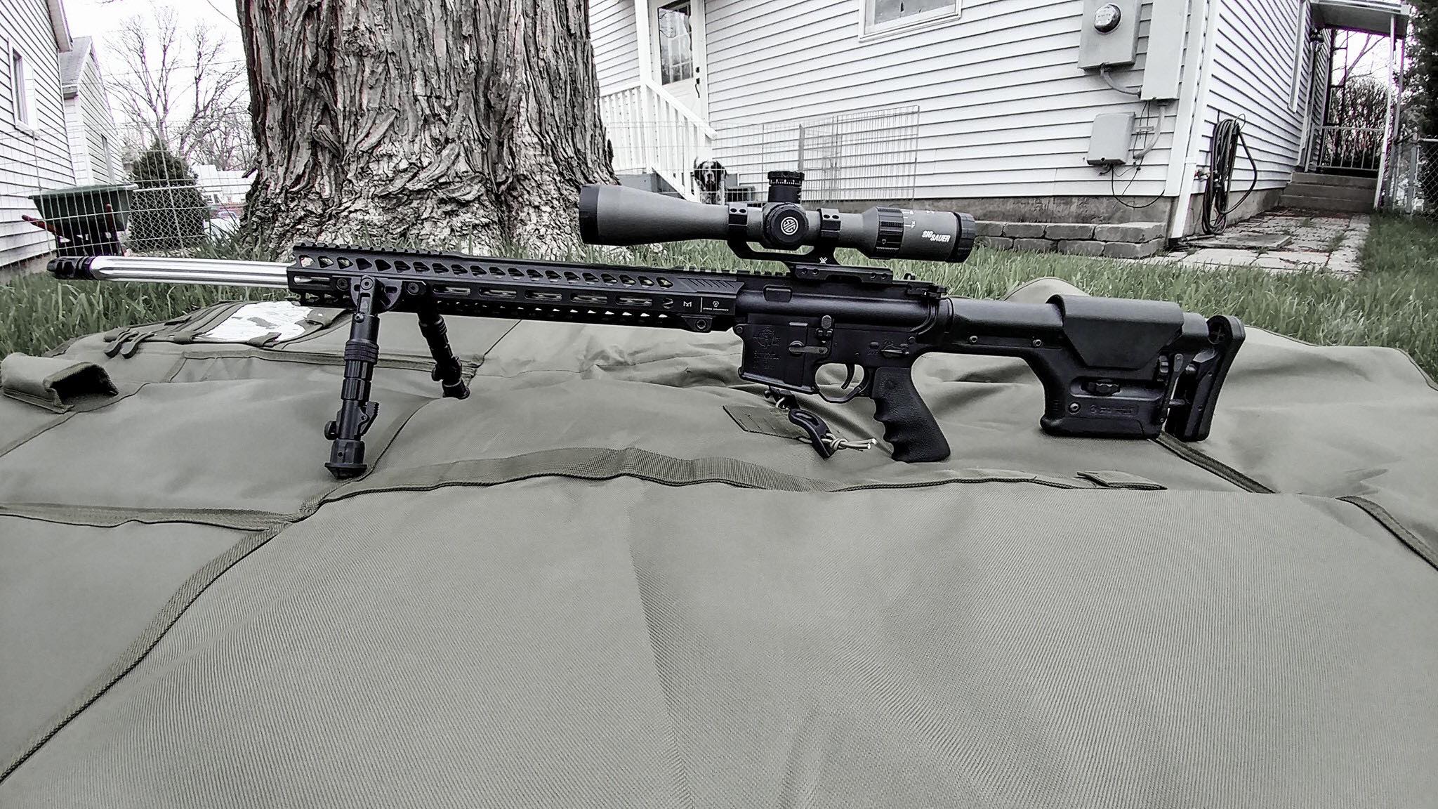

Built two AR platforms for precision shooting both are under .5 moa.
Build one: AR-10 .260
Mega upper lower set, geissele nm trigger, magpul prs, ergo grip, jp 22” barrel with their XL gas system, jp adjustable gas block, jp full mass bcg, jp silent capture, jp handguard, tbac ultra 7 and a USO 5-25 in a spuhr mount. Shooting Lapua brass, 210M primers, H4831SC, and Berger 130gr hybrid AR.
Build two: AR-15 .223 wylde
Seekins upper and lower set, geissele nm trigger, magpul prs, ergo grip, jp 20 barrel, rifle length gas system, jp detent adjustable gas block, jp v mass bcg, jp silent capture, jp handgaurd, tbac ultra 7, and a NF ATACR 4-16 in a spuhr. Still doing load development on this one using 77gr tmk’s But so far I’ve consistently got .45”-.6” groups, it is also in the .5-.75 Shooting Prime factory ammo, which is a good source for brass :). This build might also get a 224 valk upper for it depending on how the valk takes off.
