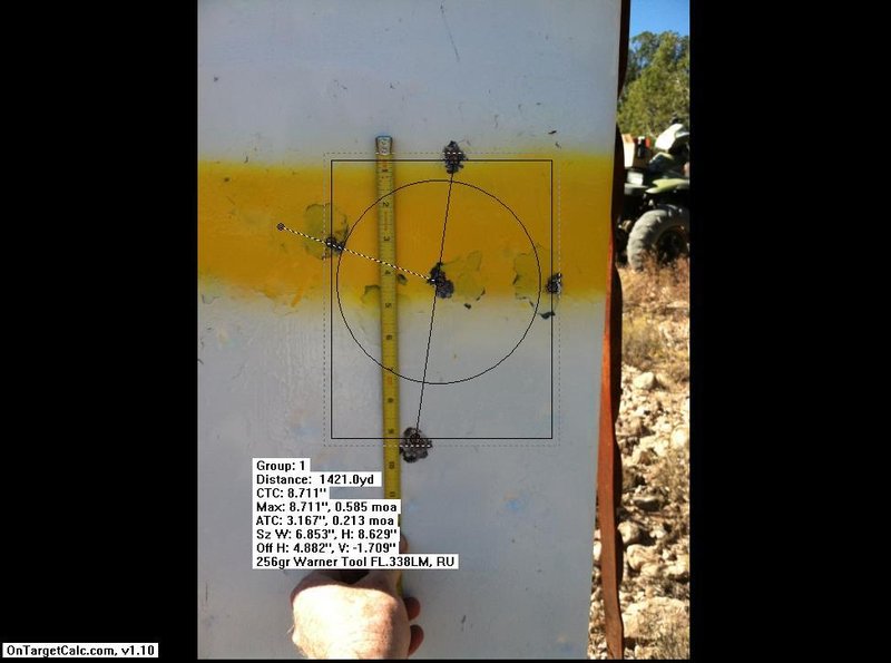

    So I had a little time before a class starts again on Friday, so I went and tested the 338 with the 256gr Flatline. WOW!
    1300m, 5 shots starting CB. I’m using 95gr of Retumbo in the Ruag cases. Too long to mag feed (4.030”). 9.6 mil up, 25.00inHg, 68F, 16%rh
    Yeah, the 256 flatline, a pretty neat bullet for sure. I'm still experimenting with loads for these but had some success today at 2500 & 2000 yds on steel (20.4 & 14.5 mils respectively) with 102 grs of Retumbo in my .338AI giving me 3200 fps on the Labradar out of a 32" Krieger. That's at a DA of 7000 (just NE of Gunsite actually). COAL is 4.080 putting this particular load @.020 off the lands. That load would put me at 8.3 Mills @ 1300 meters. A hot load for sure but the Lapua cases stand up to it pretty well with only a very slight ejector mark on one case today (out of 22). Peterson cases seem to actually hold up a bit better with that load (IF they survive the fireforming) due to a slightly larger case volume but at a bit less velocity of course. Still experimenting & want to get my SD'S down a bit yet but these particular bullets definitely show a lot of promise! Holy moley they are expensive buggers though!
