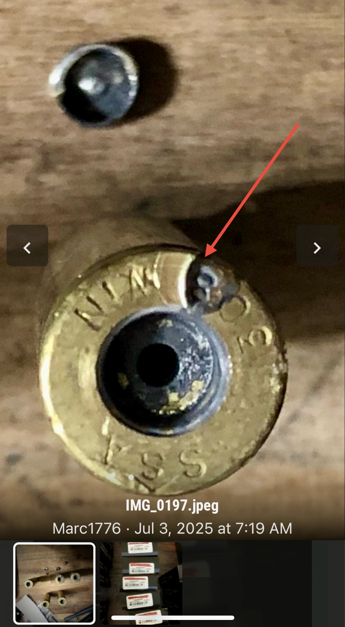

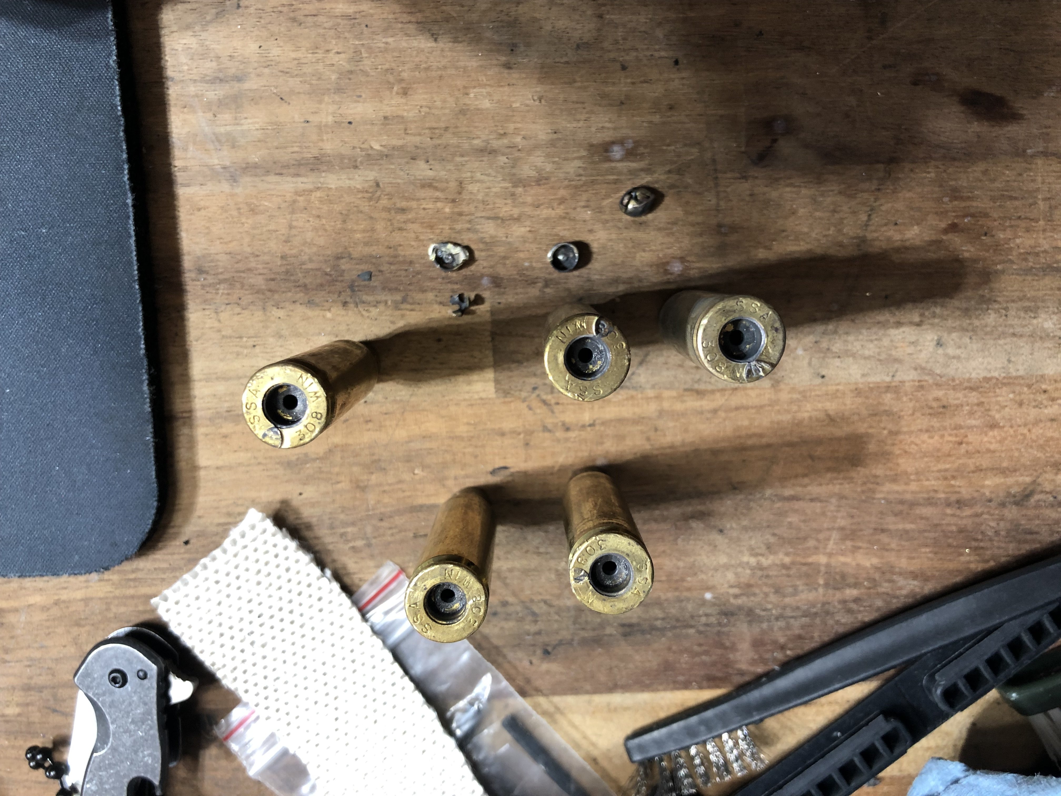

I bought 1000 rds of this ammo at the tail end of Covid (because who knew what was coming), and selectively shot it in a Ruger RPR and Christensen MPR, and had several primers blow out and get stuck in the bolt face. Not a huge problem in a bolt gun. But then I shot this ammo through my Ruger SFAR and also Ruger SR-762, and this is when I realized this ammo is truly defective and unacceptable. The primer blow-outs continued, and led to primers getting stuck between the BCG and upper, requiring me to use brass punches to hammer the BCG out and clear the problem. Upon deep cleaning, some pieces of primer had even made it into the firing pin opening, jamming the firing pin (this also happened with the Christensen).
I contacted Freedom and send pictures of several of the shells with blown out primers, and also of the 720 remaining rounds, and allowed for several days for some sort of action from Freedom, to replace the ammo, but no joy; hence this warning to others.
So the ammo was purchased 3 or 4 years ago?
Really?
How is that not a huge problem?
Ummmm. . . .
With all of the above HUGE issues exposed when you first started shooting this ammunition, is it reasonable to assume that you should have realized this immediately rather than months or years later?

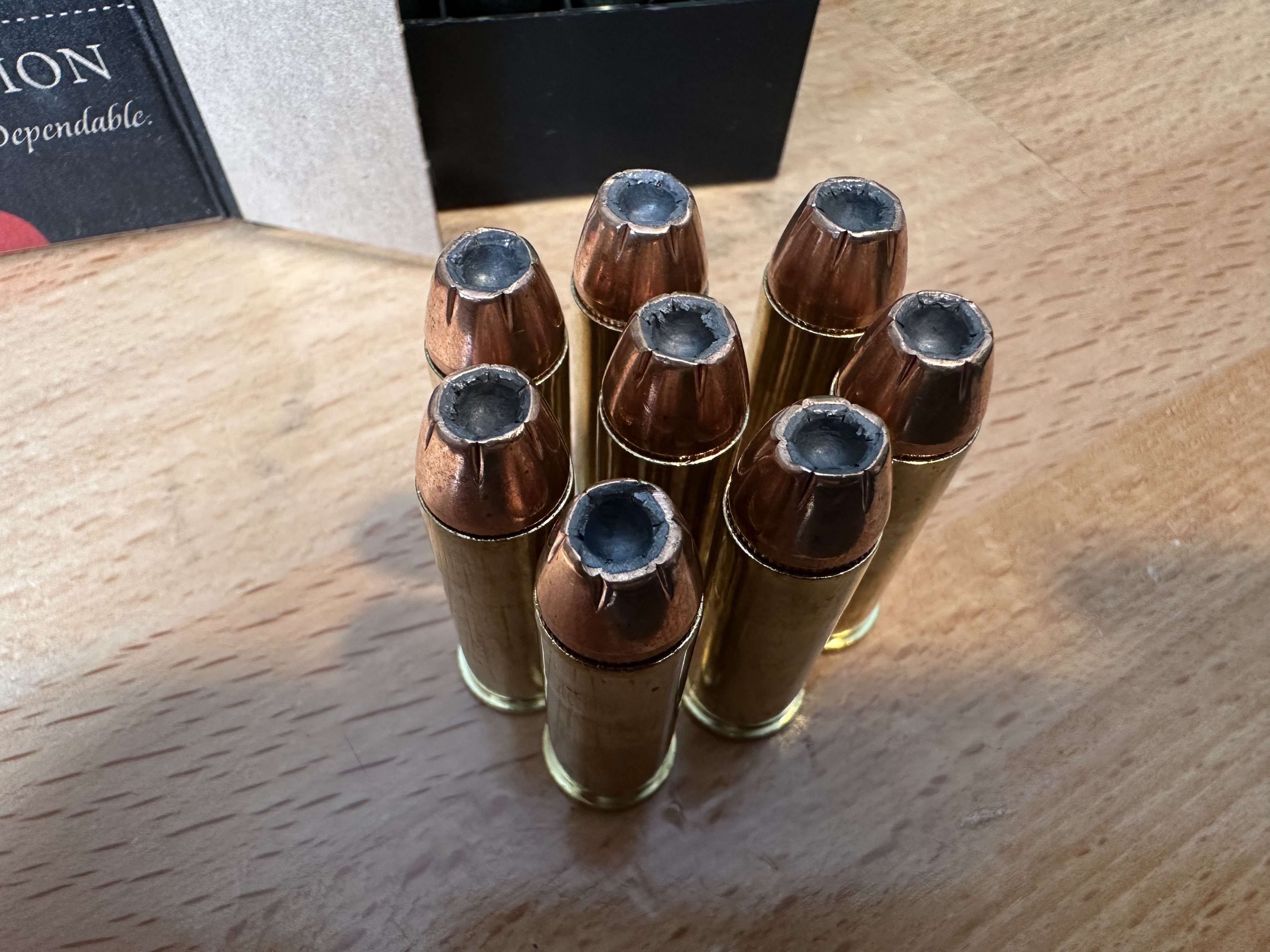

Just a couple months ago I received yet another defective batch of Hornady ammo where 75% of the bullets were fucked up from their seating process and they tried to give me the run around after first agreeing to replace it by stating that there was nothing wrong with the ammo and I was just being particular when the ammo shot 5-8MOA in a gun that shoots good lots sub MOA.
Hornady isn’t total garbage and they’ll make it right if you press them, but they absolutely are not the gold standard of ammunition and components or anywhere close to it. They could do a lot better.

Any time a primer exits a case without a decapping die, that is a bad sign for pressure. You know this, but continued shooting.
The only acceptable way to deal with this is stop shooting and pull down the rounds to reduce the charge. This is done with a bullet puller. Or get replacement ammo from Freedom.

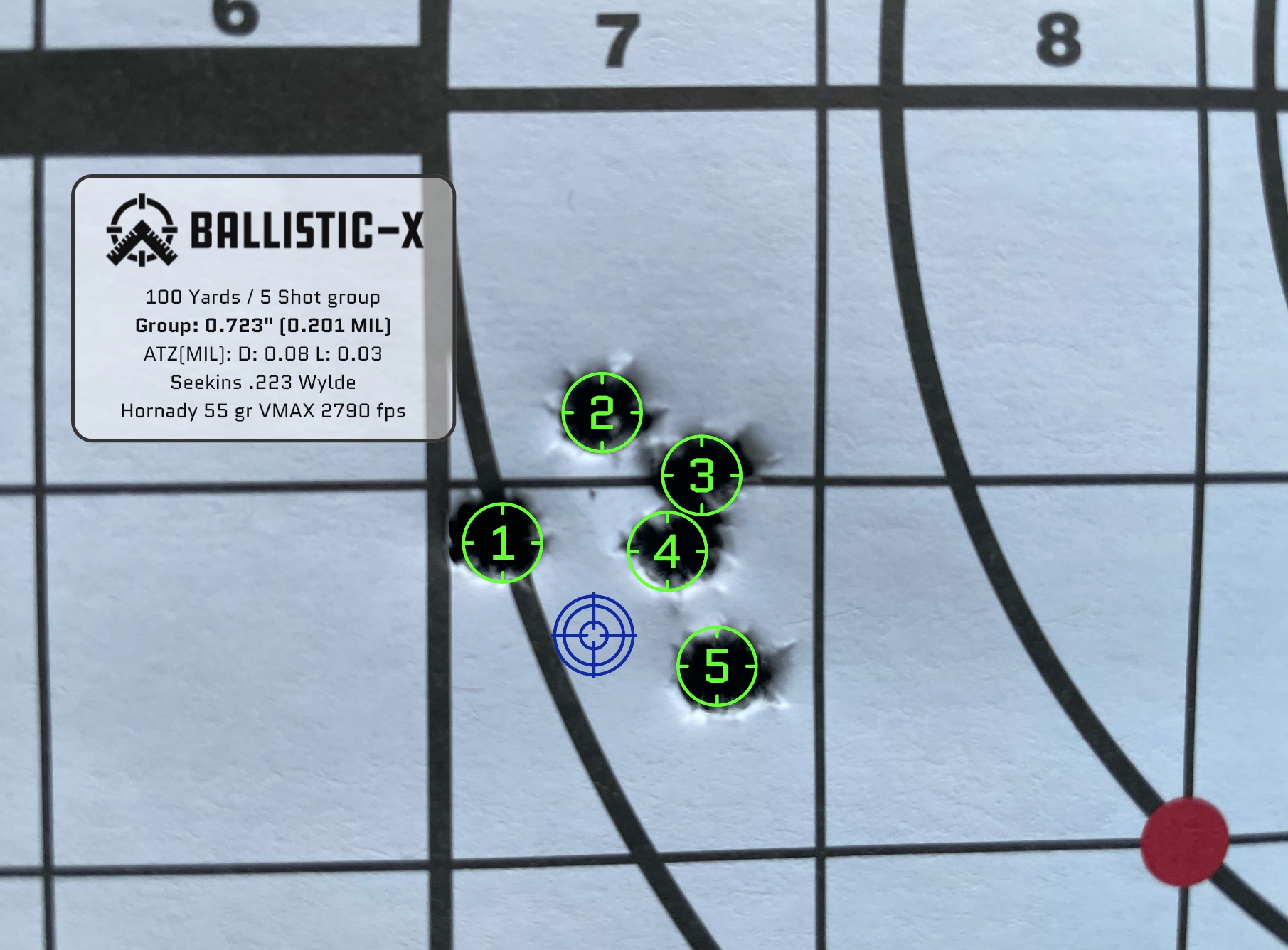

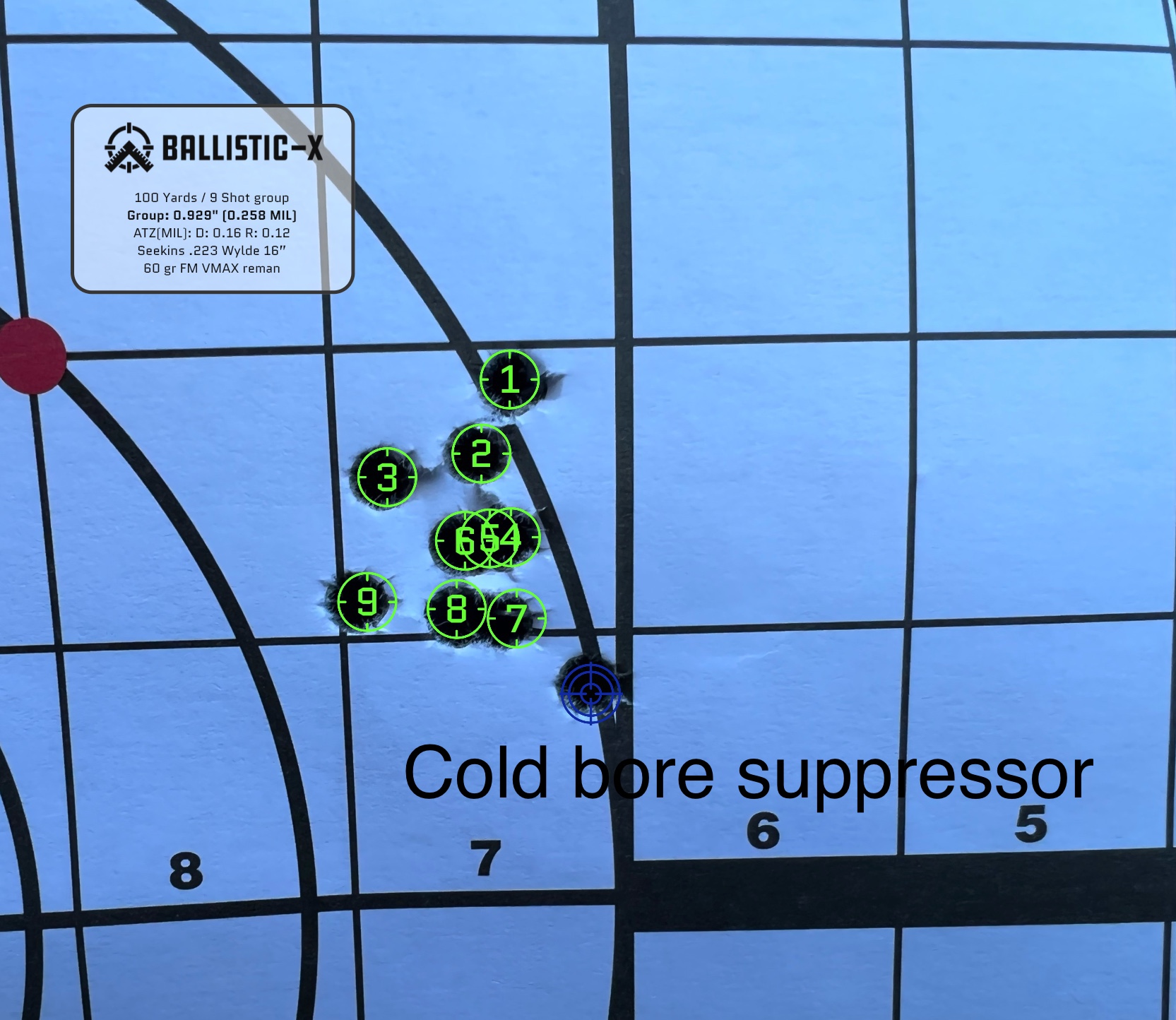

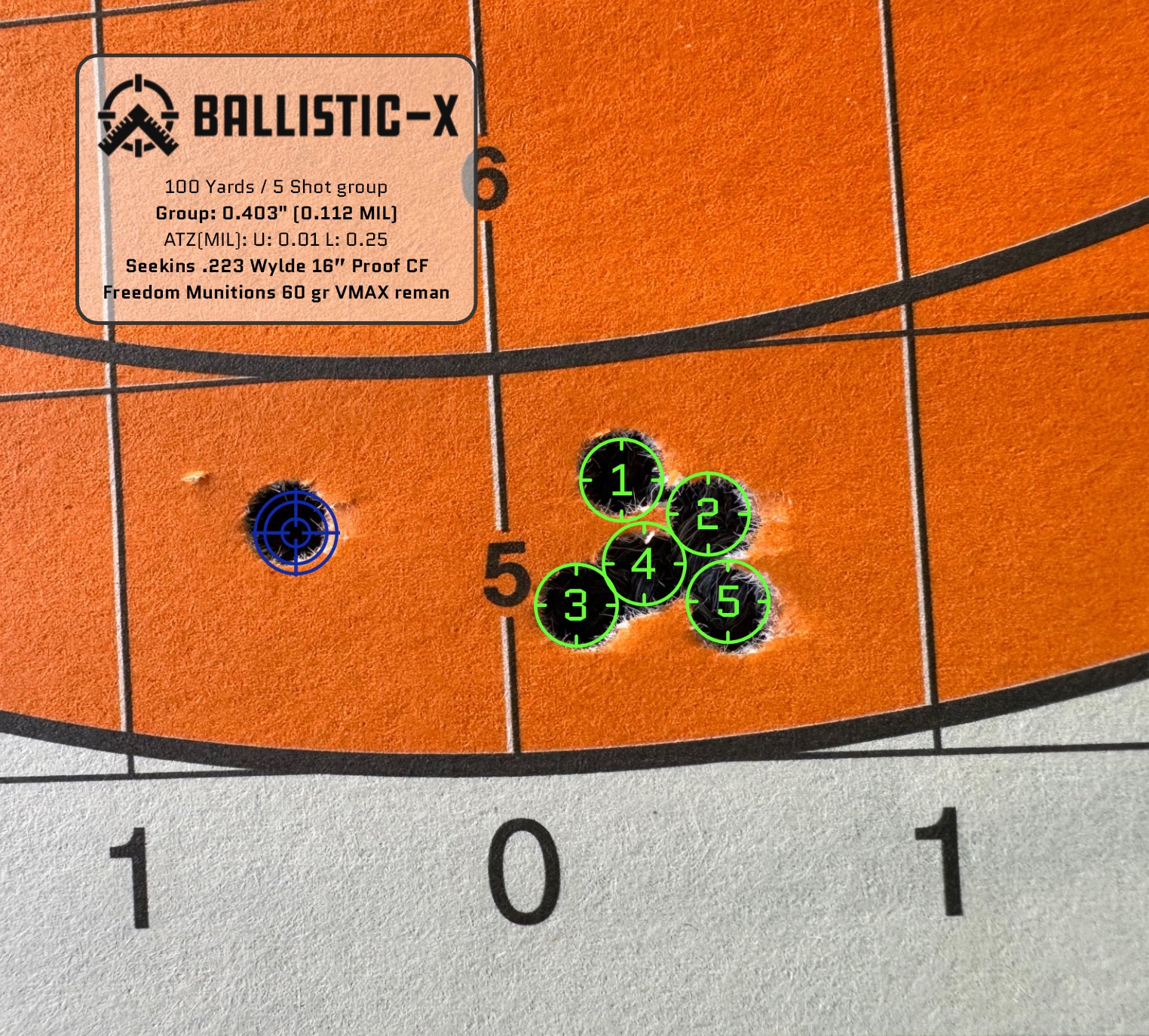

Surprisingly, here’s some older pre-LAX/Covid FM 55gr and 60gr VMAX ammo. Some new and some reman.
SD and ES previously were awful and hard to argue with $0.27/rd (reman) -$0.31 (new) and these results.
Seekins
.223 Wylde Proof CF 16” 1:8
Magnetospeed V3
Freedom Munitions 60 gr Hornady VMAX reman
2791, 2799, 2785, 2788, 2789 SD 5.1 0.5”
2747, 2749, 2785, 2771, 2749 SD 19 0.72”
Then it went to shit.
3/20/24 Garmin Xero, same gun
64F 32% 29.79in
Freedom Munitions 60 gr Hornady VMAX New (old stock)
2963, 2960, 2982, 2947, 2999, 2982, 2978, 2998, 3000, 2985 SD 17 ES 53.5 2”
2957, 2989, 2996, 2979, 3012, 3015, 3008, 3008 SD 17 ES 58
2971, 3001, 2972, 2963, 2964, 2945, 2973, 2965, 2996, 3001 SD 17.4 ES 56
2024 purchase
60gr VMAX New
2819, 2702, 2743, 2796, 2753 SD 41 ES 117
2024 purchase, 60gr VMAX Reman
2802, 2838, 2803, 2717 SD 45 ES 122

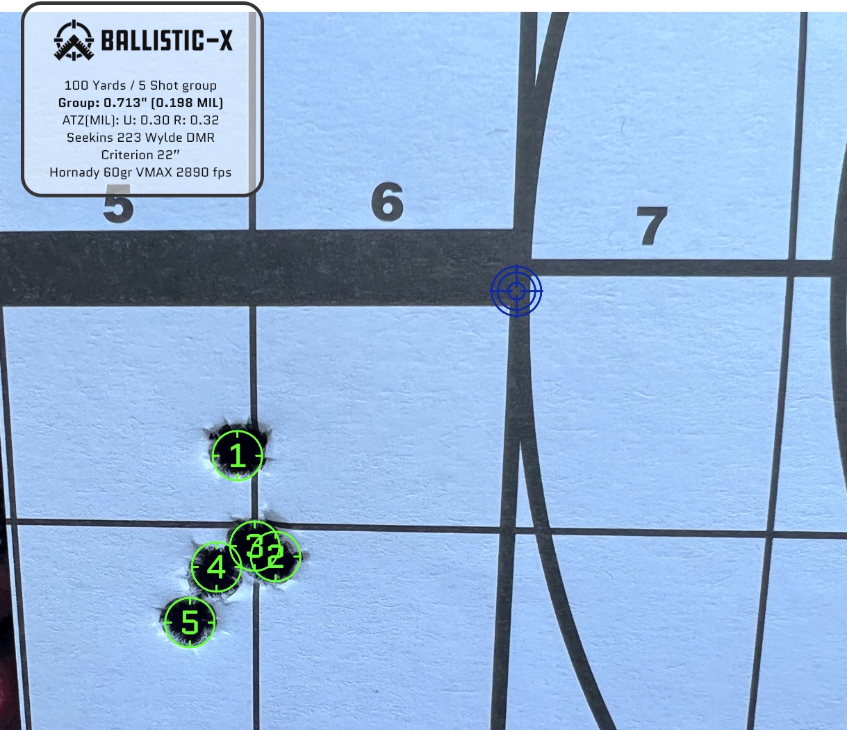

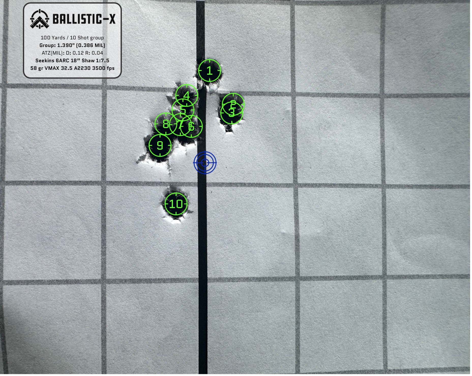

Pics of Pre- LAX/Covid
Ballistic-X-Export-2021-09-18 19:07:14.214782.jpg
Ballistic-X-Export-2021-11-17 19:31:08.308746.jpg
Ballistic-X-Export-2022-01-14 15:00:08.263015.jpeg
Ballistic-X-Export-2023-07-27 18:07:57.817547.jpg
Ballistic-X-Export-2023-11-16 15:06:19.461836.jpg

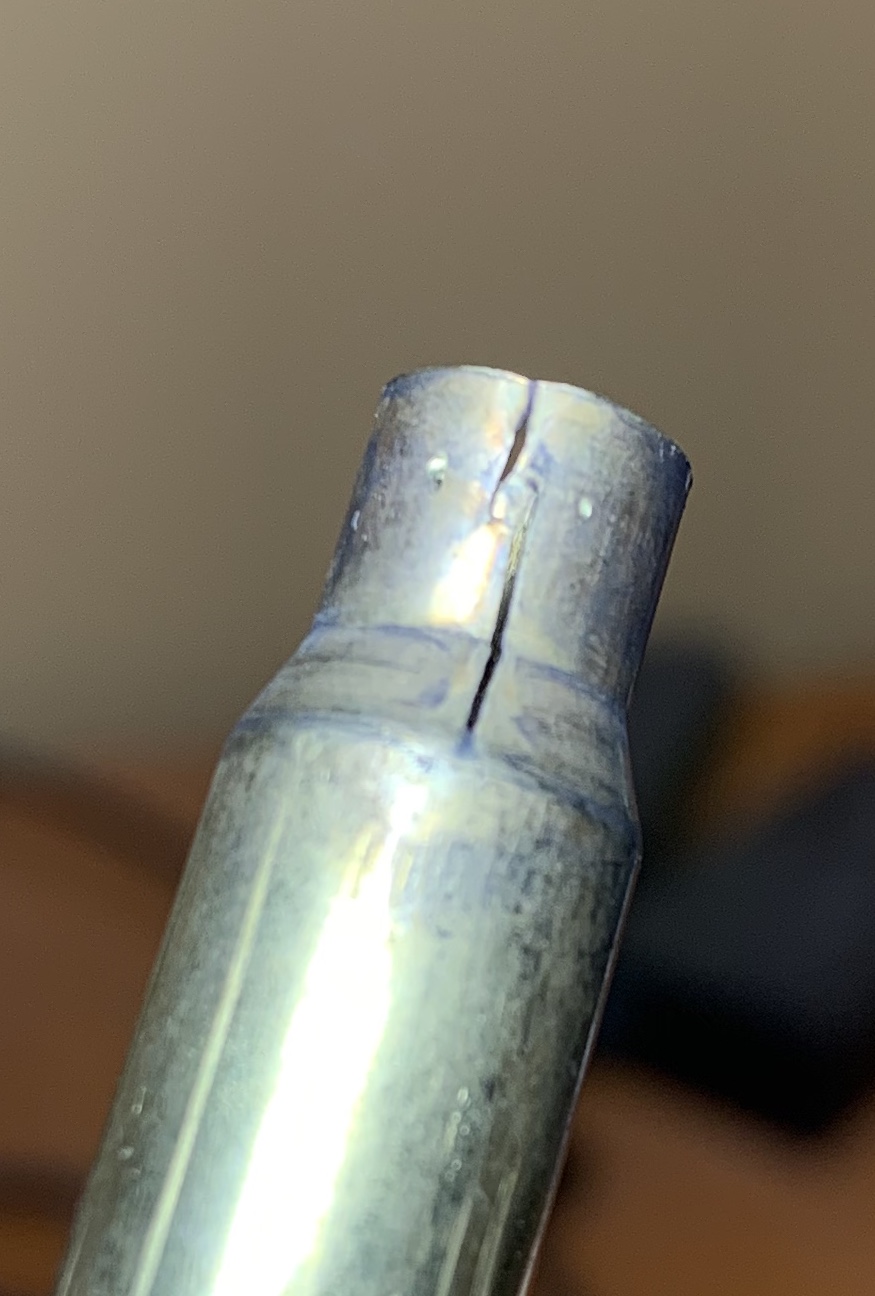

I had some Armscor .308 ammo, 168 gr HPBT. Some of those where having some kind of case expansion problem and I could not pull the bolt back. I would have a small pair of lineman pliers with me and use the rubber insulated handle to tap the bolt handle to get it freed.
Here is how I fixed that problem. I went to a 165 gr that was similar from Federal. That shot fine with no hang-ups in cycling.

Did you see the ejector craters…like as in craters…in his pic?
I don’t think this is just loose pockets and the OP shot 280 rounds of this shit. I’m thinking he’s not a fast learner.
