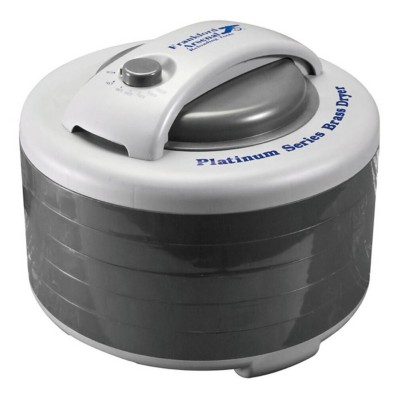

Use a dehydrator to dry brass. Pins should not be a problem. Use a Lite FA. Quality kit. Use large 2 tablespoon of Armourall HD car wash and similar of Citric [ from the cooking isle]. Pins should not stick in cases. 2C. 3 hours washing they come out sparkling.

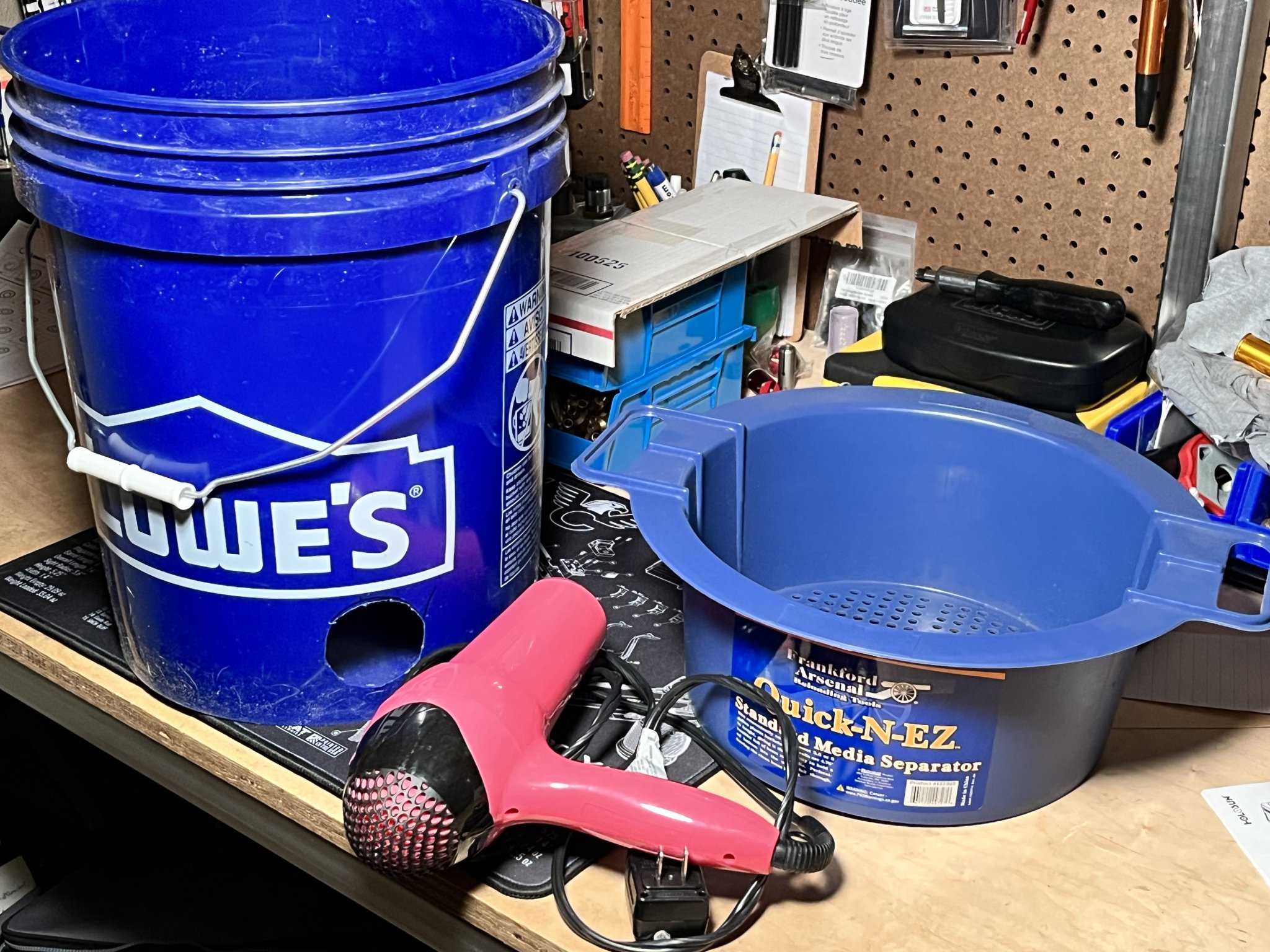

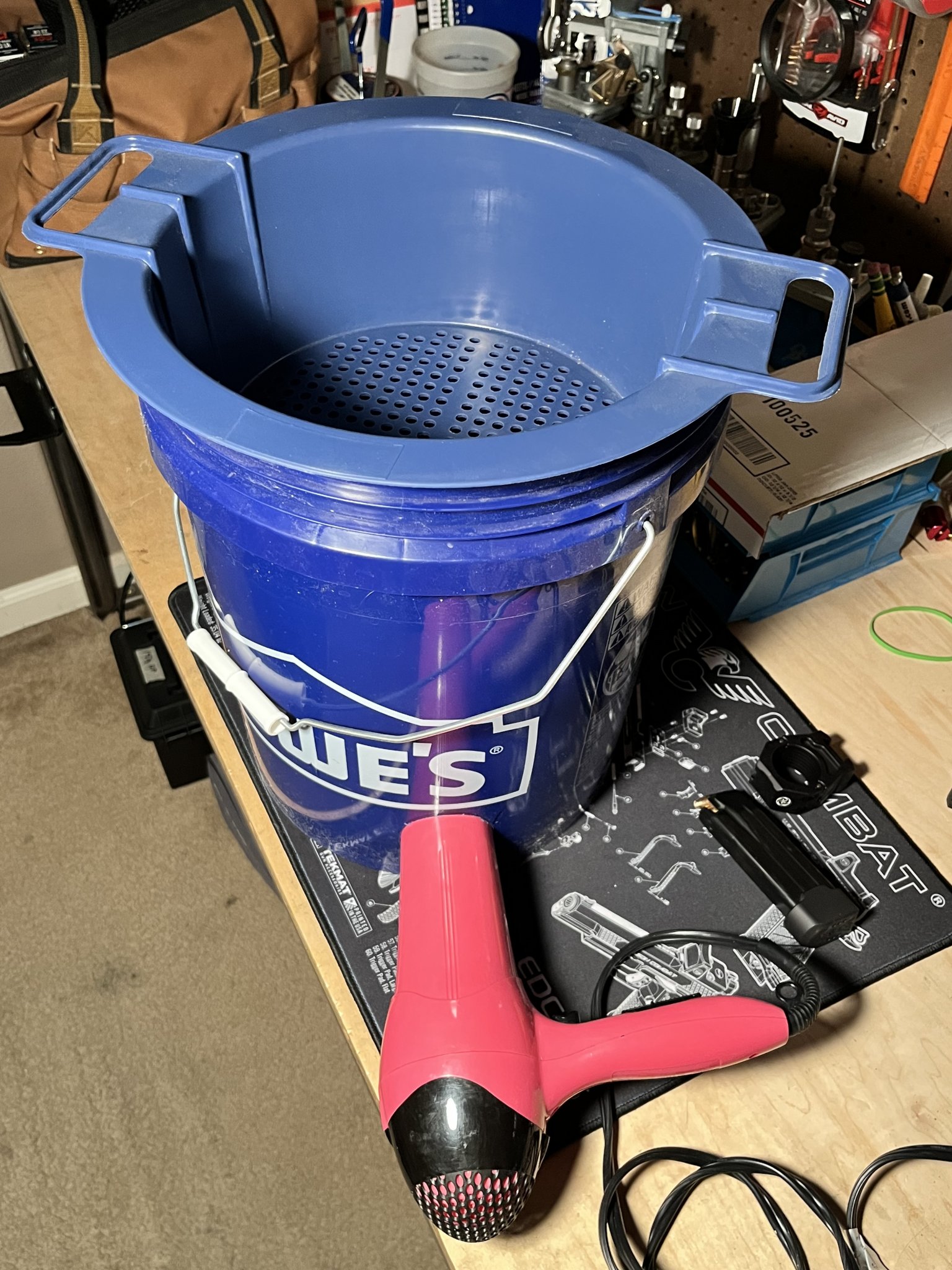

Home made brass dryer....
These five things for about $150 will make the process must easier. Spend that extra time on good case prep not picking pins out of cases.
