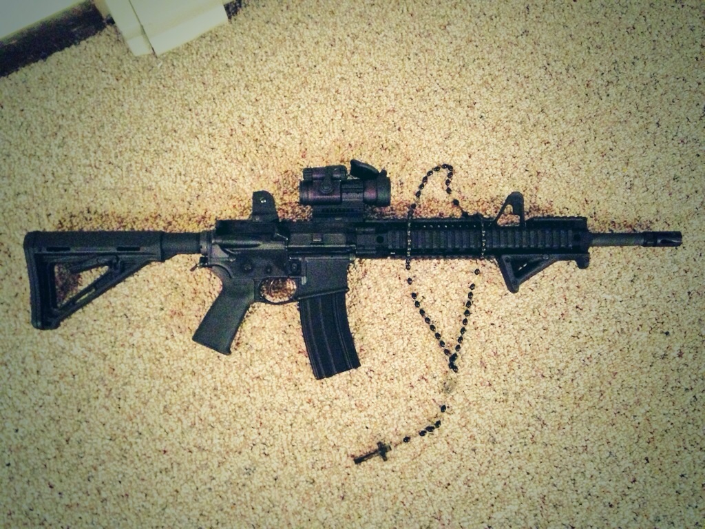

Hey guys,
I'm on a search for a weapon light for my .556 ddm4v1. It'll be used for 80% home defense and 20% critter killin and night shoots. Through my searches it seems as if the surefire 300ultra is the ticket for this rifle as I can mount it in front of the fsp, which will allow for easy switch manipulation with the way I grip the foreend using the afg. So my questions to you fellas are;
1. What would you guys deem the "effective range" to be on the 300u? (Let's say I'm shooting a full size IPSC.
2. What other options should I consider that aren't too ridiculously expensive?
3. Is the 12 o'clock position in front of the fsp my best mounting option?
4. Should/do I need to utilize a pressure switch? I'm leaning towards no as of now...So please talk me into one.
Any input is greatly appreciated.
Rifle pictured is the rifle the light will be going on.

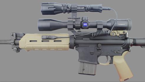

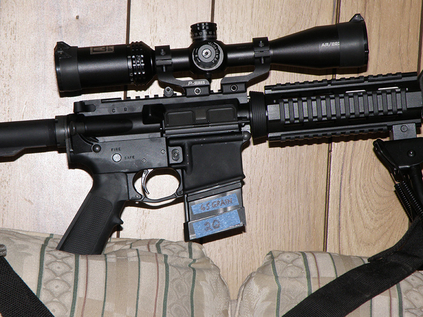

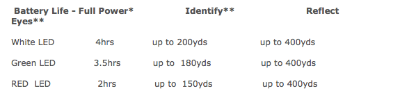

If you are planning on hunting at night I do not see where you can get red or green lights that the varmints can't see on any of the lights mentioned above except the Wicked Light. The wicked Light is the only one that I see that comes with a quick detach mount. It can be mounted on any Picatinny rail also not just on top of your scope. The distance of the red at full power is out to 200 yds. The green has a longer range, but if it is cold out it doesn't work as well as the red. The white has the longest distance, but the varmints shy away from it. I changed my scope rings to Nikons so the Wicked Light will mount on top of my scope or on my Picatinny rail. Other hunters say that mounting it on top of the scope eliminates reflected light that comes back into your scope.
PS: I have read that all the different manufactures have problems with the on-off push buttons and suggest that you use the stick on tape switch exclusively.
