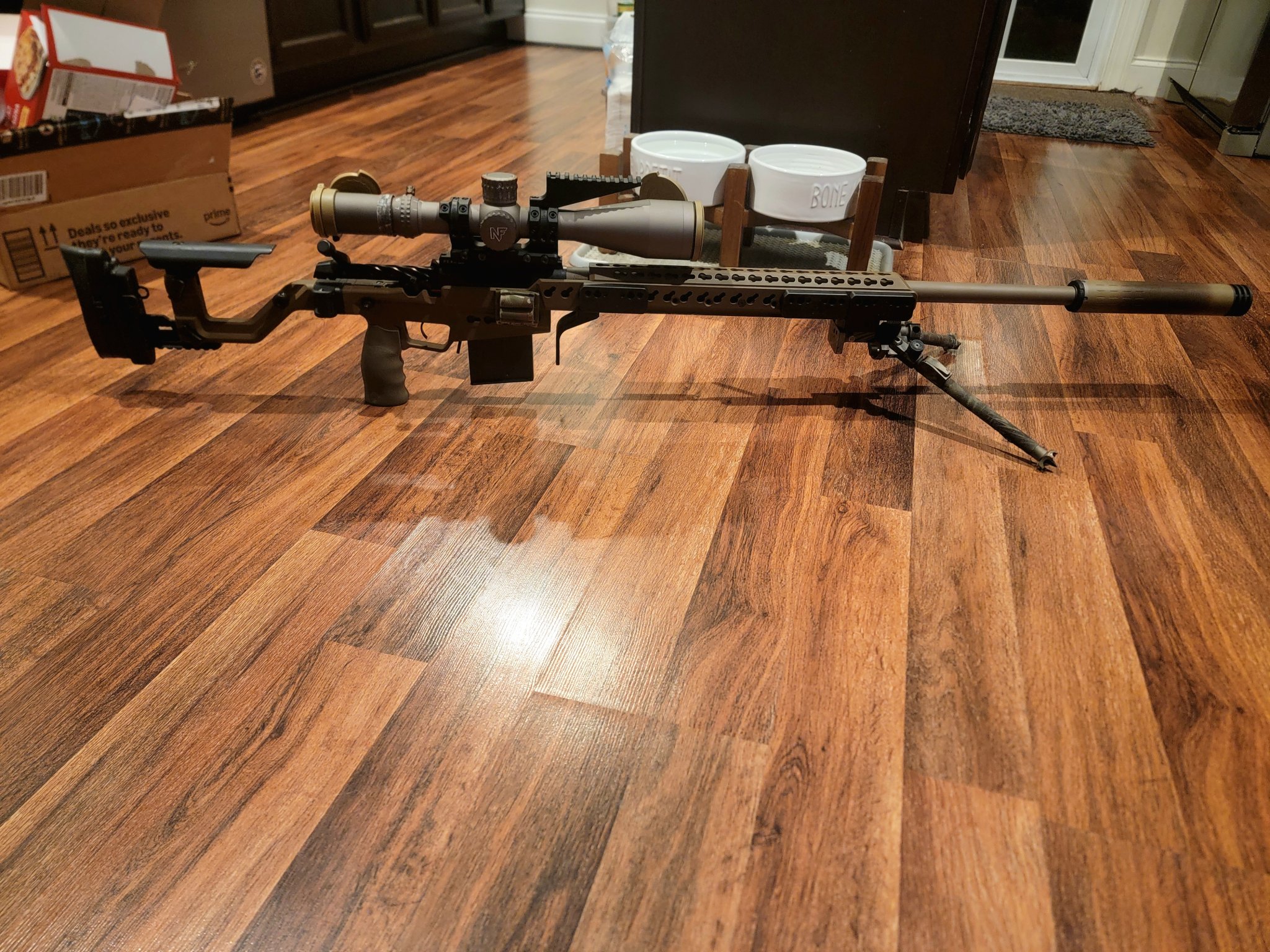

Since there is little to no information out on the new Weatherby 307 Builders Action I'll start with some content.
I won this 307 Builders Action from the Prize table at the Night Force ELR Steel Challenge in Wyoming with a Peak 44 20MOA rail
Trigger Tech Daimond set to 1lbs
MDT Gen 2 ACC Chassis, Ckyepods, Sent It Level, and Various other accessories: Spare Rounds, External Weights, Bag Rider, Adj Shoulder Peice, and MLOK Gas Pedal
NF ATACR 7-35 W/TReMoR-3
Spuhr SP-4002C Mount + Diving Board
Bartlein M24 Profile 1:8 26" 6.5cm Barrel
Thunder Beast Brake
Silencerco Hybrid w/30 Cal Brake + Bravo Adapter
Grey Ops Weights / Shorty Bag Stopper
Ergo 90* Grip
Currently eating Hornady 140gr ELDMs pushing 2798fps

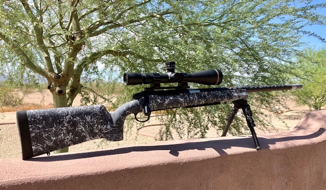

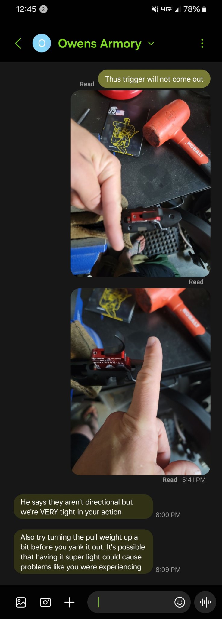

I decided, as admittedly I could not get my trigger out last night (Broke two 1/16th punches, tried a center punch...nothing) that I am going to crank up the lbs to 2lbs and see if it will change anything before taking it up to my local precision shop. With feeding a spent cartridge into the chamber to mimmick case engagement, I am unable to get it to give me the same poor results as before (Which is good news I guess, just sucks that I'm taking a 4oz-capable trigger and having to crank it up to 2lbs/32oz).

Have you tried cranking up the trigger pull to two lbs yet?
This is what Owens said:

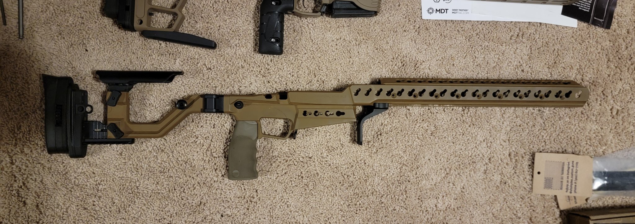

Got everything mated into an ATX-700 AICS! Slapped on 3x internal Weights and 6x External (Tips given from my connection with Pros from AI) and I've already sold the MDT chassis off. Already worth it! I did have to significantly shave the bridge internal screw receptors to clear my M24 profiled Bartlein (Worth it to be able to night shoot)
Surprising, I run hvy varm and comp contours in my atx chassis and there's no interference. 1.250 straight will not go with the bridge.
