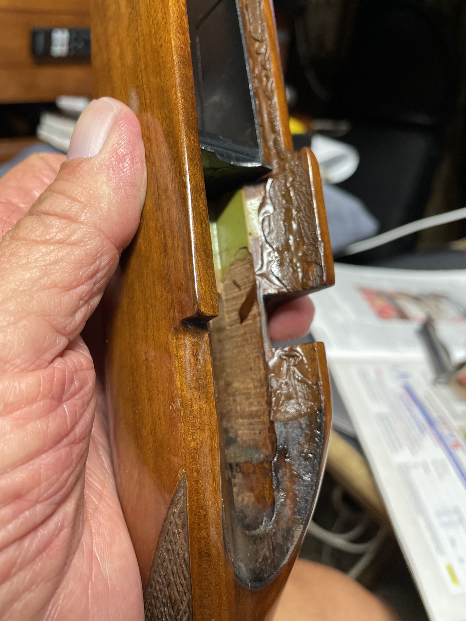

    Hopefully some one with MkV experience can a help. A friend brought over a rifle he bought at a Pawn shop with a bolt binding in the last 1.5" opening and closing. A casual inspection shows some scuffs on the left inside of the receiver, the gun is very dry. It sort of feels like when pushing the bolt forward it is out of alignment with the forward part of receiver. I have a couple of initial thoughts but not a Smith and know there is lots of knowledge here. Any suggestions?
    Edit: False alarm, an absolute nightmare of a home bedding job and over tightened rear action screw.
    My apologies for asking before I looked at it. I'm just not a Weatherby fan and know nothing about them..

    may have been caused by someones poor excuse for a bedding job.
