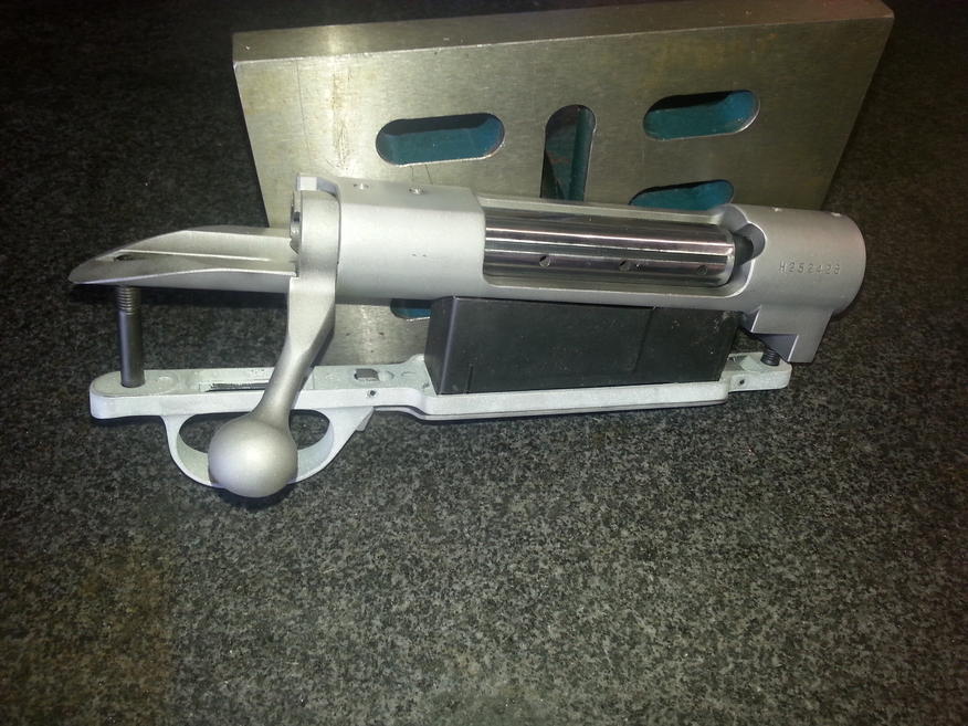

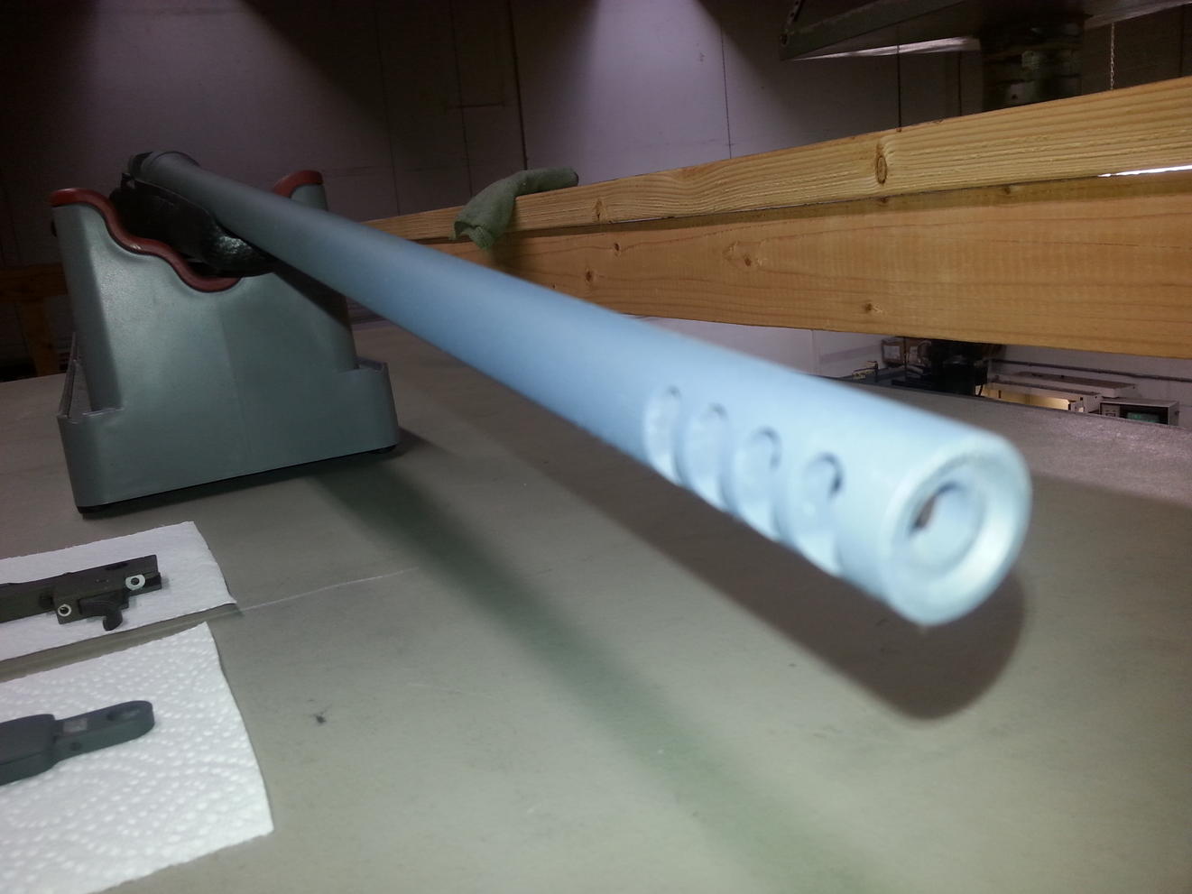

Just finishing up a personal build!

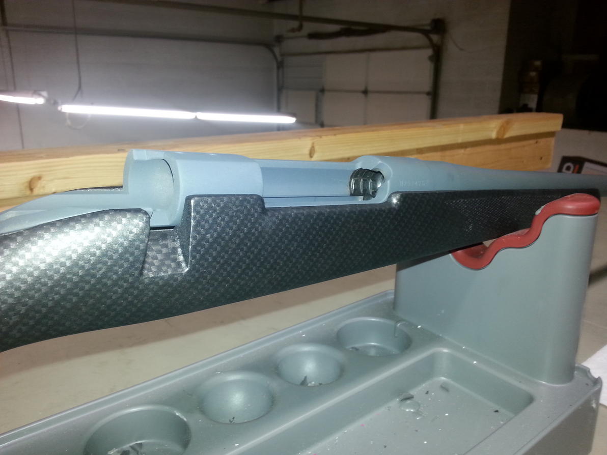

Weatherby Mark5 Action, bolt, trigger and bottom metal
Shilen #5 barrel s.s 1-9 twist @ 24"
Factory synthetic stock.
custom muzzle break

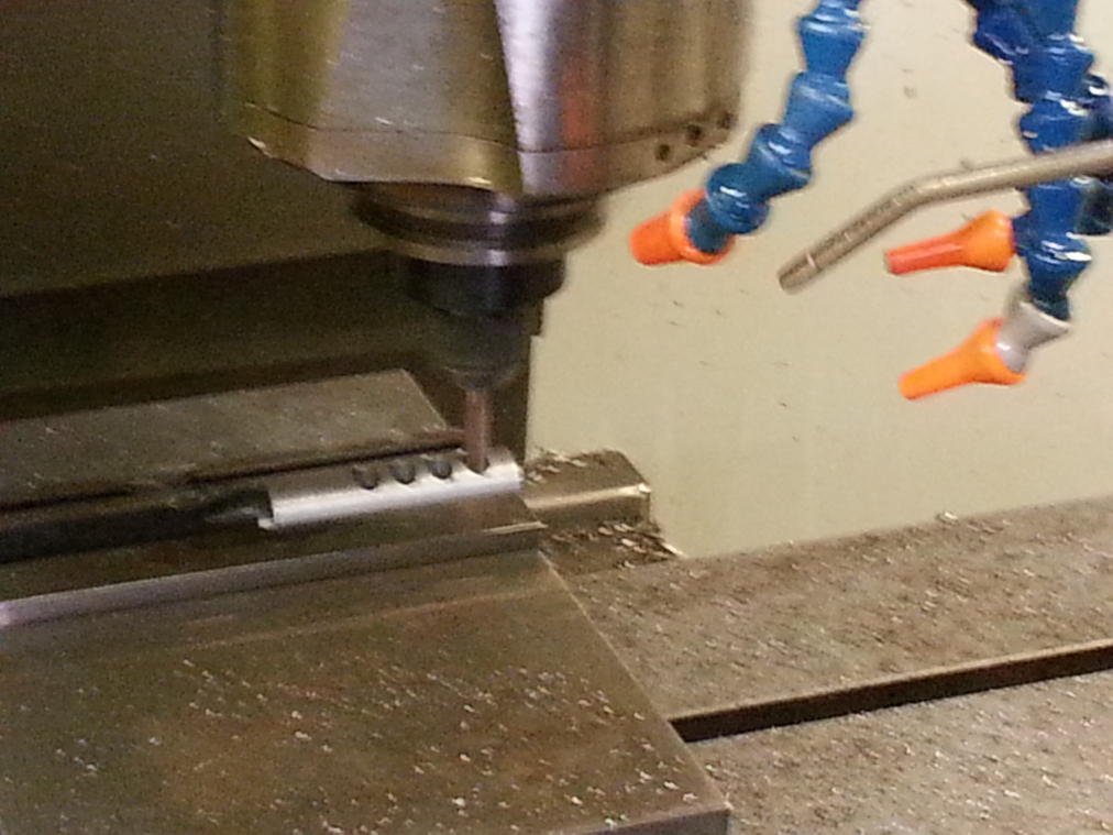

The action scope base holes have been opened to 8-40
After indicating in the action and testing perpendicularity on the face in relation to the race way I decided not to even re-surface it.
Lugs lapped for contact
feed ramp polished
bolt body polished

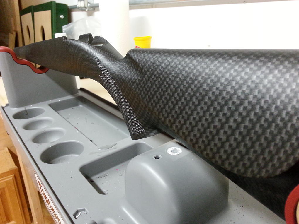

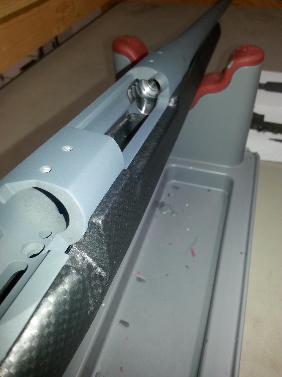

stock full length bedded, free floated and hydro dipped in carbon fiber print for a nice look
Barrel and action Dura coated in extreme tactical flat grey
bolt knob and shroud coated in tactical black

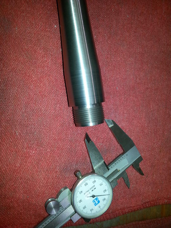

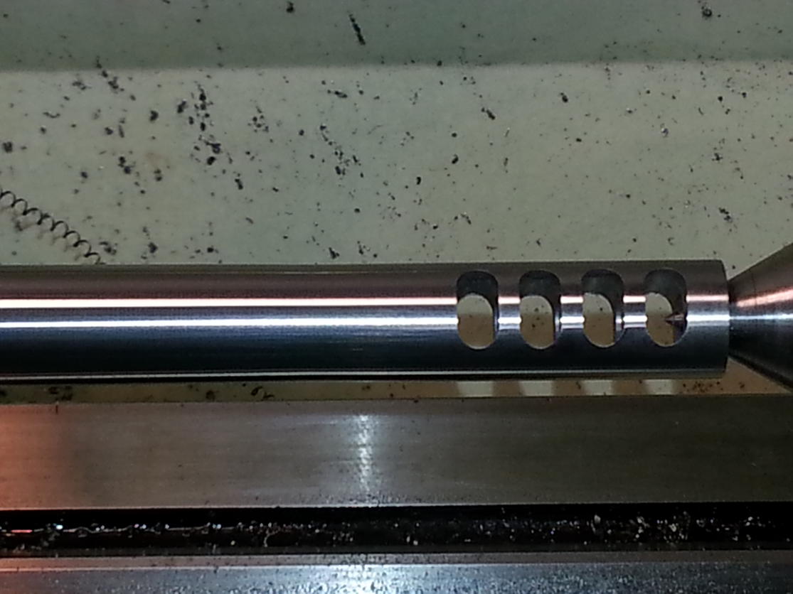

Barrel chambered, muzzle threaded, crowned and personal muzzle break made and installed
All in all a pretty sweet budget build that has a cool look and shoots very well.
