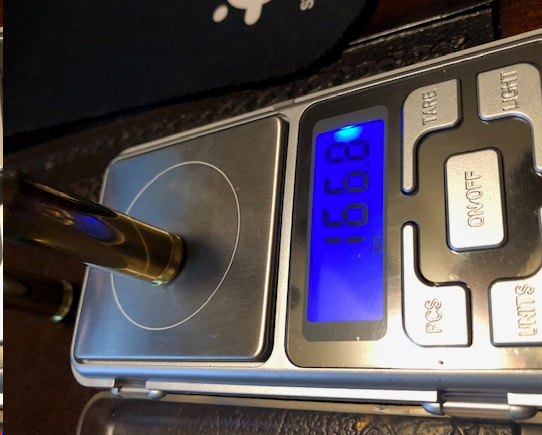

I recently bought a box of Lapua 308 brass that had a weight range of 173.2 to 176.5. This was a much larger range than I've seen with Lapua brass. I wrote to customer service and they said that they regulate the interior volume of the case and where weight variation occurs is when they cut the extractor groove. So it sounds like we should just shoot Lapua brass.
Like spife said, weighing the brass not the best method. Find the 173.2 case and the 176.5 and do the water capacity thing, it may answer your questions. If you are shooting 1K benchrest, you'll want to bring your 50 best cases to the match, for the rest of us, not so much.

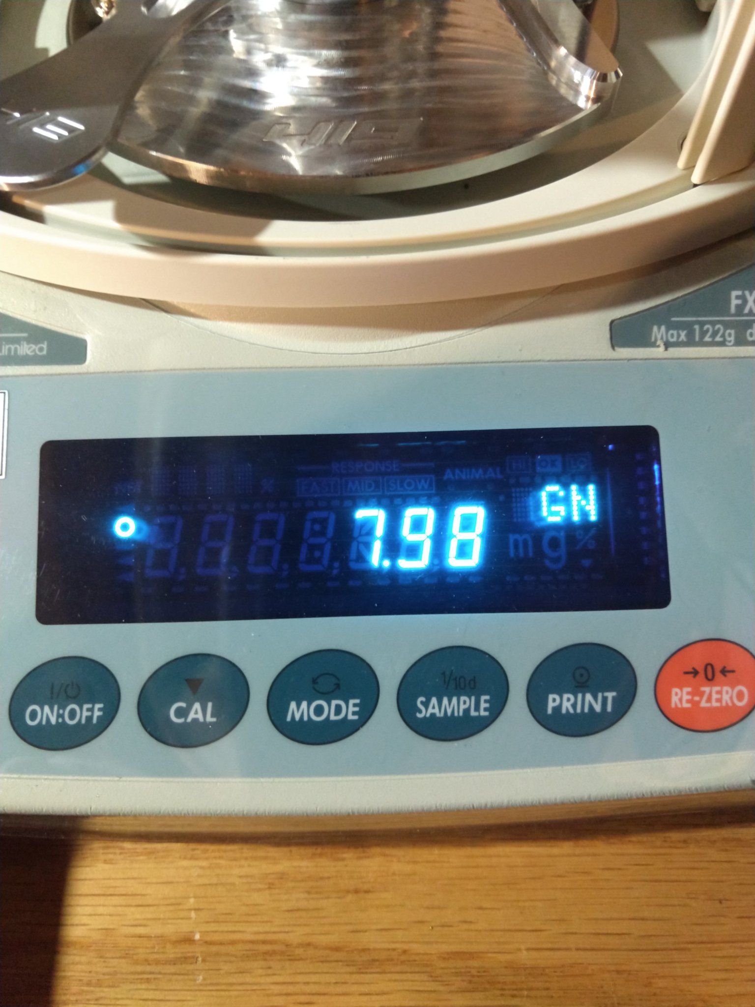

LC 308 brass ranges from 173 gr to 181 gr. Bullshit or not, I can't abide an 8 gr spread. I segregate into heavy and light with 177 gr being the median.

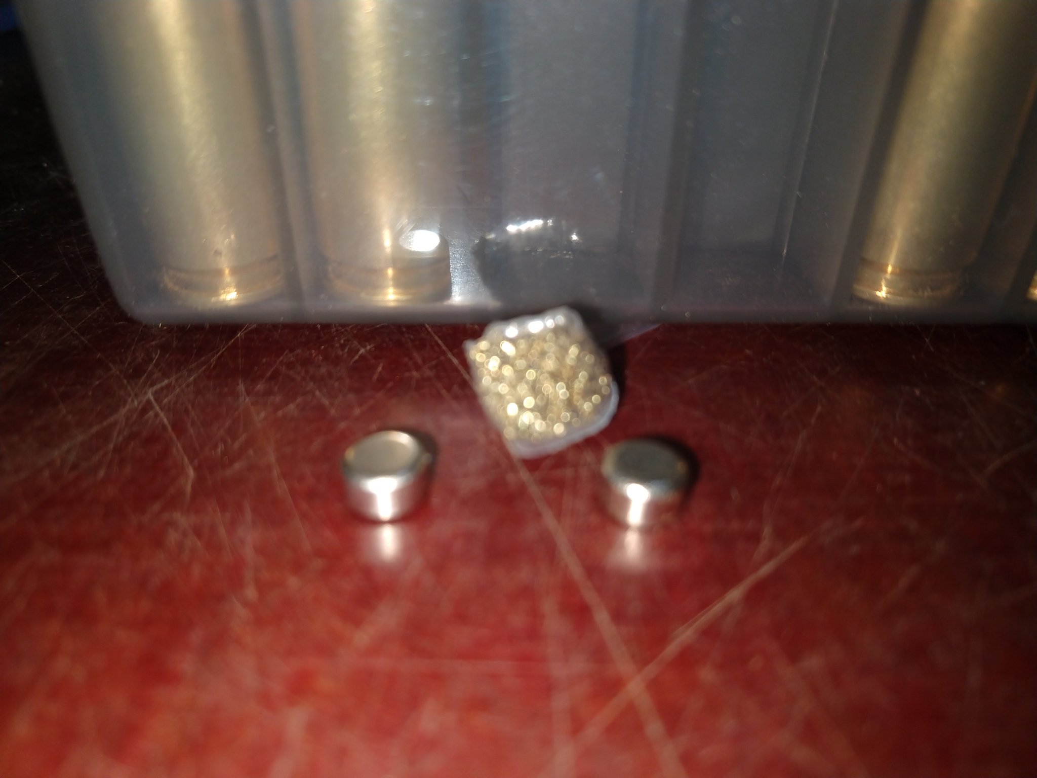

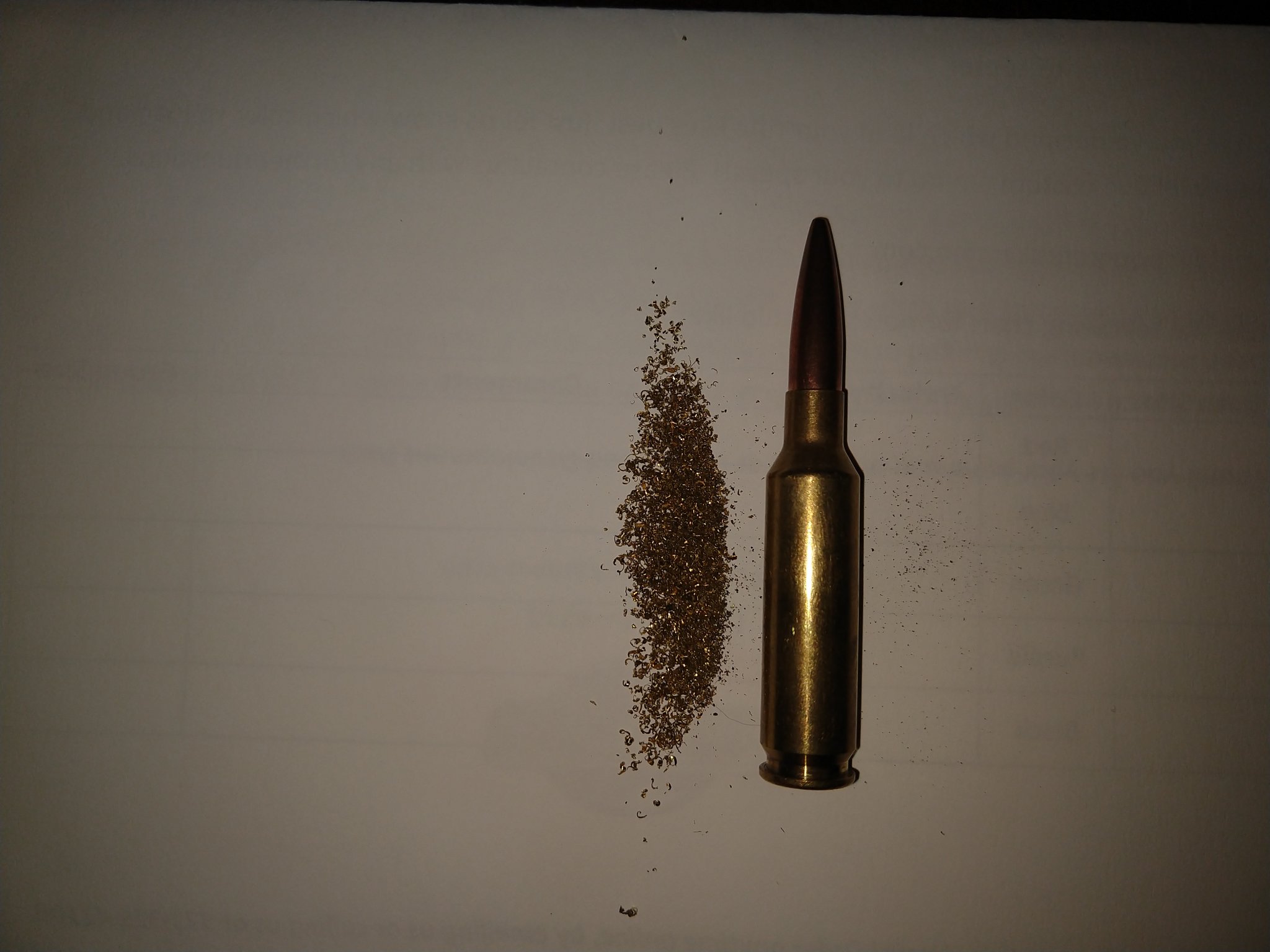

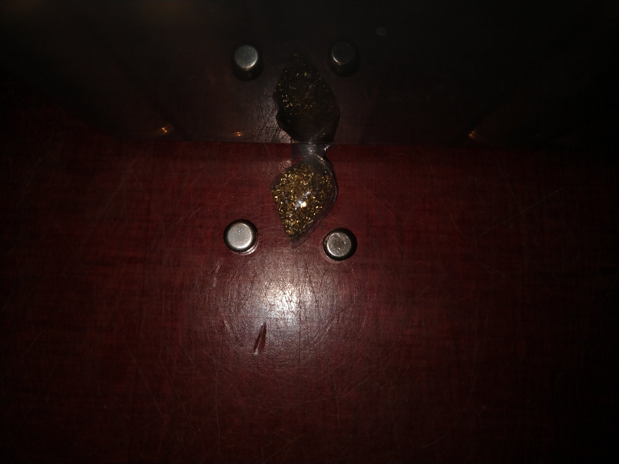

Here is what 8 grains of brass shavings looks like. Doesn't seem to me that it would take much solid brass to vary up or down 4 grains. The primers in the picture are large rifle. The cartridge is a 6.5 Creed.
Consider the extractor cut within the same lot of brass was made with the same cutter in one pass. Watch a video of brass being made.
In any event, plus or minus one grain on a 308 case does not mean anything in terms of ES/SD.
It can cause up to almost a grain of variance depending on the size of the part, which yes, on a 308 does not mean a ton, but that can account for fair portion of the total weight variance from part to part where the weights vary but headspace lengths and internal volumes can remain much more consistent.

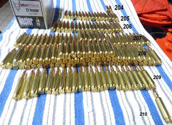

Here's some 22 Nosler brass sorted. Same lot. Actually complete cartridges. Projectiles? Powder charge? Primers? or
Case weight?
Litz says that weight isn't going to matter. I say the machine or operator screwed up on three of these.
Anyone want to shoot mistakes?
