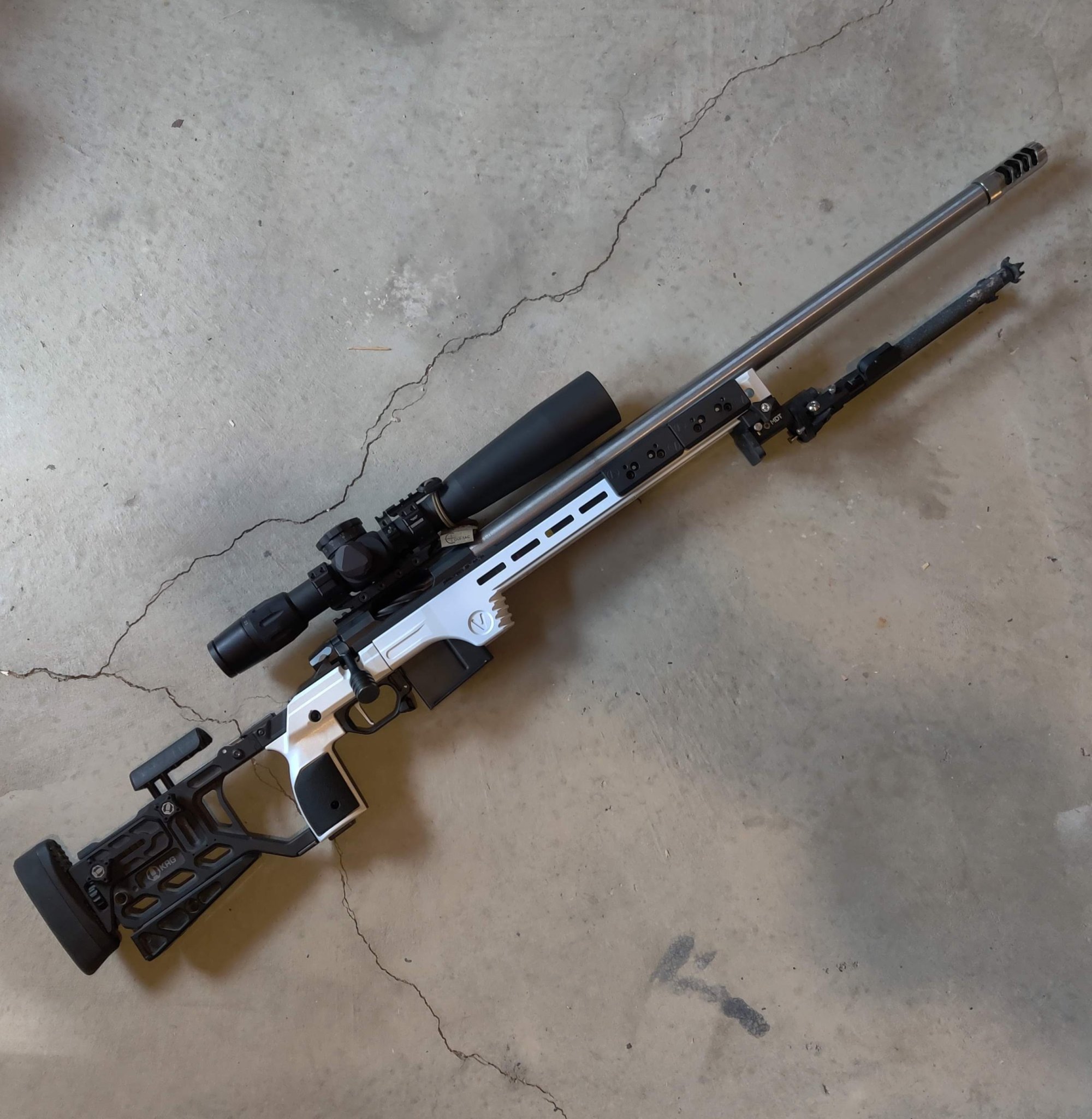

Vision released their M-Lok Forend, and now my gun is perfectly balanced on a game changer. I highly recommend getting a good forend from Vision, or Next Shot Precision. I've run both, and tend to prefer the Vision, because of the barricade stop:
Here's a pic of my gun:
As was said, with the KRG you won’t need the heavy bag rider or any weight out back… but you might want to spend some loot on their internal forearm T-slot weight, Heavy ARCA Rail, and maybe their Heavy ARCA Spacer too.
