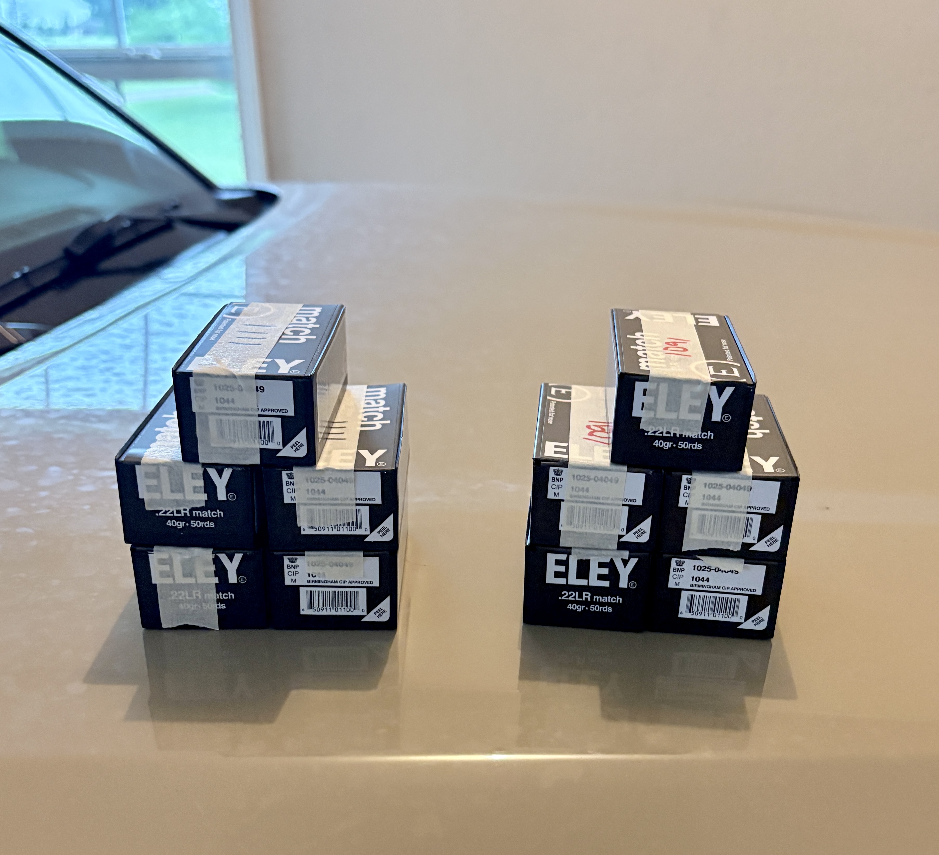

    Put a new CZ457 together with a Brux barrel and MDT chassis. Been going through different ammo to get a feel for what it liked. It seems to really like the Eley Match so I ordered 8 lots. All of them overall shot really good but found one lot that shot exceptionally well with a velocity range I liked with low SD’s.
    So I ordered 3000 of said lot and when it comes in I go to shooting it. Shoots really well but here’s the odd part. It’s actually two different lots. The lot I tested and part of the lot I ordered match up perfectly. Average velocity of 1091fps and SD 4-5. The second lot within this lot has an average velocity of 1111fps with an SD of 6. So far I’ve tested 18 boxes and they two lots are about 50/50. You can test a box and the whole box will be one or the other with SD’s being right at what I posted above. I’ve been in the competitive 22 for a long time and I’ve seen a lot of things but never anything like this. Not going to be that big of a deal but will have to go through every box and chrono and mark that box as one or the either. 🤷

    Yes but you would think that it would be all mixed in on the boxes not whole boxes with identical different lots. It’s almost like two different lots got mixed after they were boxed but before being labeled

    My testing was done on the same day and actually within two hours from start to finish with maybe a temp change of 5 degrees. Shot from inside my garage with the gun or the ammo never being in the sun. All shots recorded with a Garmin

    Whole boxes until I realized what was going on. Yes I’ve had Center X before that had a ES of 50. Each and every box I tested has had very good SD’s for 22 ammo. I’ve got 4 unopened bricks that i guarantee you you can open and randomly select 4 boxes and test them and the boxes will be one of those average velocities and out of the four selected there will be at least one if not two that’ll be the other velocity

    Yes I meant 50% on the different velocity and yes I tested 18 boxes but only shot 4 full boxes. Didn’t want to shoot them all up just to prove the point to myself. Shot 20 rds out a few boxes then just switched to picking a random five out of a box. Then marking each box accordingly. Sorry my Oklahoma red neck might not of stated it right.
    Pulled another brick this morning and did the five out of each box and separated the boxes accordingly.
    I truly think it’s two separate lots that some how got combined(whole boxes) before they were labeled. Either by accident or too finish out a pallet 🤷

    Also wouldn’t be a big deal at all if you could just throw them all in a bag and go. Be like any normal average lot. But the low spread of the 1091 vs the high spread of the 1111 is a ES of 49fps, hence the reason I’m separating them by box
