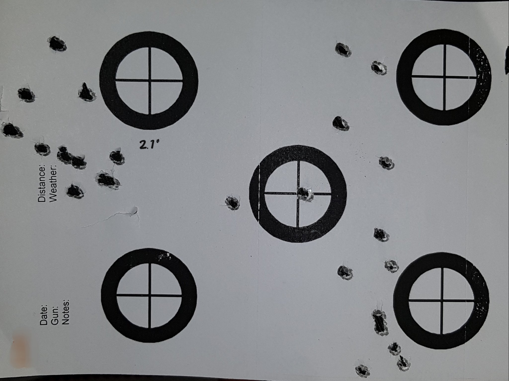

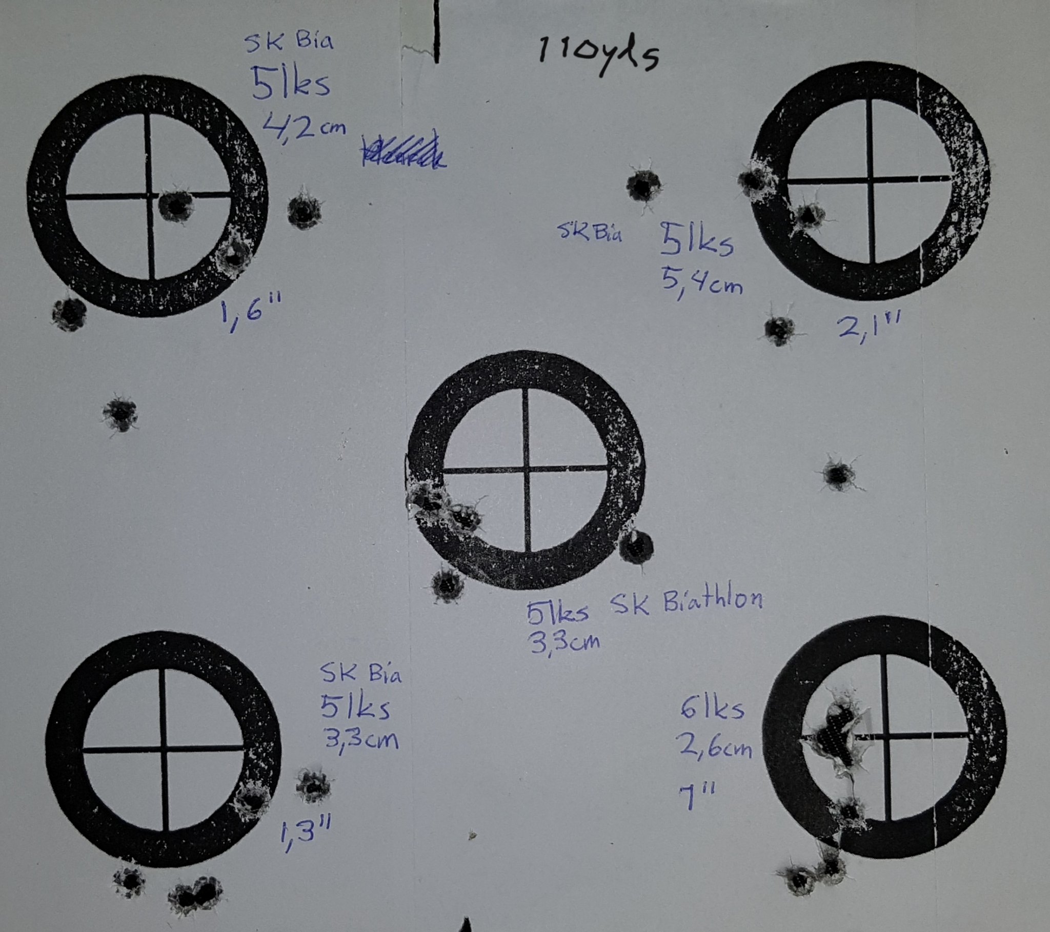

    Hello,
    I had some fun last Sunday shooting with the family. We spent 3 hours at the range and spent around 450 shots.
    But all of a sudden the gun did not shoot anymore. Groups all over the place. We packed up.
    Does anyone have a guess what could cause this?
    -Gun is Sako Quad .22LR
    -Range 110yds
    -Temp around 70s. Wind was gusty but we had one paper target fixed to move with the wind.
    Below are 2 targets, I think you can also see something went sideways.
    All I can think of is the barrel getting too warm, could this have this big effect? I ran a brushless Boresnake through it but it did nothing.
    1. Normal groups
    2. Weird groups
    7081203
    7081204
    The second paper was a little bit bent by the wind, a couple of degrees.
    Which is another thing got me wondering, even when the wind was mildly to the right, the shots started leaning in to left, high and low.

    I thought that the wind is playing with me but even the other fellas there could not get it right.
    I also shoot in to the wind as much as possible to learn it (after first observing it) and did not get results like that before that day. I was also shooting from a cover and judging the wind by the mirage and little vegetation nearby.
    The range is closed loop and usually wind enters behind me and seems to make circles inside the range.
    I doesn't take much of a swirl to ruin a target.
    The flags might not even show where it's at.
    But those target results let me know what's occurring.
    Think about the trajectory shifts as a bullet spits through a rolling vortex.
    How are you going to predict the result? :)

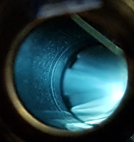

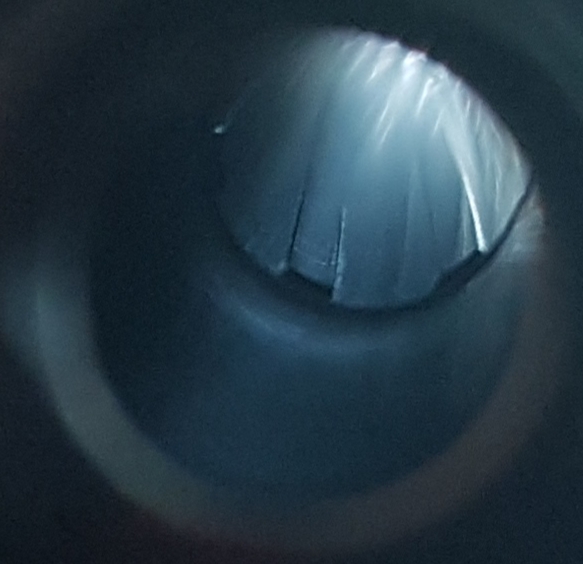

    I just took some photos of the chamber and I think I have a quite bad carbon ring there. I just realized it had around 800 or more through it during the weekend.
    @rizzle
    7081263
    7081264
    Please keep us posted on this. What you did to clean it and if cleaning remedied the accuracy issued
    Hahah remember you asked for it.

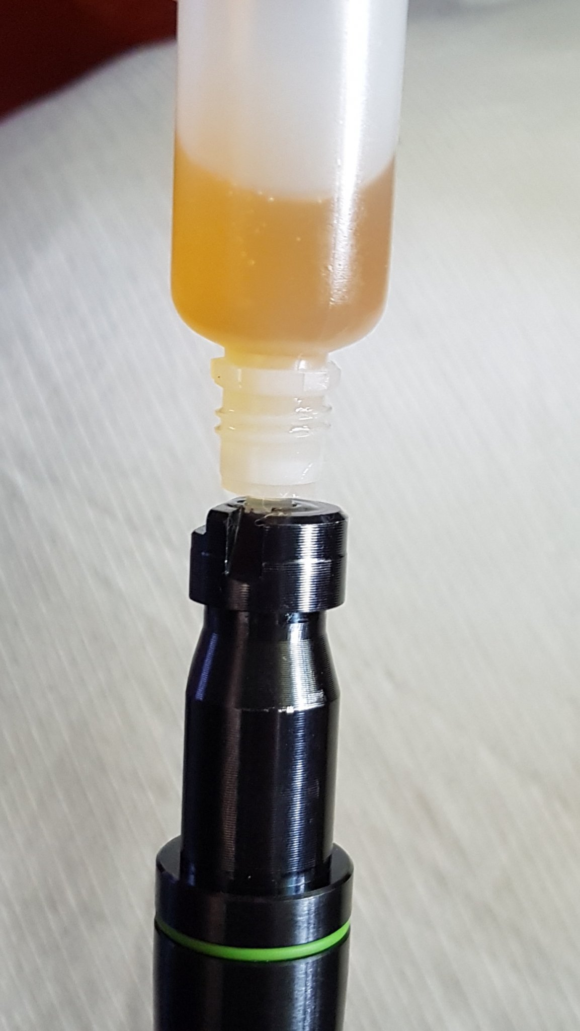

    I am tending it with few drops of motor oil and yes I'm of that school, I have noticed it has its time and place. I carry gun oil and Boretech Eliminator & Copper too in similar 10ml nosetip bottles, easy to dose.
    7081332
    After 20-50 minutes I swirled the chamber and reapplied.
    7081334

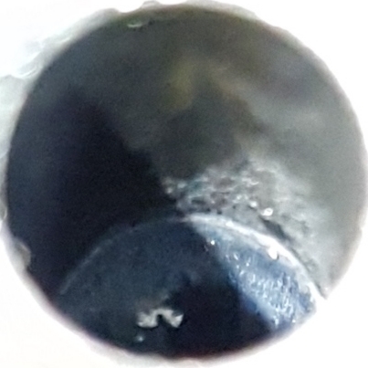

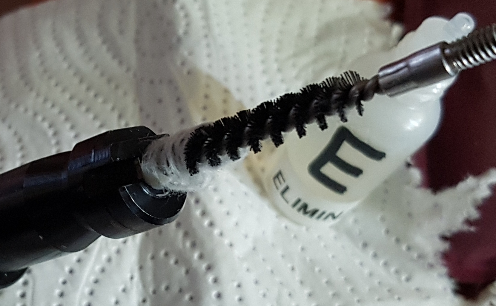

    After first run I swirled it with a copper brush, and applied oil with it. Did this for 3 hours, 3 or 4 runs all in all. My leg is busted so got nothing else to do anyways.
    Then I snaked the barrel and took some more photos.
    7081402
    7081401
    7081404

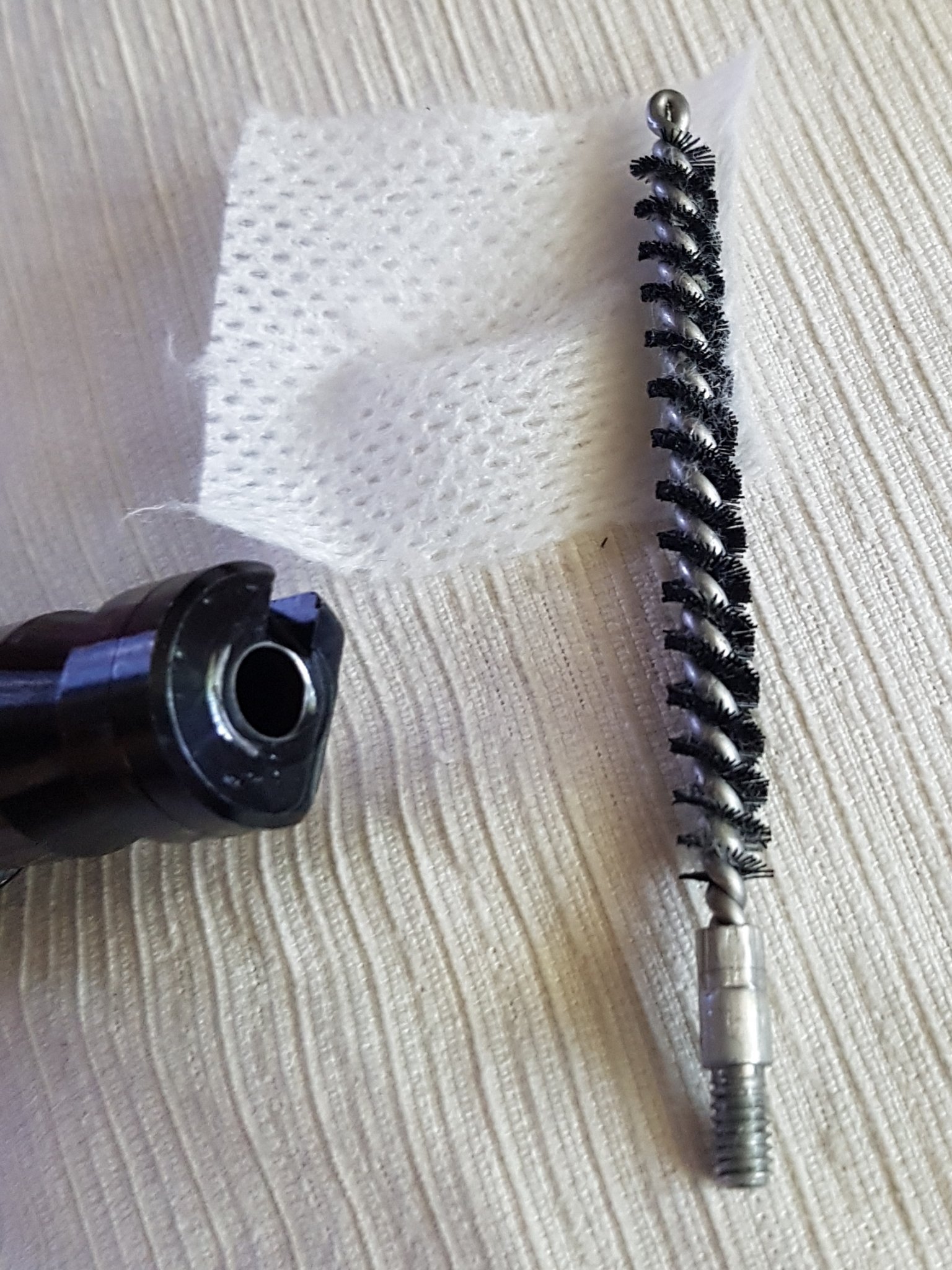

    There is still some left, not with bare eye tho. Probably could stop here and let it be. But I am going to see if I can take it all away.
    So I stick a nylon brush with cloth dosed with Terminator and see how well it will soak the rest of it.
    7081408
    After few minutes I pulled it and it had faint bluish/greenish tint from brush remains. Dosed little more and put it back. Swirled it. 20min all in all.

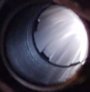

    Snaked it for photos.

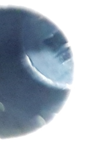

    And damn it.. Once I got a focused photo it was still there. Impossible to see it with naked eye, even with the barrel removed so most of you guys probably have it way worse than this. But for fun I will attempt to further clean it up to 100%.

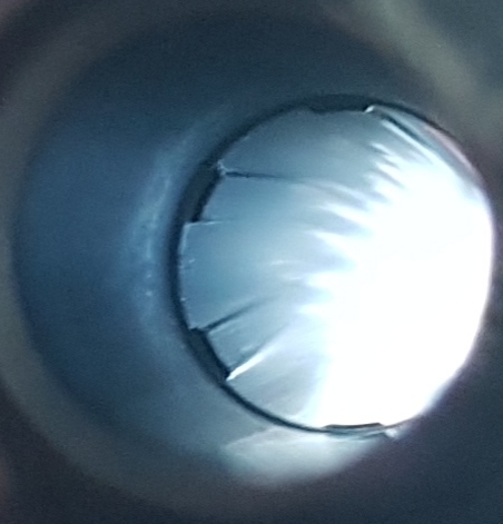

    So I swirled it back and gave Terminator another 20 minutes. Snaked for photos.. But nothing had changed. I put it back for more. This time I moved it back and forth in the chamber. Then let it rest for 1 hour and snaked. Tbh nothing had changed.
    7081456
    After full bore cleaning it looked like this. I checked with a flashlight and it seems the remaining ring is just minor barrel nitrate coating wear.
    7081477

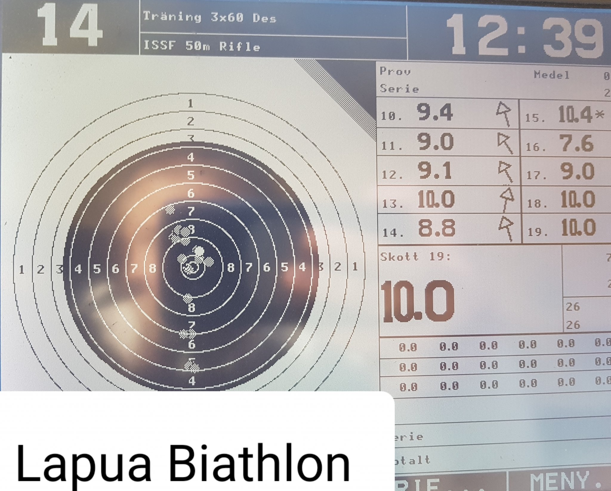

    I started with Lapua Polar Biathlon. Cold and 100% clean barrel. I think I held 2 or 3 different holdups. CB hit maybe really hit 0,5mil high. Would have been a great group.
    7084316

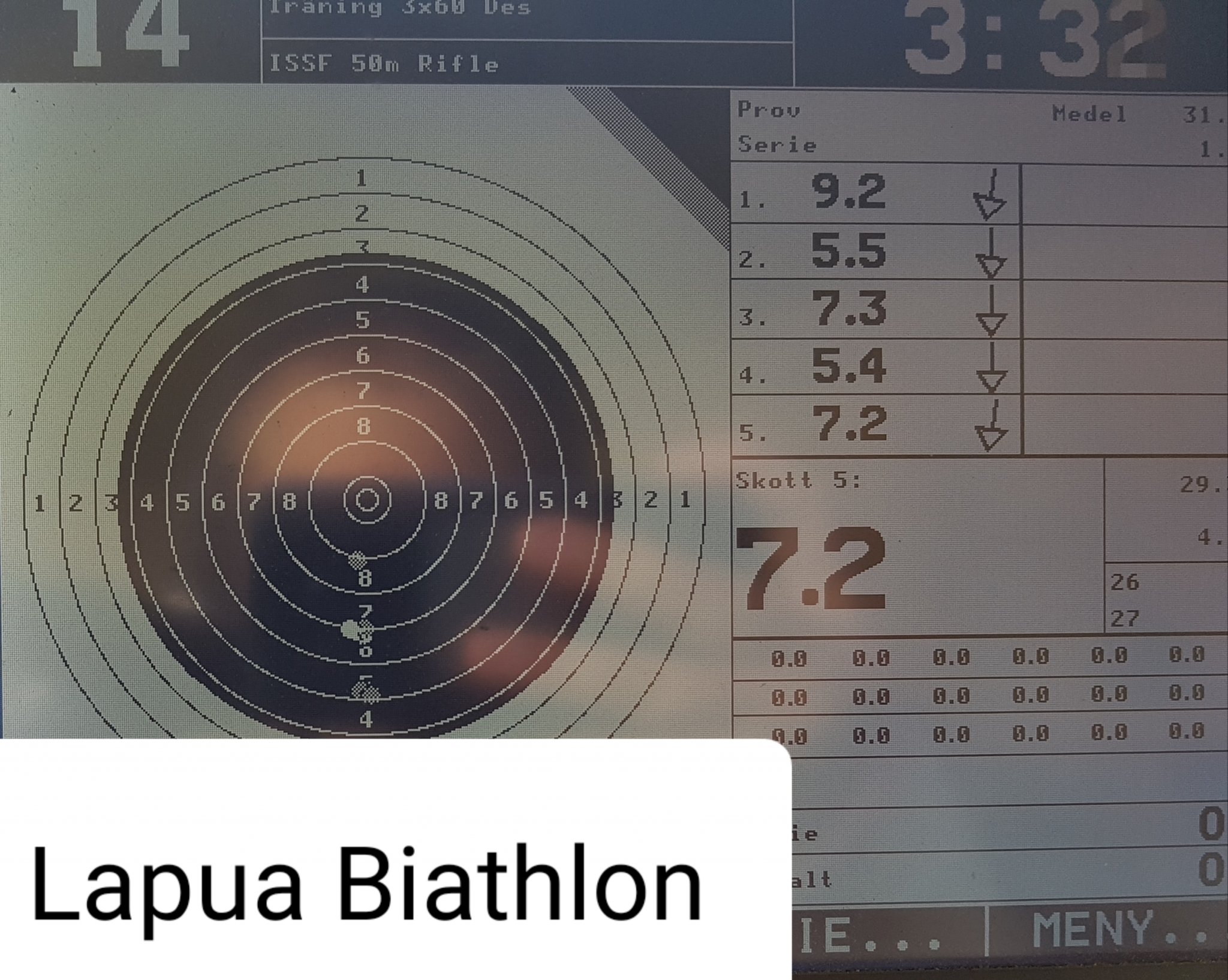

    Then I lost it and I started getting off-group at 11 o'clock.
    7084342

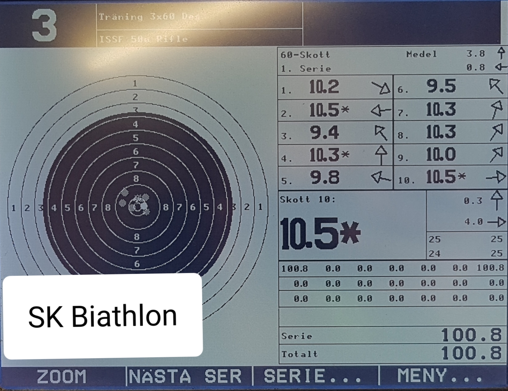

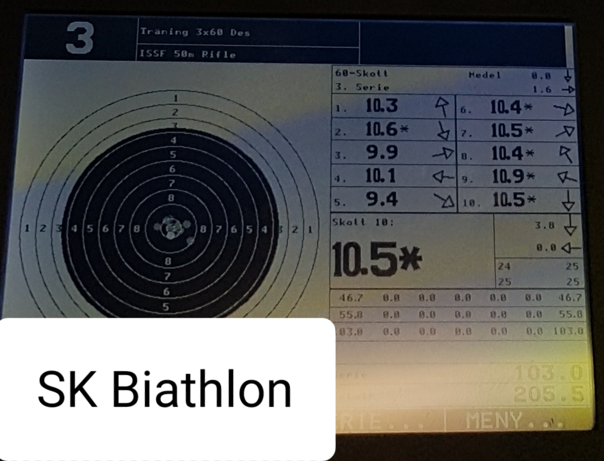

    Day 2 I started with SK Biathlons and they worked wonderfully. Despite the leg bothering I also had my focus on another level. But I got tired and shaky very quickly as I have been mainly lying down past 4 weeks. By the time I finished my 30 shot score my final score was 305.5.
    Below is my 1st warmup and 2nd warmup before 30 shot string.
    7084348
    7084355
    While I was somewhat satisfied with the results done with Lapua Biathlon I have noticed the accuracy has dropped on this barrel. After reading RRD rimfire cleaning document and seeing what kind of damage the fouling does I decided to another try.

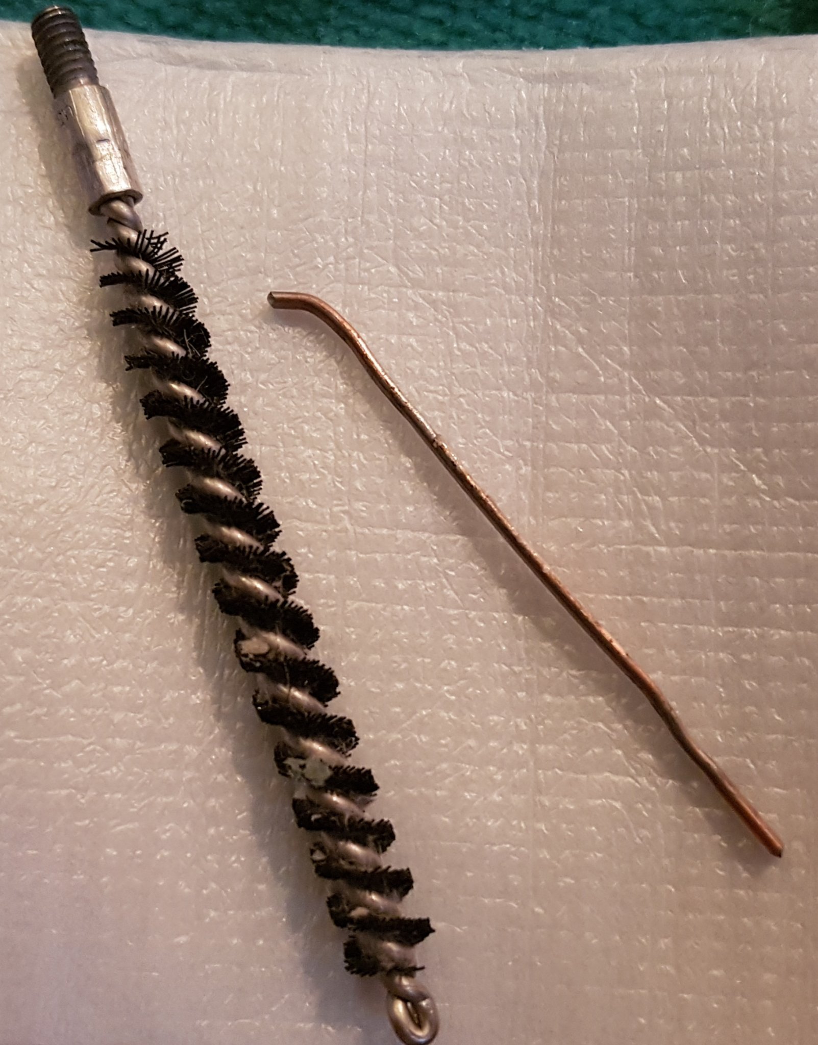

    I used modified softer than barrel metal pick which I got from ammo cardboard box and rubbed the chamber with it after long Eliminator soak.
    The bad news that by feeling out with the pick I can tell there are some bad shapes in the chamber and I cannot even them out without (probably excessive) use of abrasives. Also, I noticed small pitting 1-2 inch from chamber.. I have ordered some BT Rimfire blend which I will be tending my chamber from now on.
    Pick with size reference:
    7099422
    Chamber as good as it gets, with minor dust:
    7099423
    I have no problems with feeding/ejecting out of this chamber and the rifle has been quite accurate but I will be getting an aftermarket one..

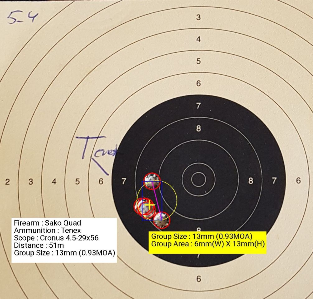

    I have so far once tried running Eley Tenex out of clean barrel and only first shot went off the mark. The optic was then zeroed for another cartridge.
    And it is quite usual for the first shot to hit high anyways so I guess the barrel does not mind me cleaning it.
    Distance was tad over 51m so 56yd.
    0.5" group
    The group which formed below it was 0.32".
    Note, I hope I could shot 0.32" consistently but I can not and this was without any warming up so it could be smaller with a better shooter.

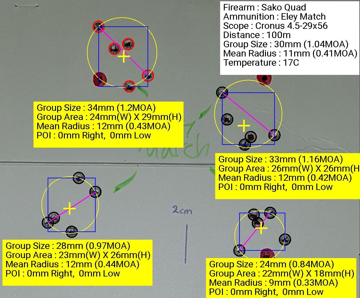

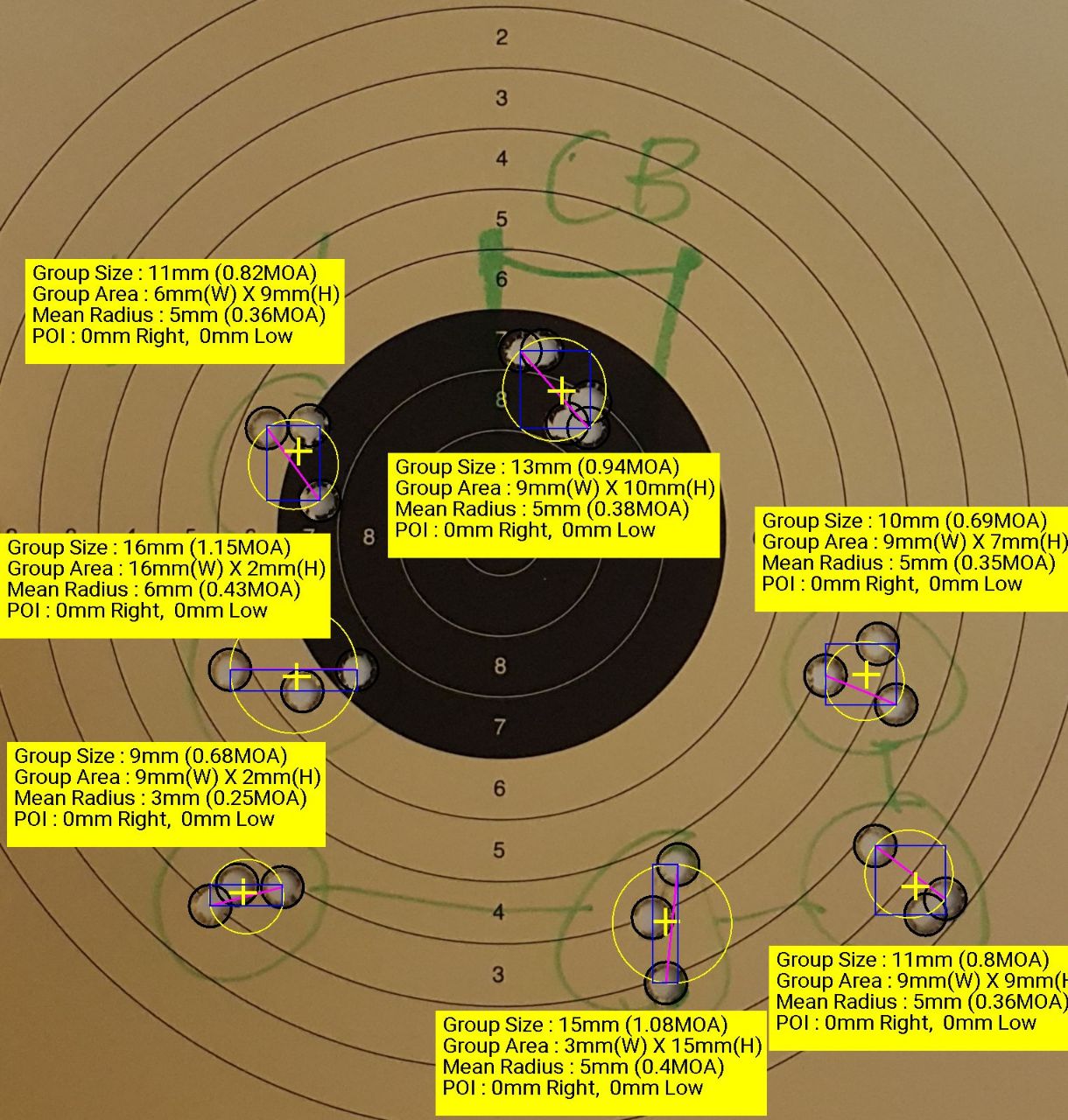

    For anyone interested I thought I'd make a follow up post.

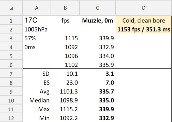

    This time I chronoed the cold bore group. Sadly I was not able to keep form during the string and had 2 POIs for the group. This 10 o'clock grouping is usual for me and I am working on it.
    The first shot hit to the higher group though.
    The below SD and ES does not include the CB shot.
    Here is the Cold Bore paper, I also started testing different torques and settled for the highest torque which "locked on".
    All in all, not too good shooting from me. I did test Eley Match the last time I went and got 1 moa at 109yds.
    Good ammo gives confidence and the groups got improved from first to last one.
    Gun is clearly not the weakest link anymore, thanks to all of you for help!

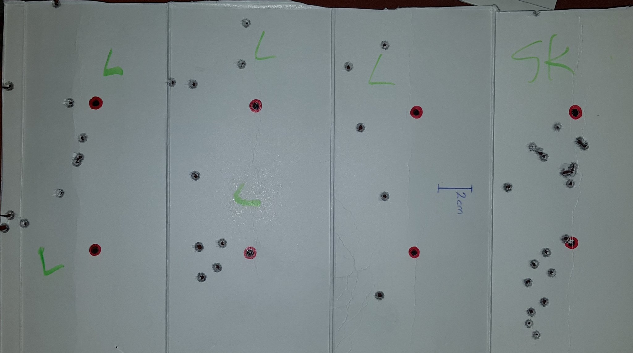

    I see what you mean. I had drawn my targets myself on a 0.4gal milk carton. The target is a black dot with red circle around it. Made with a marker.
    You can see it on the target #1 (top-left) and partially on #2 and #4. And on the targets on post below.
    Milk cartons do a good job showing the hole very clearly and take rain, shine and wind like nothing. I keep them folded for easy storage in my bag.
    Usually I use 10m pistol targets and make small dot on the blank side. But at that range the sun shines through the paper and shows the black circle on the wrong side etc..
    I think small part of the reason my shots were so wild in the #1 post is because my Lapua Biathlon lot (not all of it though) seems to hit straight out batshit crazy.
    I complained about these cartridges to my retailer already.
    This target is from the same date as the earlier.
    "L" for Lapua 5 shot group
    "SK" for 9 and 11 shot groups of SK Biathlon on the right for comparison. I was quite quick and sloppy with them after Lapuas hit so bad.
