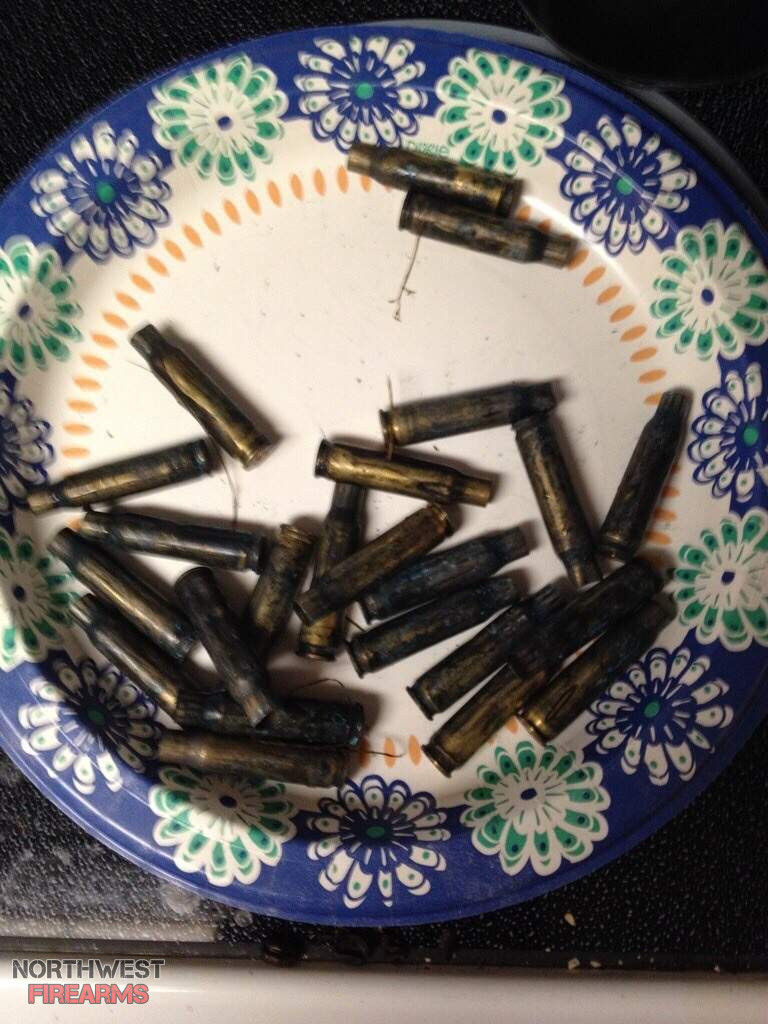

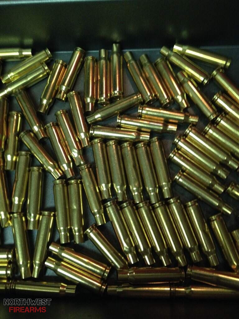

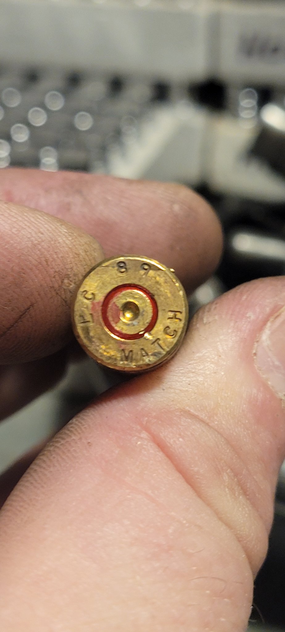

Going through brass from many trips to the range and came across these pieces of 308 LC match. What rifle does this and reason behind it. Never seen it before till this evening. Just curious and if anyone knows I would like to know.
Join the contestMaybe, but unlikely someone is ripping “match” ammo through a machine gun. Nor, likely they’re reloading “match” brass for a machine gun. But, it is a possibility.I'm guessing a machine gun. The fluted chamber helps reduce "cook off" of a cartridge.
Oh they are in the brass recycle bucketThose fluted cases are hard to resize. You might get it stuck in the die. Also, the rim looks bent where the extractor grabbed it. I would toss it.
It's 36 year old brass.Maybe, but unlikely someone is ripping “match” ammo through a machine gun. Nor, likely they’re reloading “match” brass for a machine gun. But, it is a possibility.
That's not the purpose of the fluting....it's sole purpose is to aid in extraction.I'm guessing a machine gun. The fluted chamber helps reduce "cook off" of a cartridge.
That's because the fluting is out of spec, it's too wide allowing the brass to flow into the flute and stretch tight in between.Could be a G3 or HK91, but I don't really recall it making flat sports...
G3's (HK/PTR91) & CETME's are pretty nifty, rival to the FN FAL's as the "Arms of the Free World".Never had the opportunity to hold or shoot any of the rifles yall have spoken aboit. One day I will have a chance. It looked like the rifling was continued into the chamber but fluting makes perfect sense with the amount of heat created.
Found a handful of 10mm brass with the flute marks mixed in a bag of once fired range brass I picked up at a gunshop couple years ago.Ok so found other pieces of brass that had signs of fluting but no where near like in my pictures. I even came across 9mm that seemed to have similar markings
That was my first thought as well, some roller delayed stuff and FAL’s I believe have fluted chambers.Heavily fluted chamber to aid extraction? HK-91 or LaRue OBR with "xtraxn". (SVT-41 also in 7.62x54R)
