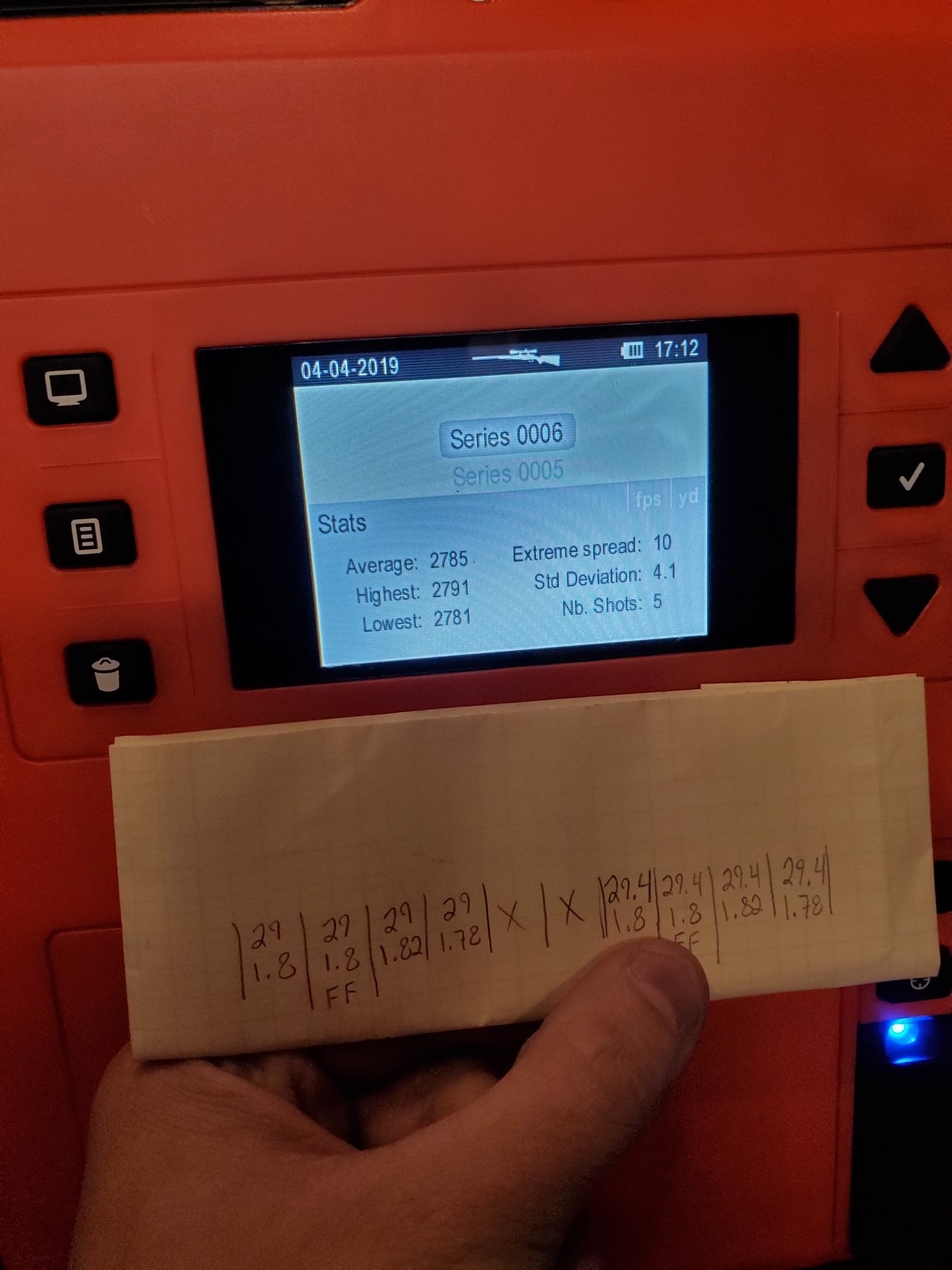

Below is a screenshot of the final results of load development for my 6BR last year. I haven't finalized my Dasher load yet for this year, but I also haven't done much with it so far given current events. This was with normal Lapua brass, just sized, chamfered, and loaded using Varget and CCI BR4's under a 115 DTAC.
