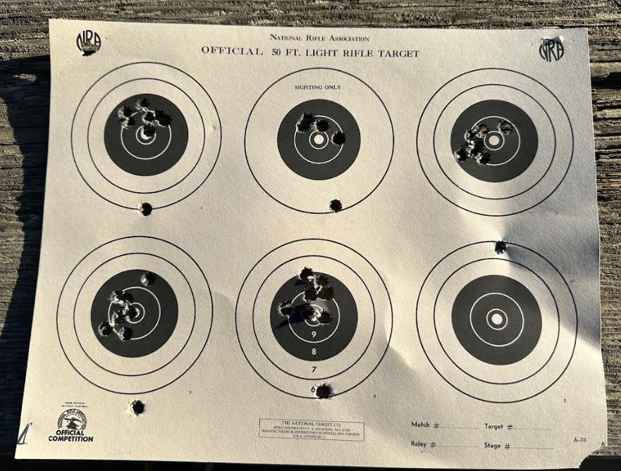

    So here's something I've never seen before.
    Was dialing in a new load for an MR762 I've had for ages, using 178 ELD-X with Varget, and got this repeatable situation where the first shot in every 8-shot string was consistently low. I only brought one mag to the range, so this is the same mag loading only one string at a time. My first thought initially was it was a strong cold bore offset, but after I loaded the second string, it repeated, and then the next.
    Maybe it's the mag doing something to the first cartridge? But still, isn't that weird?
    Speeds are consistent in the string. Closing the bolt with the bolt batch. I’ve had this rifle for almost 10 years shooting a variety of my own loads, but I’ve never seen behavior like this.
    It was 8 rounds every string, so not only will I try multiple mags next time, but I’ll also try varying amounts. It may be the mag, but the semi-educated scientist in me wants to understand the mechanism that would cause a consistent flyer like this?
    I have had a well used action/buffer spring cause similar issues closing from mag catch as apposed to the action cycling automatically. The travel and force from bolt catch is different than the regular cycle rate. Last round lock back can cause group issues as well.

    Try different mags... Vary the round count in the mags... And see if loading the first round with the charging handle (instead of releasing the bolt catch) makes a difference.

    Load 8. Fire 1. Eject the loaded round. Top up magazine to 8. Fire again. Repeat.
    Load 1. Fire. Repeat…
    Stop mid magazine, eject the round and measure the COAL compared to the original load. Wondering if some pulling or setback is happening when fired, that isn't happening dropping the bolt.
