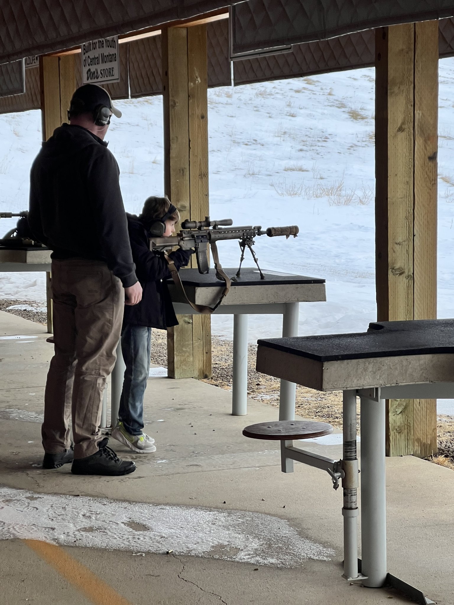

    Lemme get this straight.
    You are paying someone to assemble an AR lower?
    My 10 yr old put one together with some guidance from her old dad.
    Stripped Lower and boxes with parts.
    Upper including FA and dust cover.
    Even set the torque wrench herself.
    In her words “Best arts and crafts day ever!!!”
    Best part? Easily getting right at .5” 5 shot groups at 100 with it.
    And easy banging steel to 500 (furthest I have tried with current 1-4 optic.

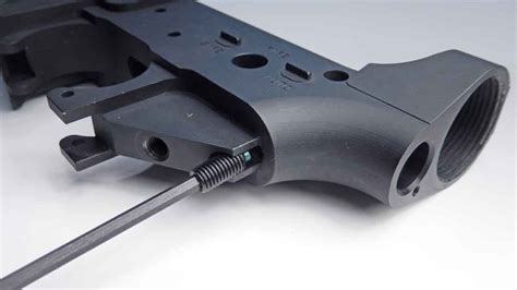

    Ya that included the drunk decisions. I found out I can't order a lower straight to my house. My FFL I use is 40 minutes away from me. So I just told him throw some shit together. He does good work, but then he hit me out of now where when he asked me what all I wanted. Initially I was just going to through it on my FN military collector lower. So laziness was definitely involved. Lol. I just told him if I have to make the drive anyways to pick up a lower he might as well put it together.
    Reactions: powdahound76
    Update pictures will follow at a later date.
    Got my lower back
    Aero x15 multi cal lower
    Rifle Length buffer and a2 stock
    I was undecided on my trigger (sorry new to all this I've never used anything other than milspec/what comes with the gun) So I ended up telling him to choose for me. He went with Timney Triggers DH3 Daniel Horner Signature Single-Stage Straight Trigger with 3 lbs Draw Weight & Anodized Finish
    Currently stock a2 grip which I don't mind might switch in the future

    So my aero lower and pri upper have a wiggle to them. Not the worst but kind of annoying. I know with the way a m16 system works that shouldn't have any impact on accuracy due to everything being in the upper, buttttttt it's annoying I got lucky in the army all my m4's had a rather tight fitment, my FN m4 military collector also has a rather no play fitment. How do I fix this I read about these things that can be inserted for cheap forgot what they are called though.
    Gen 2 Aero lowers have a nylon tipped tensioning screw under the grip. Tighten it up until you find a happy medium of slop and being able to push the takedown pin out.
    Reactions: rpoL98
    That's why I love this place. Thanks guys I will have to try that. If for whatever reason that doesn't work I'll give the accuwedge a try.
    The tensioning screw should help with your issue, but there is a company called TriggerShims that makes a ton of firearm shims and gunsmith supplies, including for ARs. Old school owner and website, a bit of scrolling to find what you need. They have a pivot pin shim set that works for lateral movement. JP Enterprises makes oversize MicroFit takedown/pivot pins, but those can require some gunsmithing skills and tools.
    Reactions: jpop8807
    Thank you very much.
    Reactions: msgriff
