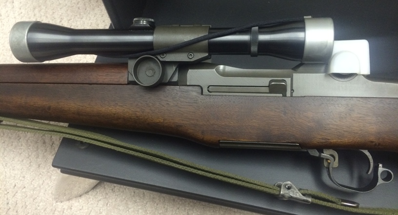

I don't know about Weaver K4s on 1903A4s per se, but I do know that the U.S. Army bought 1,800 Weaver K4 scopes and special 1" diameter M1D scope brackets in 1964. They were delivered by 1965. So the US Army did a limited procurement of these scopes in the mid-1960s, and a few reportedly made it to Vietnam, but I think most were reportedly for National Guard use. (Best reference on this topic is Bruce Canfield's book, The M1 Garand)
In the mid-1990s DCM/CMP sold off all their surplus obsolete sniper scopes, including the somewhat hard to find 1" M1D mounts and matching Weaver K4 scopes. I got my example from an older collector who was disposing of his collection, who had purchased it from the DCM back in that hey-day. (I think he paid $175 for the scope and bracket back in 1995, but today this optic combo is a good bit more pricey).
So, with 1800 of these scopes "in the supply system" as of 1965, it doesn't surprise me if a few were put on old 1903A4s, along with 1" rings. My 2cts.
