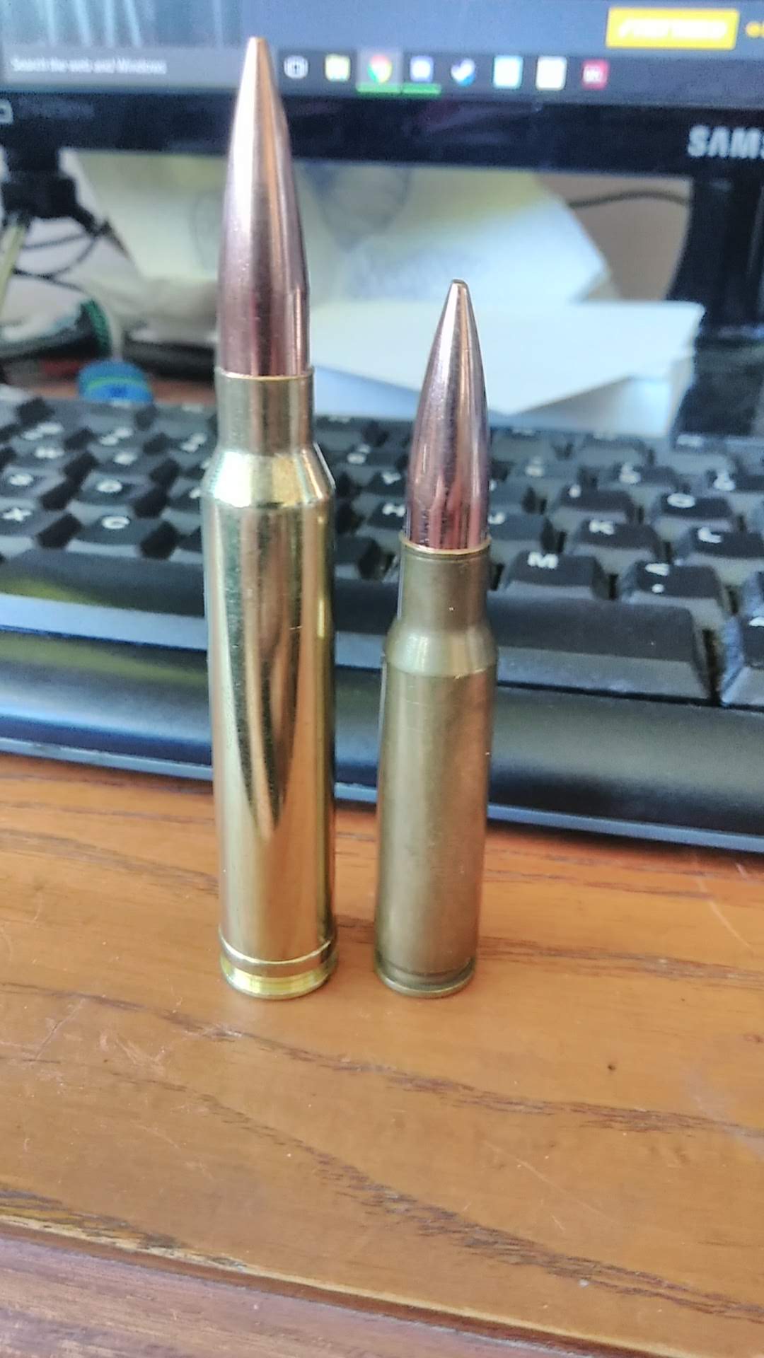

Ive been using a wet tumbler to clean my brass for about 4 years now, I cant seem to get the brass of my 308 Winchester to be as bright and shiny as my 300 win mag or 223 brass.
I dont know if its something Im doing wrong or if its just how the brass acts. Is there any way that I can get this brass back to looking good. I know my issue is merely cosmetic but I like my ammo to look as good as it shoots.
