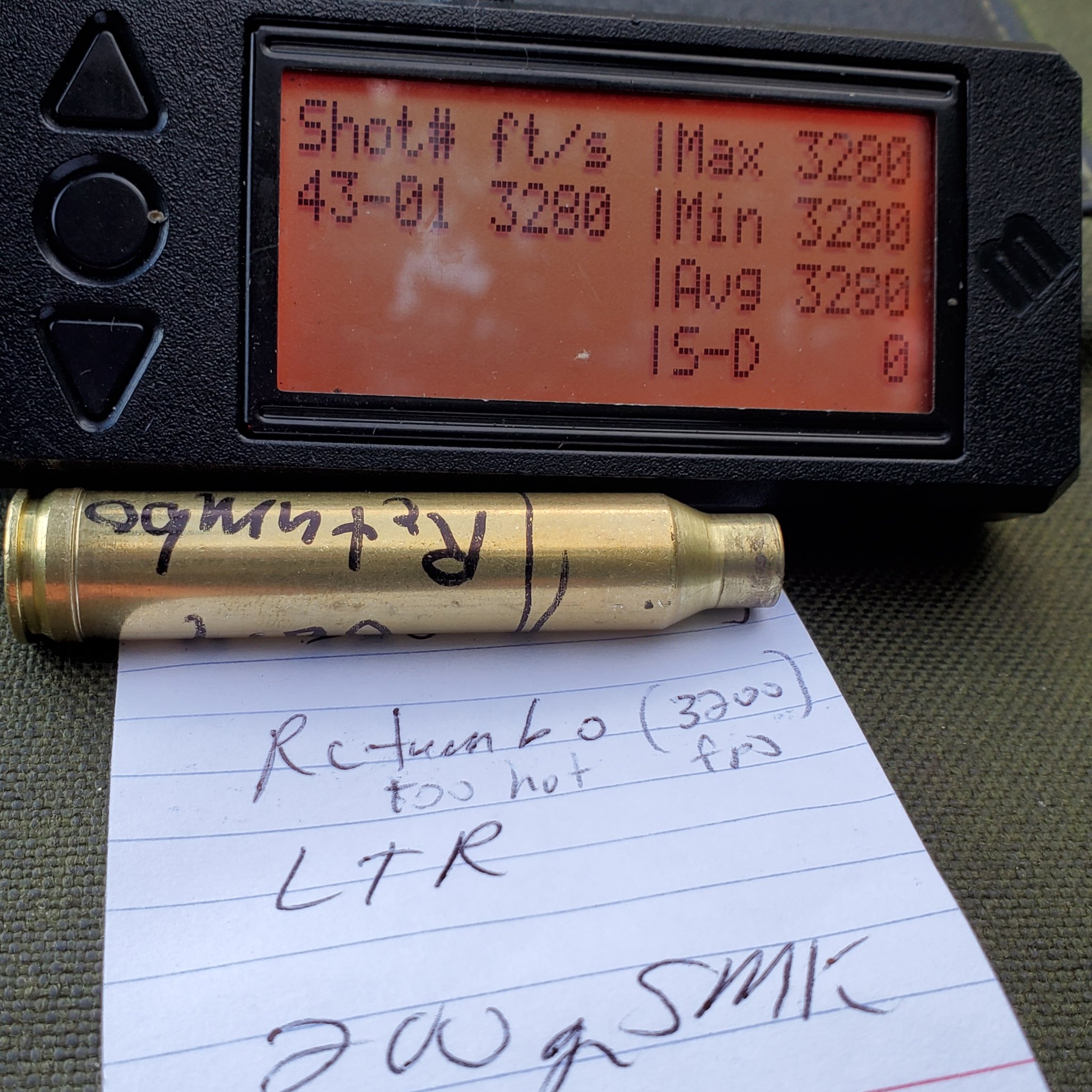

A 20fps increase in MV due to heat is not the end of the world. It is still well within normal distribution for most good hunting loads. If it results in more than 1/2MOA on target, then your problem is elsewhere.
You’ve got a point about velocity. If my ES goes from 10 to 30 cause I’m shooting out of a hot chamber, it’s only 6 inches difference at 1000. It would be negligible at 500.
Sounds like the answer here is to stop trying to do ladders on paper. I guess you could accomplish the same thing by only paying attention to your chrono.
So I’ll “ladder test” by shooting rounds 5-10 min apart and watching the chrono instead of the paper (I’ll loose some accuracy by re-positioning for every shot so I can’t use the paper to look for nodes, but my chrono data won’t be thrown off by hot powder since I’m shooting cold bore with every shot). Then once I’ve found a node, I’ll fine tune with 3-shot groups back-to-back at 500 yards and not worry about the velocity spread. I don’t want to push it to 5-shot groups, that’ll toast my barrel 😁
Ignore the paper when ladder testing, ignore the chrono when fine-tuning with 3-shot groups. Counter-intuitive, but it works now that I think about it.

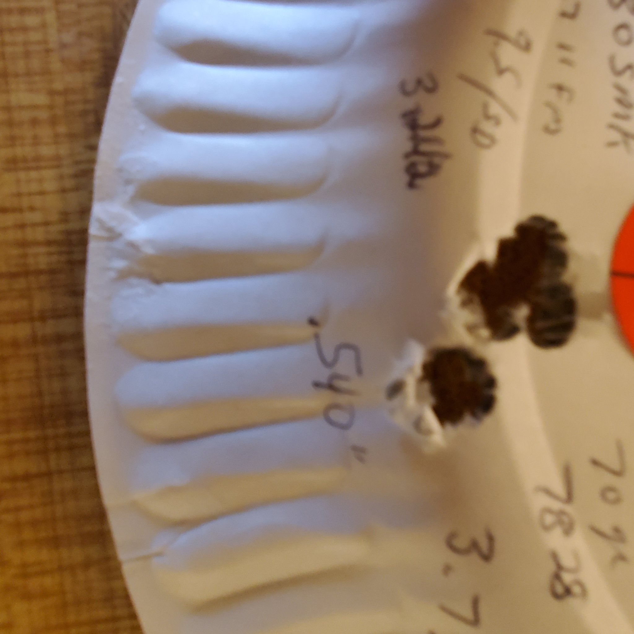

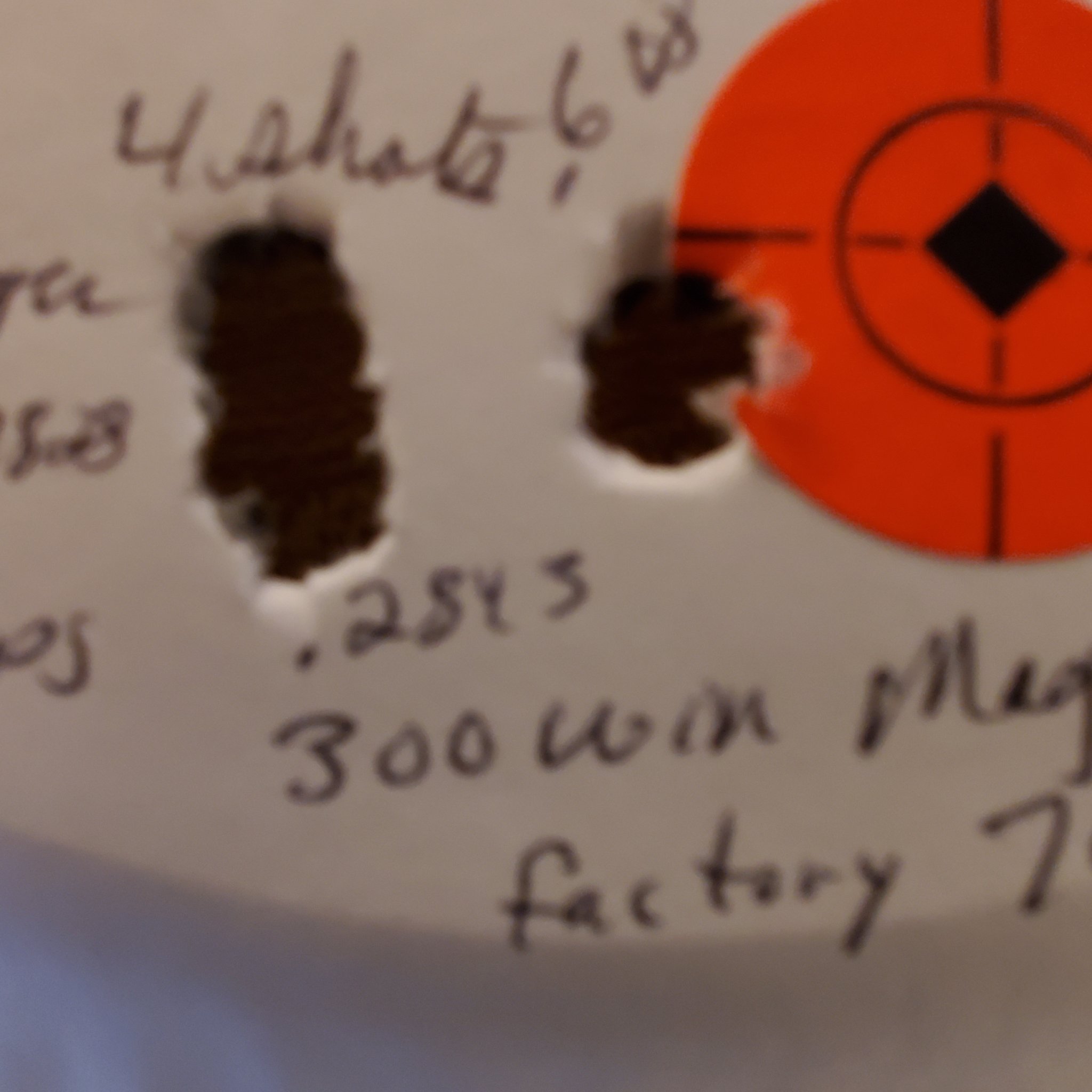

Put the slip-on back on, spent time at a shorter range close to me to work out getting rid of my flinch and get zero'd enough to be on paper at 100 yards.
Saturday, first 3 shots for group were .81 MOA. Which is acceptable for me as a hunter shooting only to about 400 yards or less. 300 yards is in my comfort zone and also about the longest distance I can shoot where I hunt. And I am not shooting more than 3 times at an animal.
Then, after adjusting to get zero, (only had to touch elevation once and windage once, 4 mph wind one whisker hair left of head on.) I shot a 5 shot for gits and shiggles. I had a flier that was me, I squeezed on a movement. That one flier made it 1.16 MOA. I kept it in because me and the rifle are a shooting system.
So, yeah, the problem is managing recoil, especially in non-standard positions, with larger, including magnum rounds.

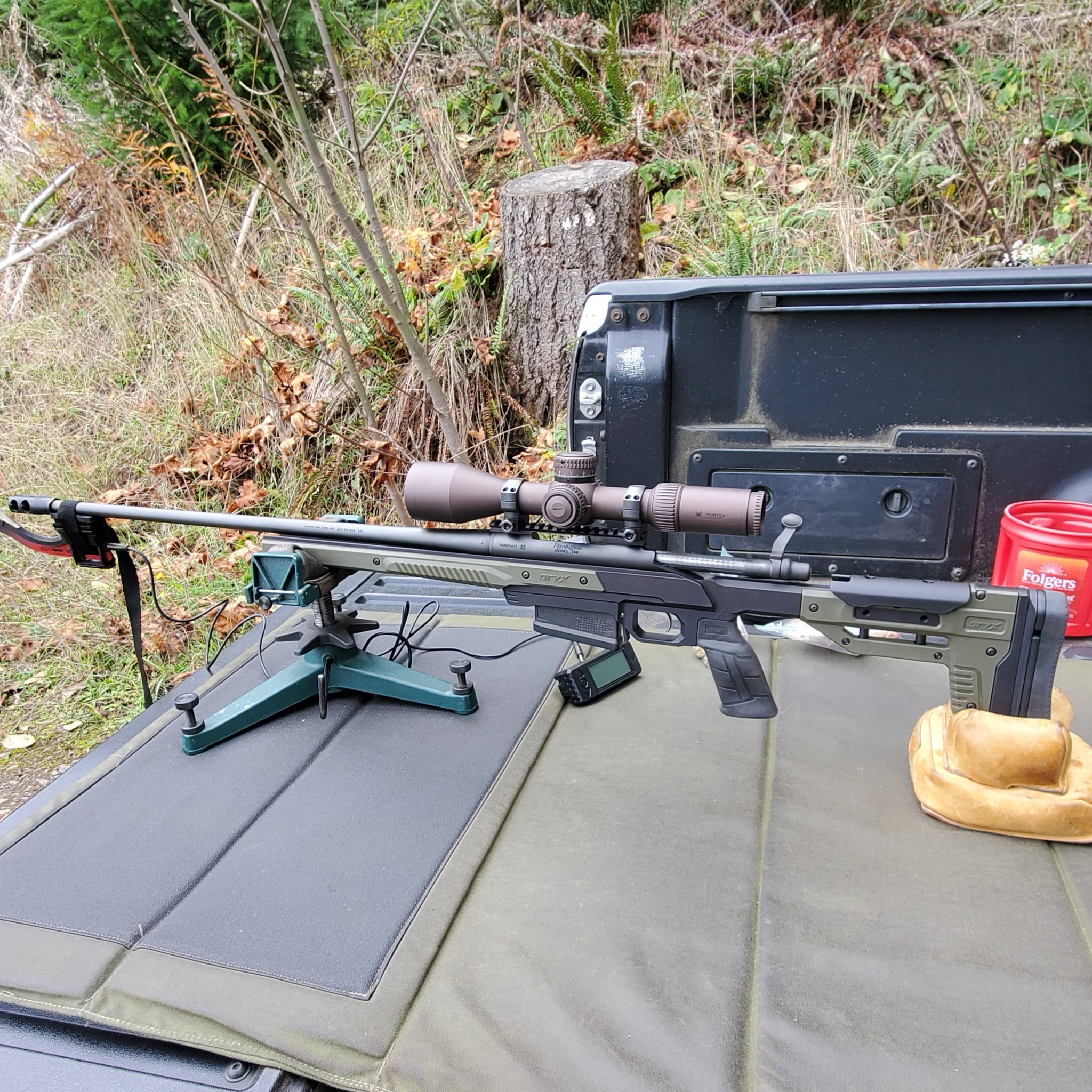

I bought the cheapest Rem 700 magnum ADL I could find on sale $540 out the door in 300 WM...I just wanted the action.
Before taking off the factory barrel, I wondered... How accurate is todays new factory Rem 700 rifle?
To give the skinny 26" factory barreled action the best effort to achieve accuracy...I installed a muzzle brake and put it in an aluminum chassis.
Everything else stock. No factory ammo but handloads with imr 7828 and 200 SMK closed nose bullets.
The new detachable mag in tbe aluminum chassis allowed for 3.7" COAL to get the long profiled high BC bullets close to the lands.
Shot 5 shots without letting it cool just one after the other. All 5 went into a half inch first 5 shot group.
But it most always put the first 3 into almost the same hole....like .284" for 3 shots here was common. I also abused the piss out of it ran 200 SMK at 3280 fps with the long COAL. Too hot as the case is marked up as max...but 3200 was possible.
So take a factory magnum, put it in an aluminum chassis, add a muzzle brake, get the chassis that will allow extra long
cartridges, to be fead from long center feed mags, so one can seat the bullets out near the lands, and add more powder if ya want.
Alot of difference between 3.340" and 3.7" or 3.8" for LR bullets.
So there is a $540 Rem 300 WM capable of 1/4" 3 shot groups or 5 into 1/2" with the bullets it likes seated out and properly bedded, or chassis with a high dollar scope because I can barely see...actually begin shooting left handed because of bad eyesight in right eye, and why a shot may be a bit misplaced, possibly the shooter and not the cheap rifle.
