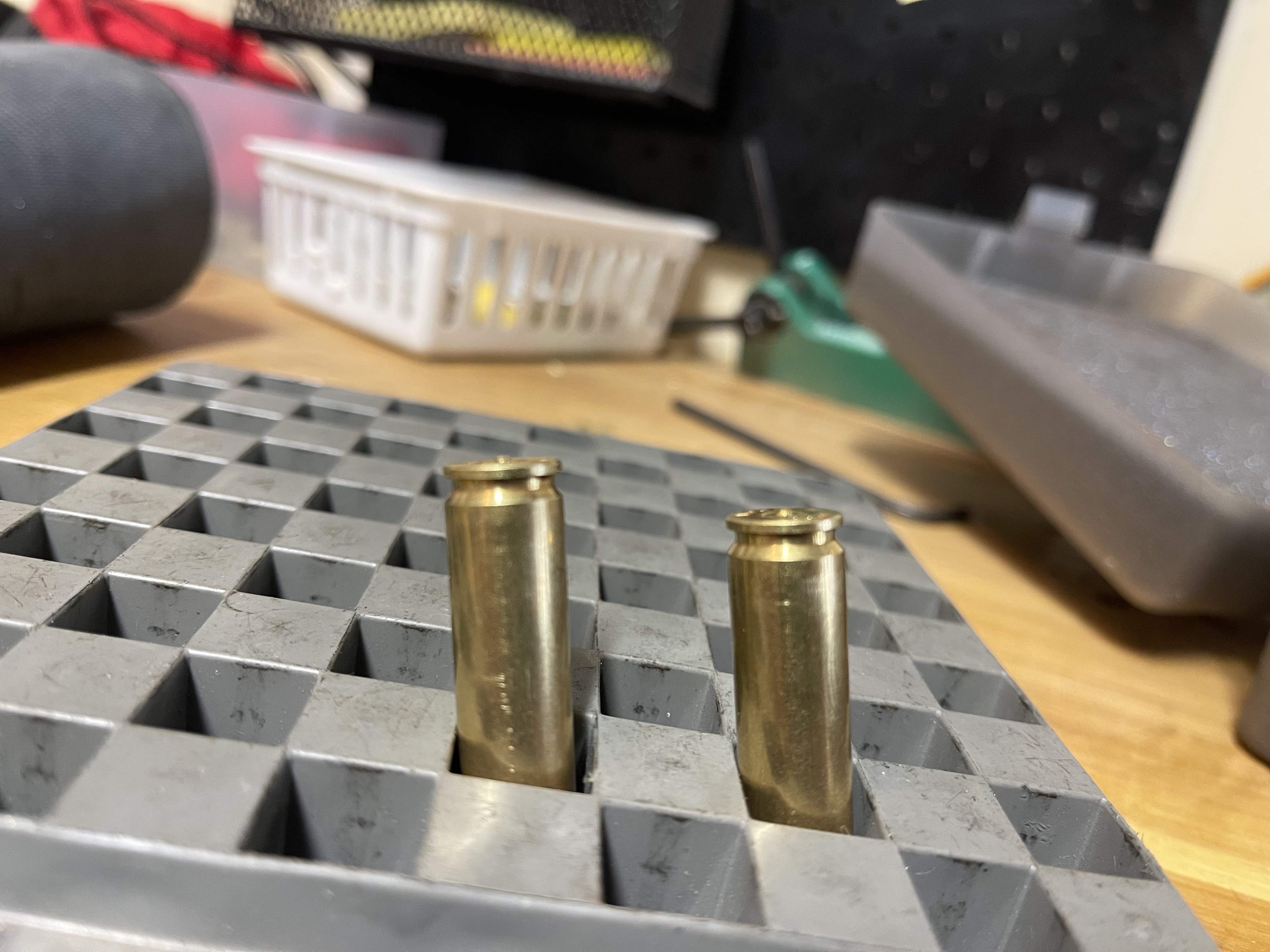

BLUF: CDG with PVA 25x47 having failure to fire 7-12% of the time.
Potential causes I can think of:

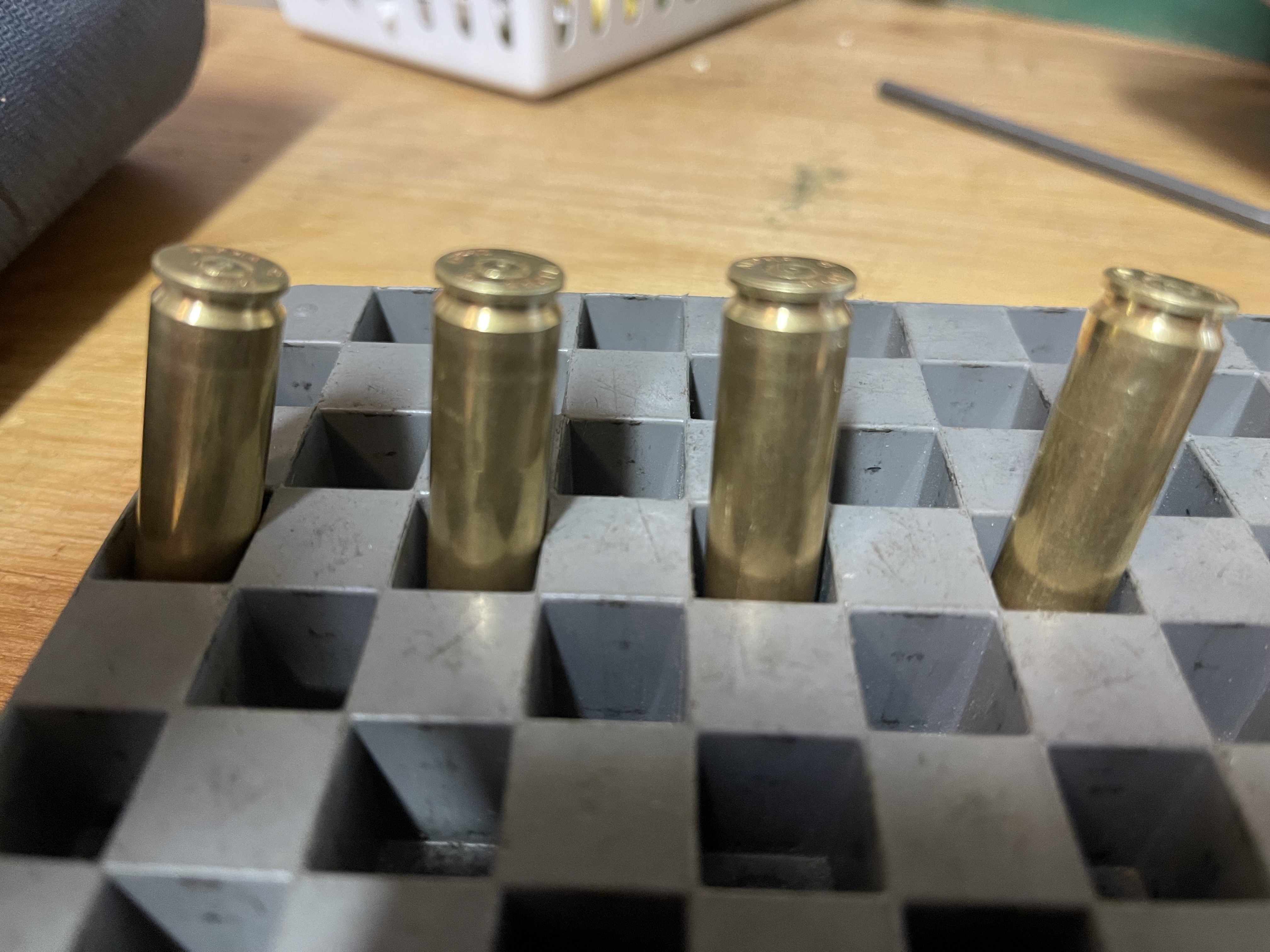

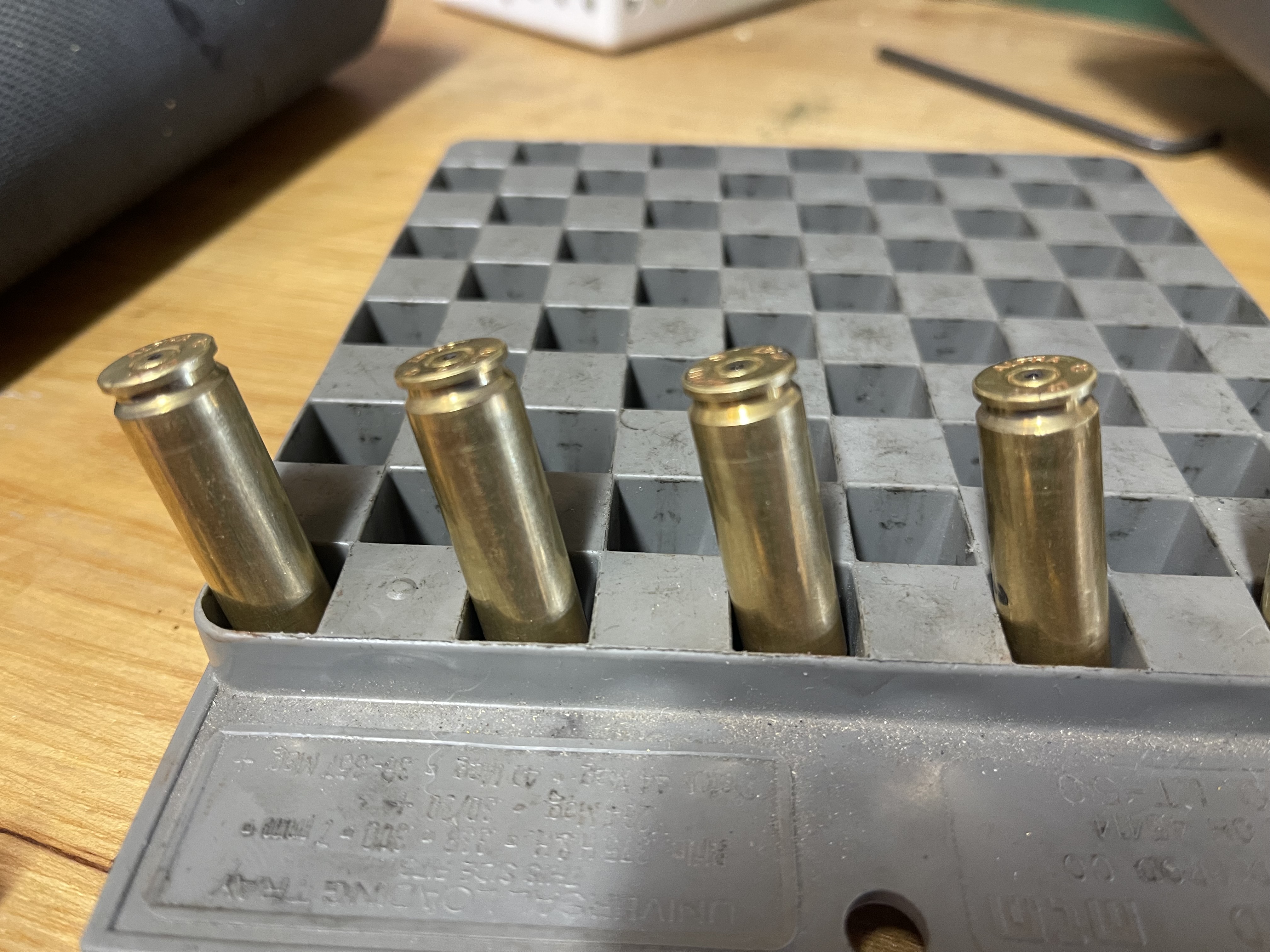

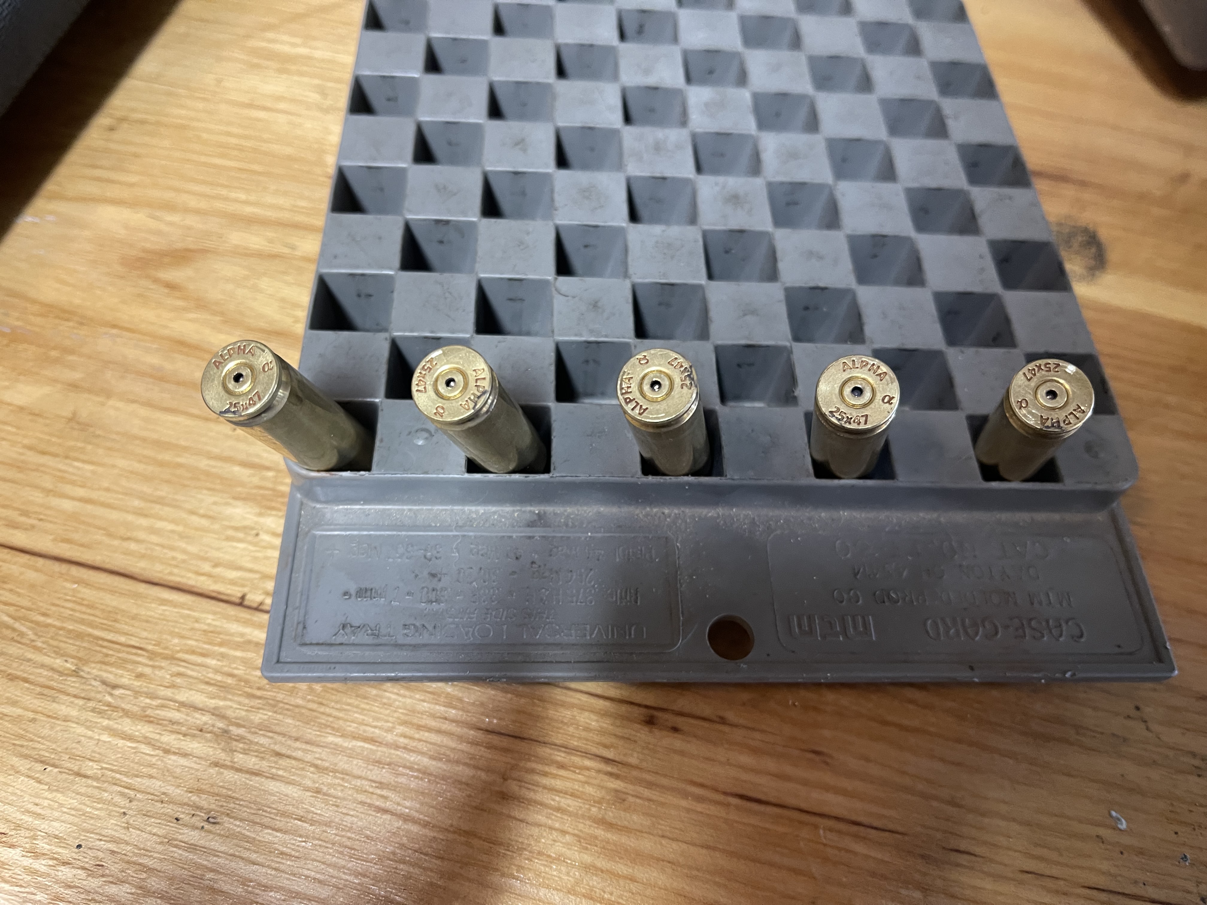

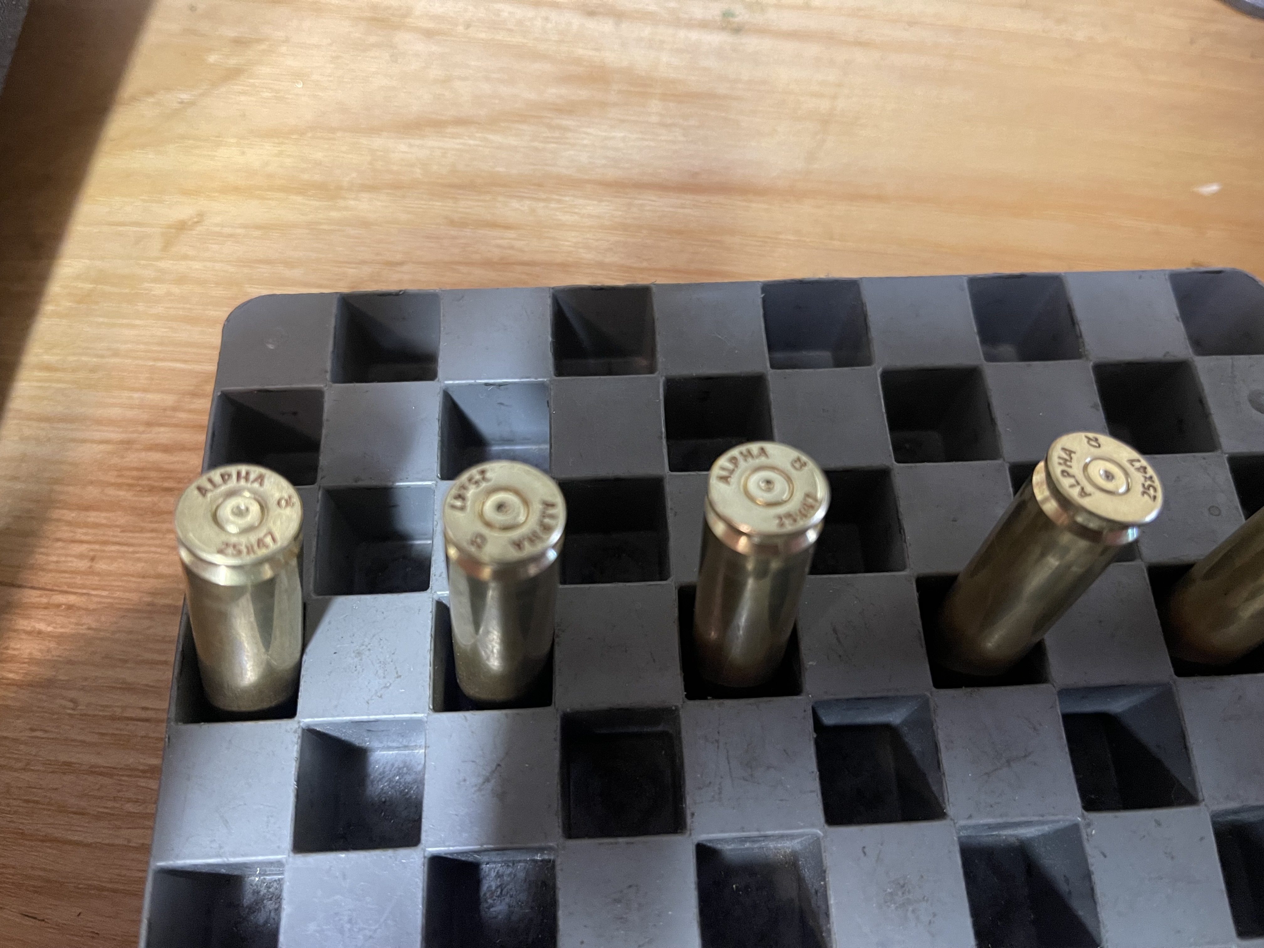

1. over pressure on load causing black primer strikes (see photo) melting primer material on to firing pin.
2. Pivoting feature on CDG bolt? Haven’t tried non pivoting, running a TT Special at 1lb 2 oz. I’m only aware that running a light trigger (TT Diamond etc) can cause issues but I don’t know what type.

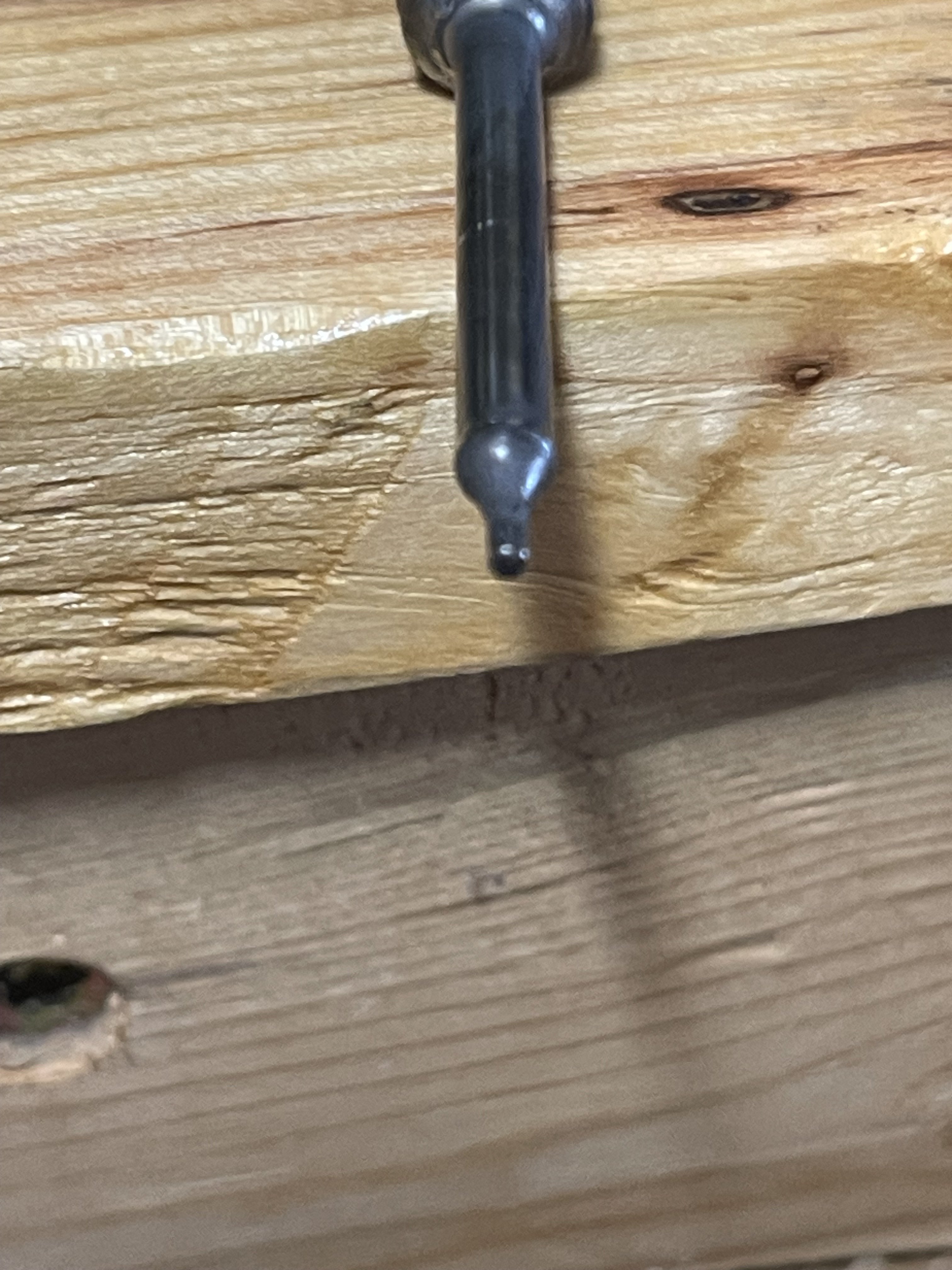

3. Firing pin assembly issue? This failure to fire isn’t consistent. It is almost always after I get a pierced primer or black primer strike (see photo) if I’m calling it the wrong thing. I can’t see any issues on the surface of the firing pin but maybe.
Background:
90-92 degrees out but also had this issue when it was approximately 80 out.
Load: Berger 135 long range hybrid.
Shooters world precision at 37.4 gr with both cci 41 and 400s.
H4350 at 40.4 gr.
I have been above both of those load numbers by about .4-.5 and felt a little tougher bolt lift and backed it down. Even at the higher chargers this issue wasn’t consistent.
Any ideas as to the root? I appreciate it. Going to reach out to ARC as well

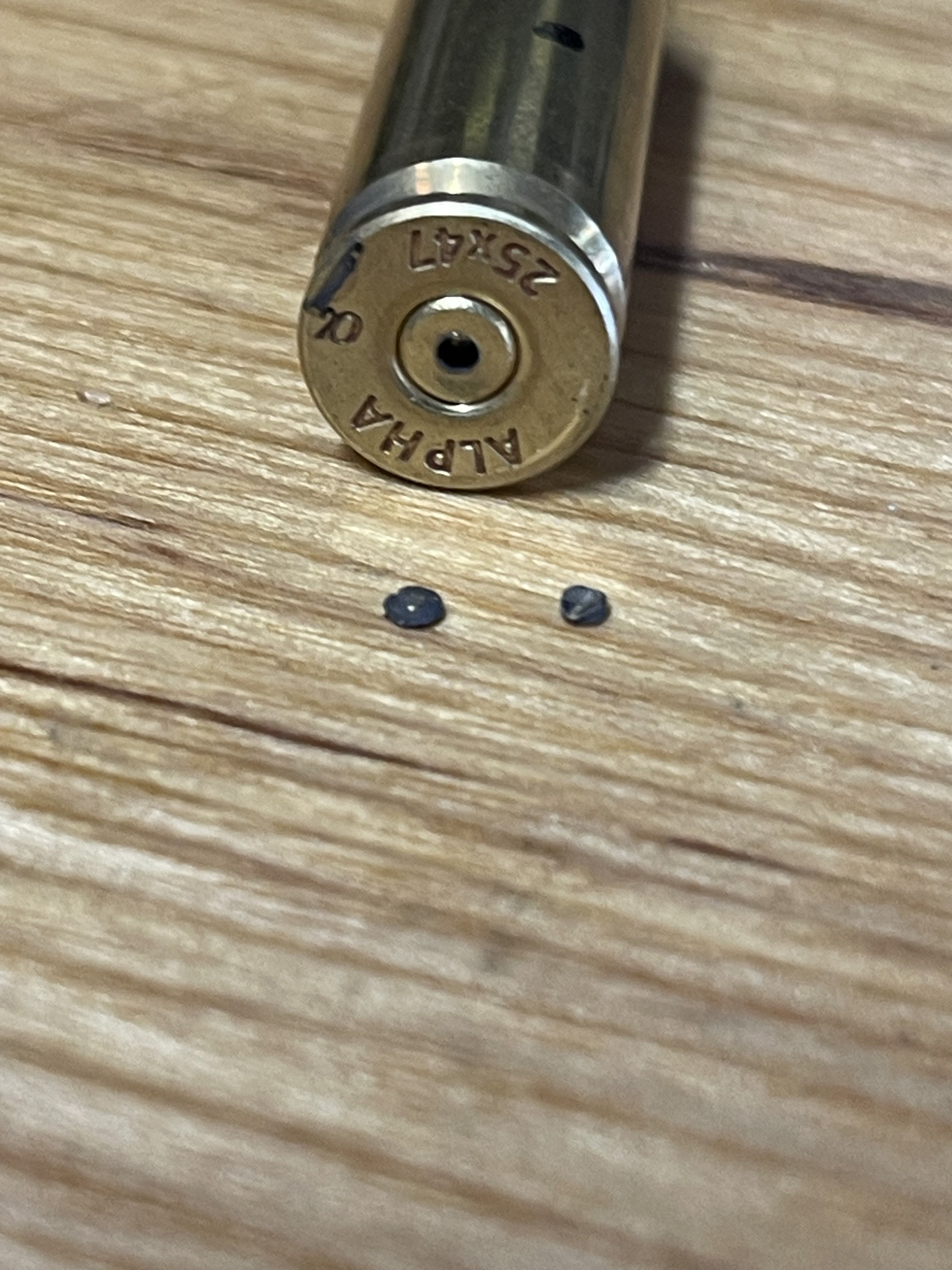

The photo with the 2 metal dots in front of the piece of brass is from when a black primer strike happened and it came out with the firing pin or got stuck in the flash hole of the bolt head.
The photo of the 2 pieces of brass is the metal not coming completely off of the primer with the firing pin.
This load was consistent with an SD of 4.8 for SW and 6.2 for H4350. I think that rules out a random higher charge causing it.

They are called punctured primers. It’s sending a jet of plasma down the primer and into the bolt face firing pin hole. Stop after one and fix, don’t keep grabbing the tiger by the tail.
Don’t use 400 primers, they are thinner and more easily punctured.
I can’t see much of the fuzzy firing pin but it likely popped a 400 once and the jet of plasma deformed it a bit making it more likely to puncture again, a vicious circle.
If we look at shooters world 6x47 and 6.5x47 load data with equivalently heavy for caliber bullets and interpolate, you’re over their max loads.
Max loads on thin primers is a recipe for this situation.
So the easy fix dial back the load and buy a new firing pin?
Reactions: Markbsae
Carbon is likely blasting down inside the bolt body, some is probably accumulated inside the bolt/fp hole, reducing the energy of the pin falling causing the light strikes. The hot plasma gas will eventually etch your bolt face and eat into the fp hole as well as the pin itself. The pin will get gas cut and rough, causing liklihood of even more pierced primer. These pressures often travel the bolt down down into the trigger housing, causing trigger damage. Don't do this!
Cci400s suck for performance bolt guns. Switch to 450s if possible.
37+ gr varget equivalent may be a bit stout in the 25x47, 37.2 gr was getting spicy in my 28in 25x47 at 2780fps.
Those little disks detach and interfere with the firing pin strike.
Usually caused by a firing pin tip that does not have enough of a radius, i.e. a flat tip. It should have a rounded tip. The flat tip works as a punch resulting in nice round holes. Get the gunsmith to round the tip and smooth it out.
Take a better quality photo of the firing pin tip.
Another cause is if the firing pin hole is overlarge. Some Howa bolts are known for this. When shooting stout loads the primer protrudes so far into the bolt that it shears off and stays inside the pin channel. To fix, either get a bush installed or get a firing pin with a larger diameter pin.

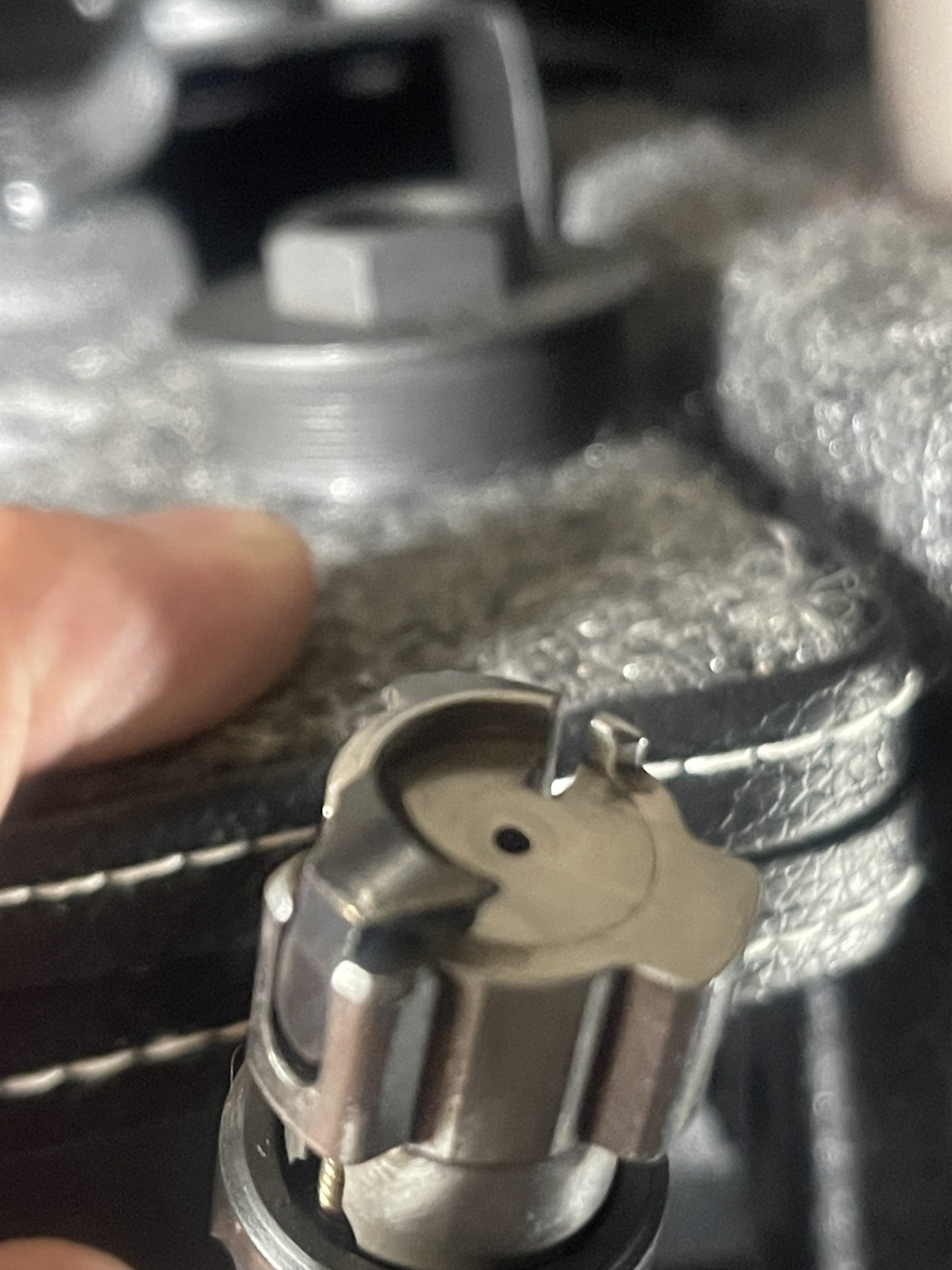

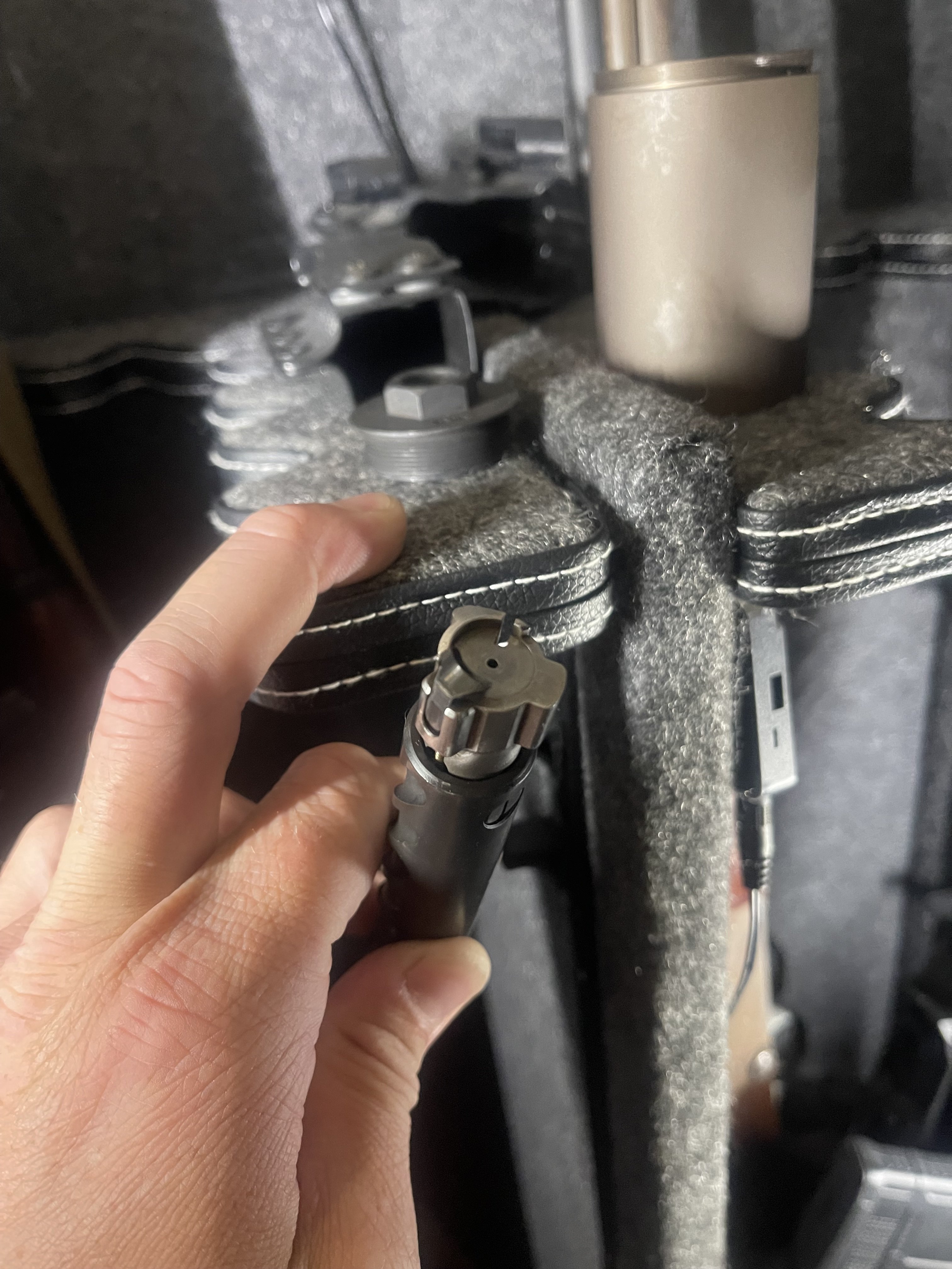

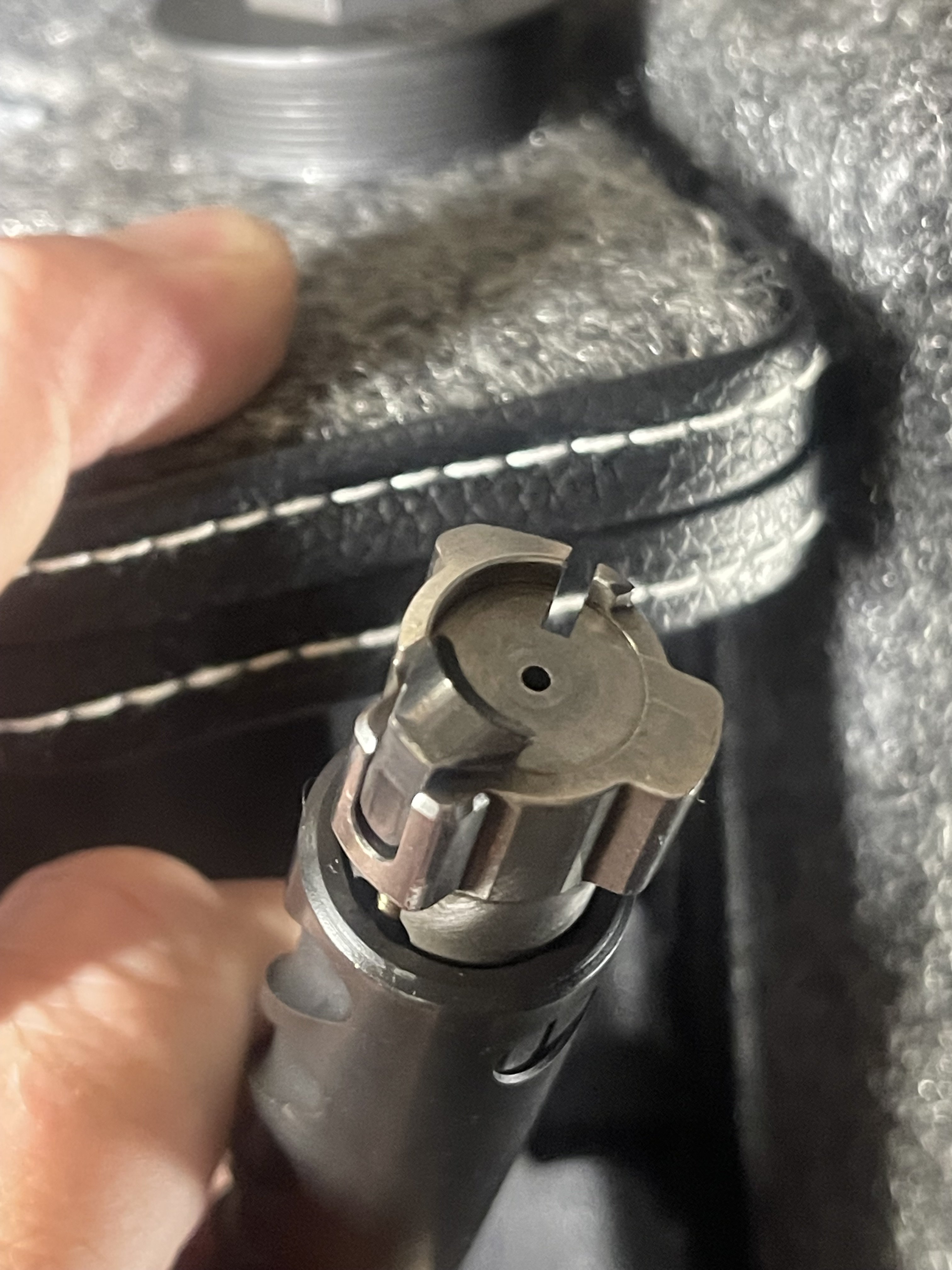

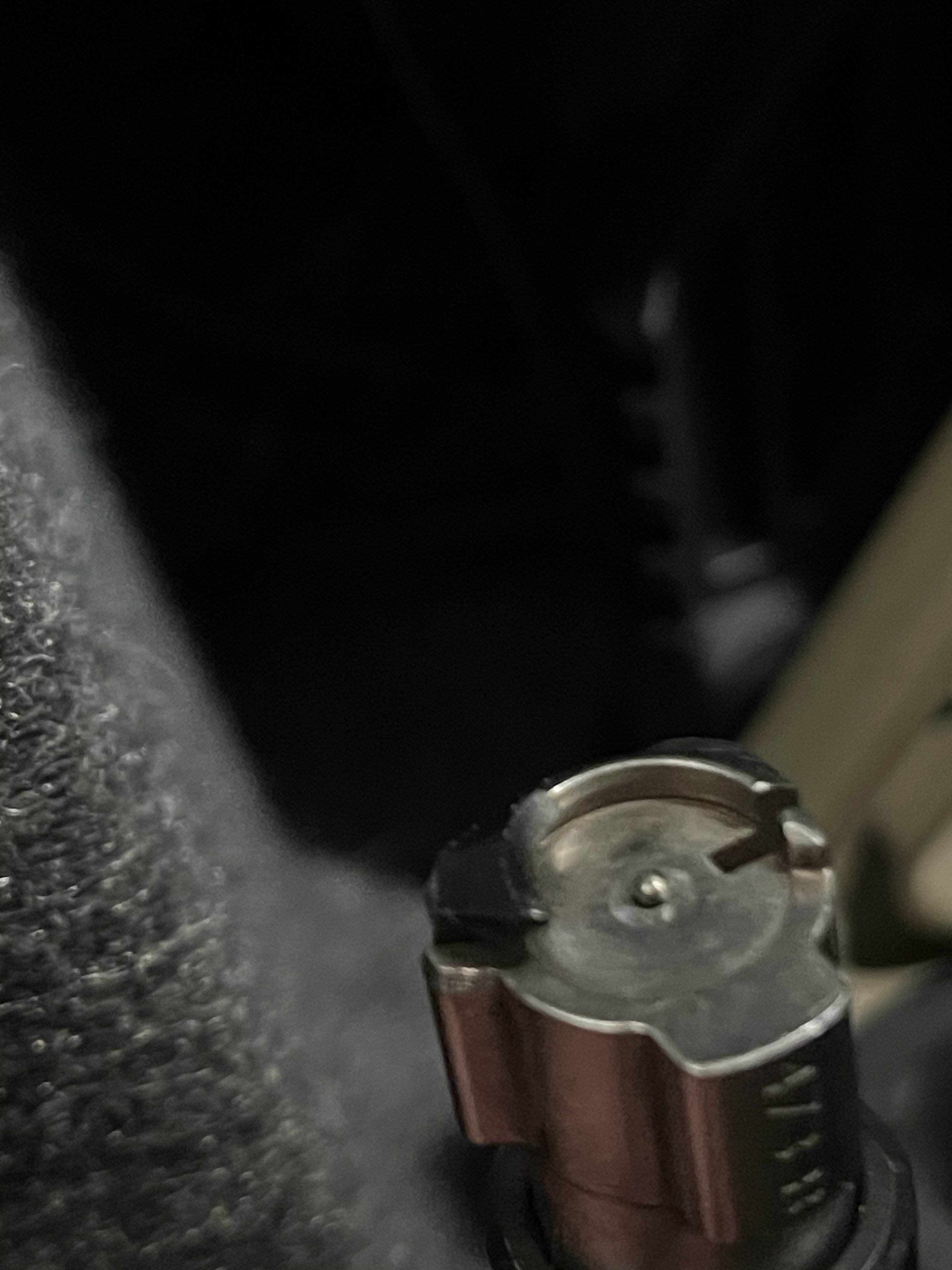

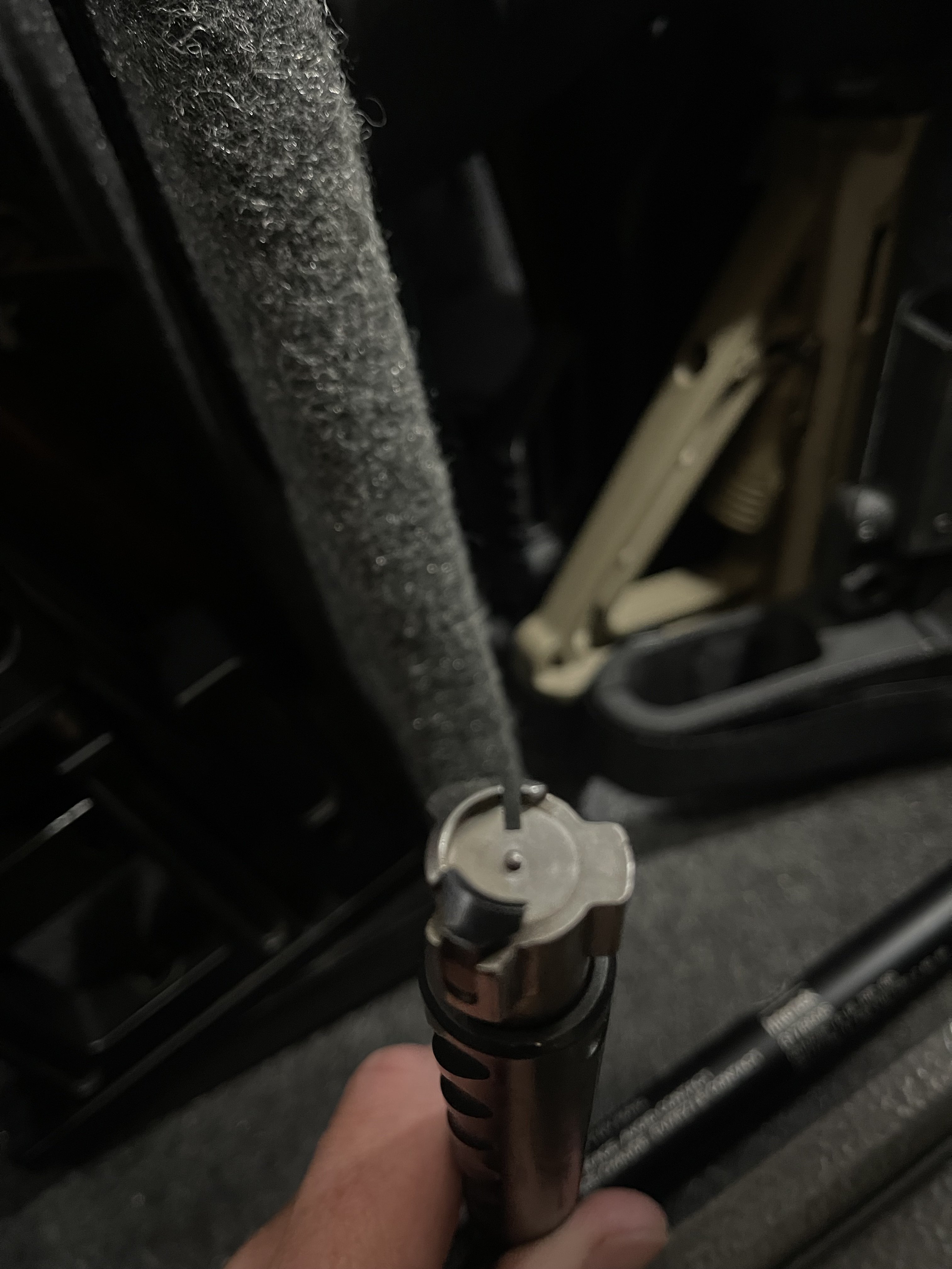

Take a quality photo of your bolt face with the firing pin protruding.
Tried to get a couple angles of the firing pin on the bolt. From what I can see, even with a crappy little magnifying glass, the firing pin looks the same consistency as my TL3 firing pin tip and Solus tip. No marring that I could tell but I’ve never diagnosed a firing pin issue

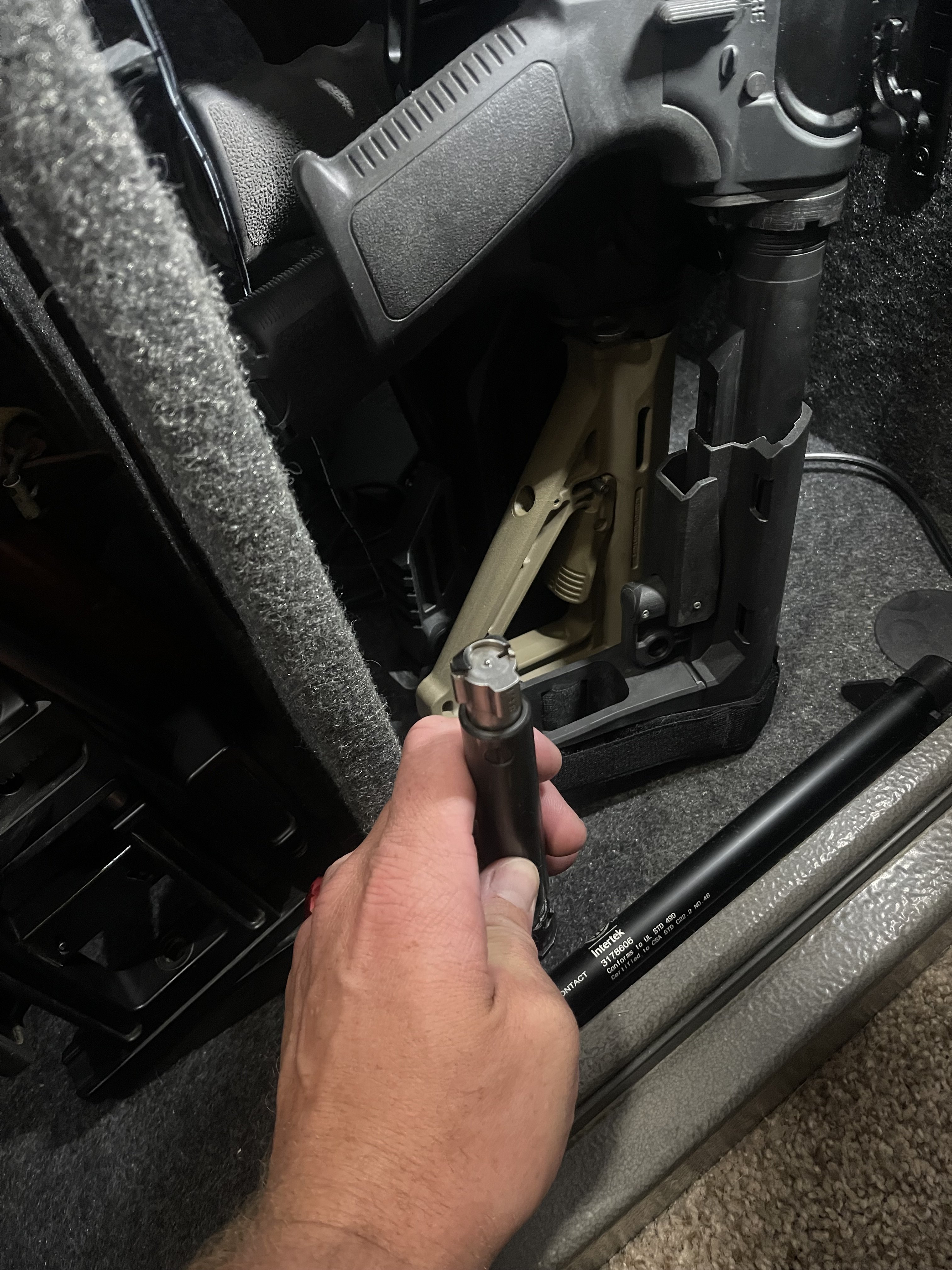

Firing pin is fully recessed when decocked, I don’t have a great way to measure the depth from bolt surface but it does appear below it

@4O6shootist these should be decocked, if they don’t show up in this post they’re in post #7
Change primers with thicker .025" cups, which are Rem 7 1/2, CCI 450, CCI 41, BR 4, ...And no others.
400s have thin .022" cups and prone to blank with high pressures.
So put Rem 7 1/2 primers drop the powder charge a grain or so and problem should end...then work back up and see what happens.
I run 6 Dasher 110 gr SMK with Alpha brass, 38.5 grs of powder, at 3085 fps and Rem 7 1/2 primer no problem.

All you need to do is read this and let it sink in . You found your answer right here . Over max and you wonder what is going on :rolleyes:
Definitely going to dial the powder back and swap primers, trying to see if I anyone can tell if I need to replace the pin as well
You’re probably fine but taking a picture where you actually focus on the firing pin makes it easier.
I certainly would take 45-90s advice to drop only a grain and work back up to where you are currently at. Start at a minimum and work up, not at max and proceed right past max.
Use the depth part of calipers to measure pin protrusion when fp is in the "fired" state. Too much protrusion, thin primers cups(cci400), and max or near max load can cause this, by themselves or in combination. Those primer disc's can definitely cause drag of fp or fail to ignite from bleeding too much energy from fp drop, via drag on spring/fp inside bolt body.

Update on my end.
Contacted ARC they provided me a new striker and a stronger spring (100 NM if I remember correctly).
The gentleman I spoke with stated they have run into this issue specifically with alpha brass. Not a knock on alpha, it’s great, just a small issue they’ve noticed and a few have reached out to them.
I was told to keep the load data the same and try the new parts out.
0 issues for 50 rounds with the same load recipe and similar environmental (approximately 10 degrees colder outside with the new parts but I let everything sit in the sun to try to get it hotter and I shot a few rounds of a lesser load prior to shooting the original load). I then let everything cool down and fired the original load from cold to see if I could replicate any issues. None noted.
Additionally I threw the same load in a TL3 and had no issues there either. I also loaded this up in some necked down 6.5x47 lapua with no issues.
Just putting it out there for if anyone else comes into some similar issues.
