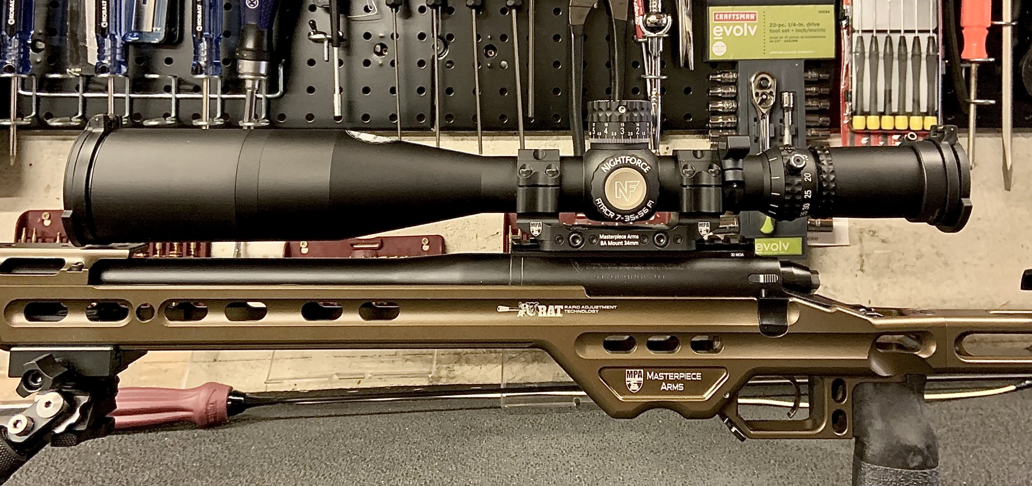

    I’ve tried several scopes. The NF 7-35x56 F1 Mil-Xt reticle has worked best for me so far. The parallax goes down to 10 meters good magnification for small targets and I really like the reticle.
    Reactions: powerspc

    I run an S&B 5-25 PMII with GenIIXR reticle. I use NF rings and DIP 25 MOA dovetail to pic rail interface
    It is a super nice setup. Perfect parallax range and enough magnification fro what I typically due (combination of steel and bullseye). Tracks like a champ and the reticle is really great for both types of the targets I shoot.

    I’m pretty simple. I’m running a zco 527 and it does just about all I need.
    If I were able to make some small changes that made it 100% Rimfire specific:
    10m parallax
    35-40 or so power (not really a big deal, but magnification is more important in Rimfire IMO).
    And a optimized parallax range from 25-300 yds. Similar to how zco and tangent theta are close to parallax free after 2-300yds.
    I find myself dialing out parallax *much* more in Rimfire than centerfire. I’m not sure if it’s possible to do. But an optimized parallax range inside 300yds would be awesome.
    Mpct2 reticle is just about perfect.
