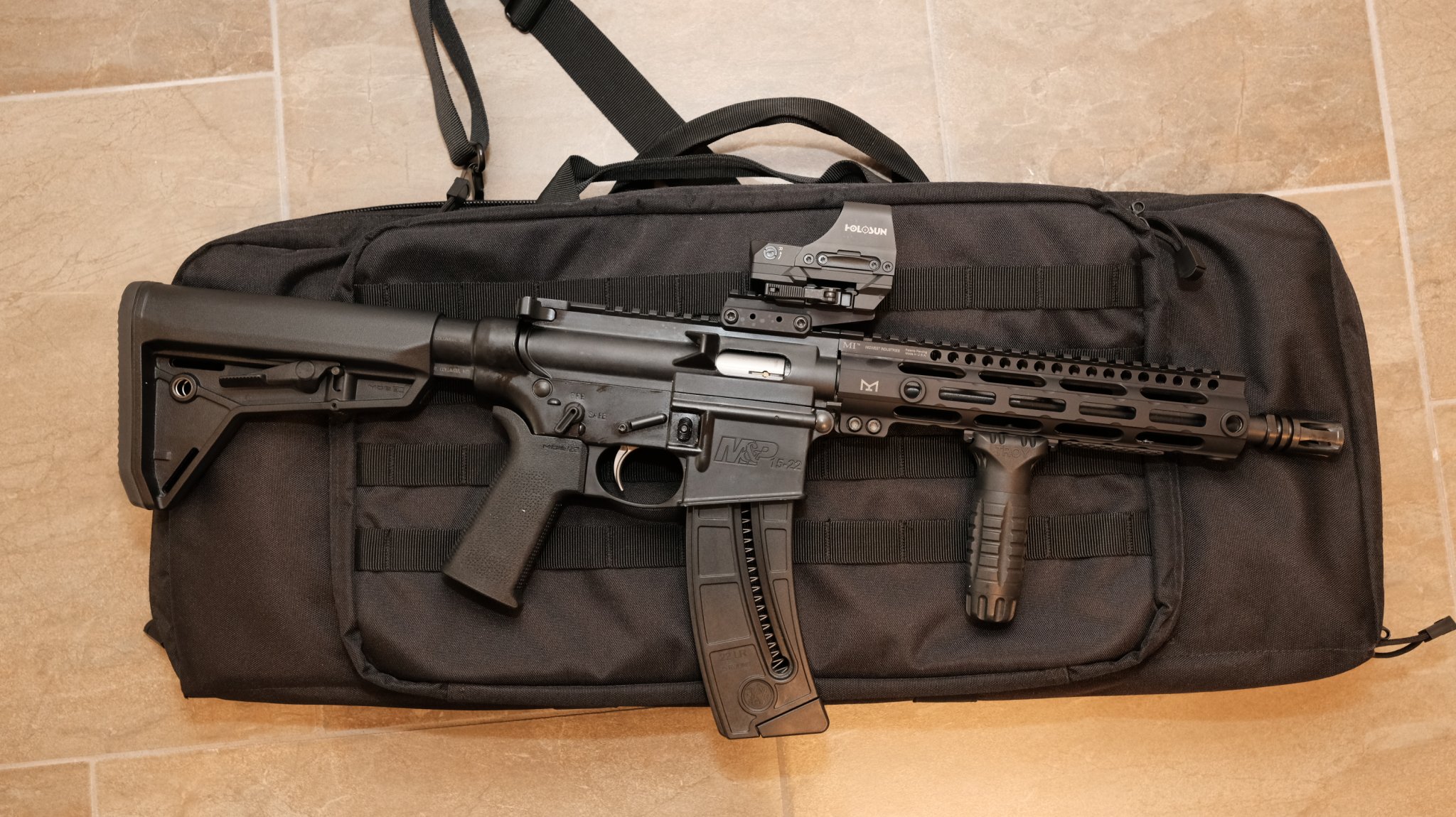

Got this MP15-22 (and SBRed it) when they first came out. It's seen many, many cases of CCI Blazer. Very reliable feeding and ejection if you DO NOT use the ammo that the manual says not to use.

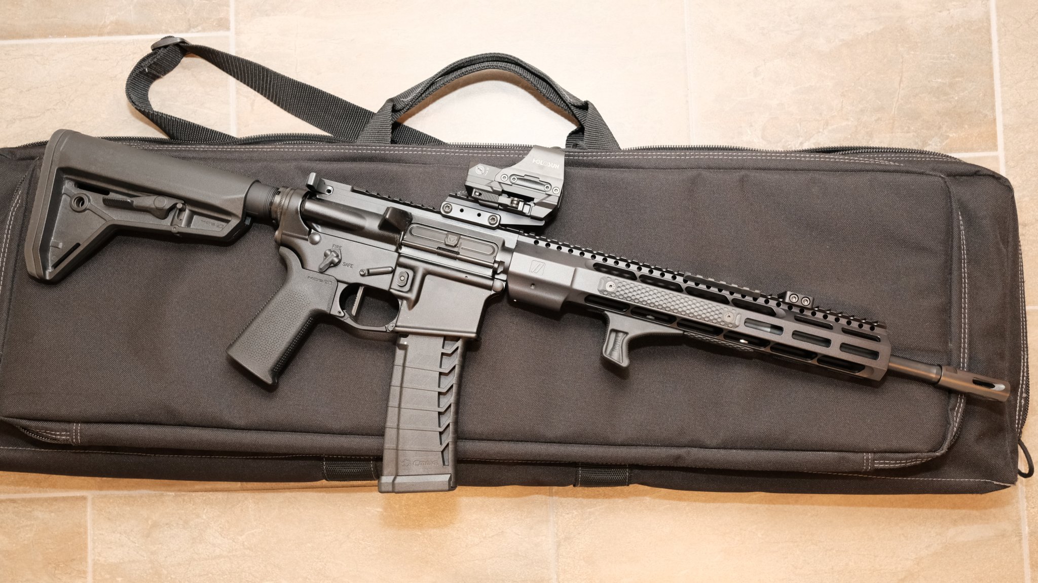

This one is a DIY built around a CMMG bolt, Catch-22 bolt catch, and a RightToBear-branded pencil barrel. It handles like a real carbine vs. the plinker that the MP feels like.
To answer your question, no, would not go with the MP15-22 as a trainer if there was an all-metal option.
Even if you went all-in on modding a MP15-22, the core is still plastic meaning that there'll be flex so you can induce misses if your technique involves muscling the gun onto target or aggresively pulling the rifle into your shoulder.
I've filled the "buffer tube" and foregrip on the MP with steel tumbling media to add some heft but it still doesn't have the real-steel-feel of the DIY gun.

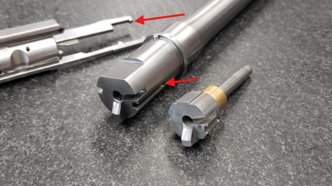

I would assume Keystone would machine in some detents for the little clip mechanism on the BCG.
Keystone has/had a vid showing how to mod the rails. In the vid, those hooks get ground off and the rails are angled to fit in the slots in their machined extension. I've always wondered what held it all together while your installing the carrier (Kriss's solution in their .22 POS was to install a set screw to retain the bolt on the carrier).
Reactions: Mark_Dorman
They don't as far as I know. That would probably lock the bolt into the upper permanently, because there's no gap between the barrel extension and the inside of the upper receiver. We ground our "claws" down smooth and it hasn't been an issue, other than the back plate wants to pop out when you separate the receivers.

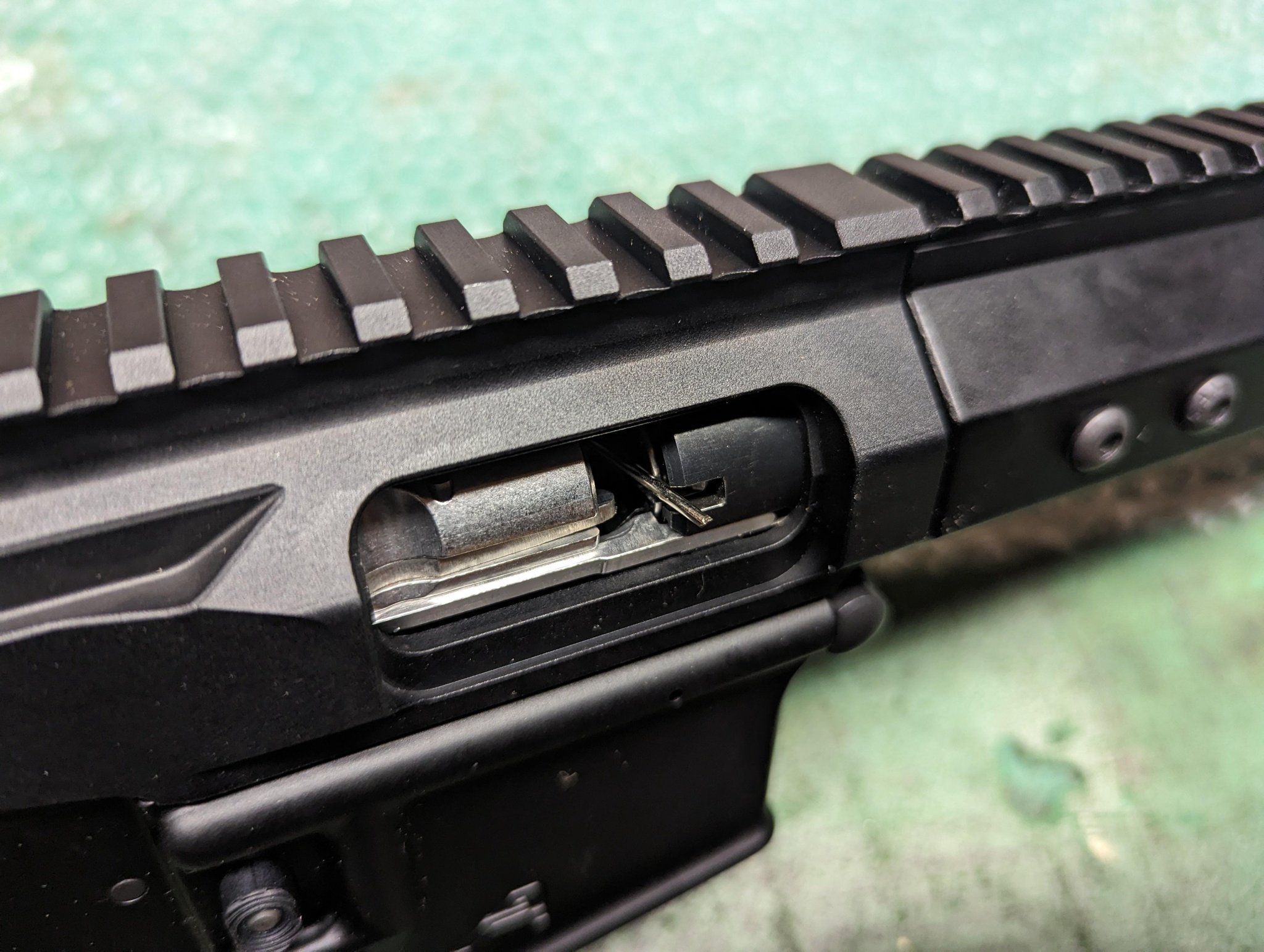

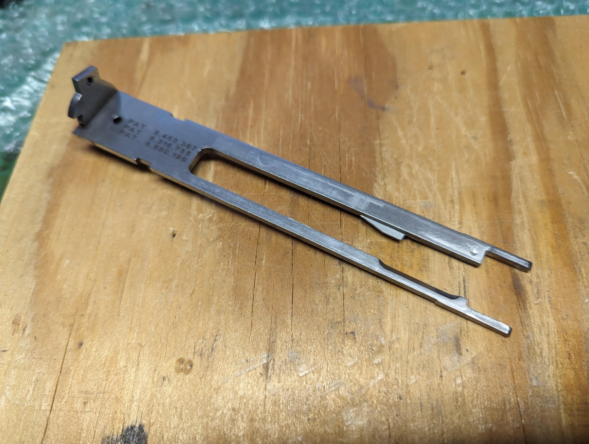

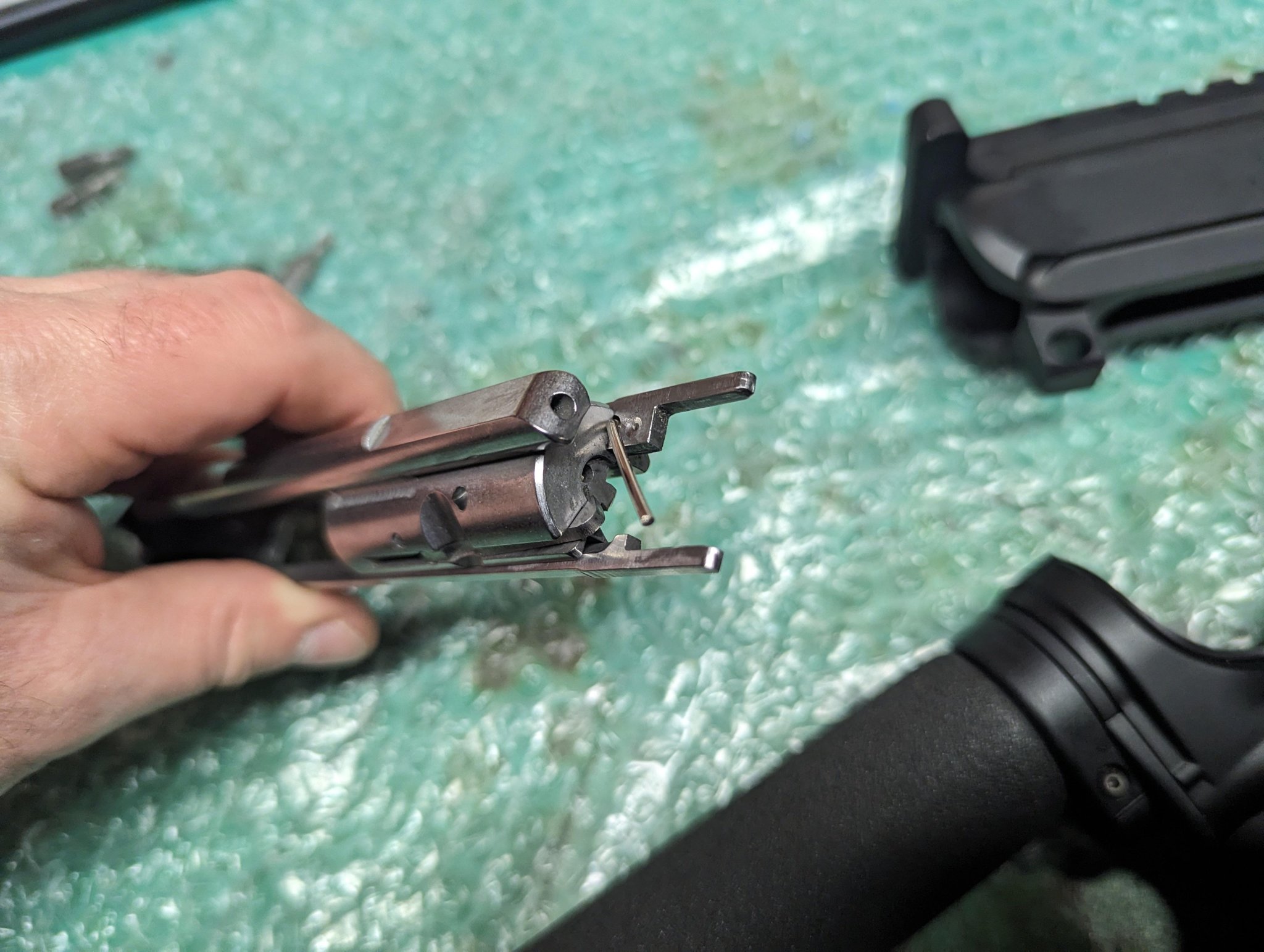

The build/bolt carrier modification is similar to what needs to be done for a KRISS barrel adapter and a CMMG (or similar) bolt mating. What I did to hold the bolt together for disassembly , is drill a 1/8" hole in the on the left side rail, and use a binder clip arm that I clipped the ends to make an "L". An allen Key trimmed up would work fine also.
When the bolt is installed in the receiver, pull back the charging handle, put the hook in, then you can pop the rear pin and pull the bolt assembly out without it flying apart. When you reassemble the bolt, pull back the bolt body, insert the hook and install in the receiver. Sometimes the handle of the hook hangs up near the extractor cut, but it's easy to move. Removing the hook is the same process as putting it in.
The hook is another thing to keep track of, but it does work.
I did have a problem drilling into the rail...FYI: if your bit isn't cutting, it's work hardening the stainless steel...stop ASAP. I ended up having one of the shop guys drill the hole for me, in a new spot...same area though.
