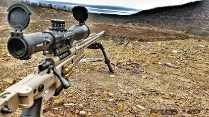

    Area 419 built my 338 Norma mag from a Defiance long action in a AX chassis and have been totally happy with it. Sticking your action in an AX chassis might give you that AI feel that you dream of...
    338 Norma is more efficient than the Lapua and as long as you get CIP length mags/chassis you can easily set them 300gr pills where they should be. The 338Norma reminds you of a 6.5x47L cartridge on steroids. That being said...If your heart is set on the 338 Lapua, by all means, go for it - it's a very great cartridge as well.
    I'm shooting 89grs of H1000 out of a 27" Hawk Hill 9.3tw and getting a 2825FPS (SD of 3) with a 300gr Berger Hybrid. No pressure...not even a flat primer and just hammers steel with authority.
