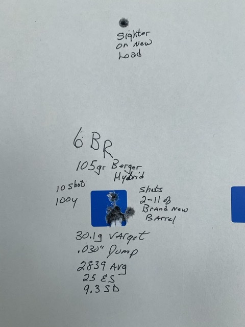

So I spun up a Bart 1:8. Decided to finish it at 28”, thinking I may get 50 or so fps more. (I can always take a couple inches off, if it’s took hard to get in/out of barricades. Since I don’t shoot suppressed, I should be fine.
Upon initial break in, I threw 30.1g of varget behind a 105 hybrid at .030” jump.
Here’s the 1st 11 rounds out of the barrel:
Since I know it’s gonna speed up a bit, I figured I run that load for the next local match, then play with it.

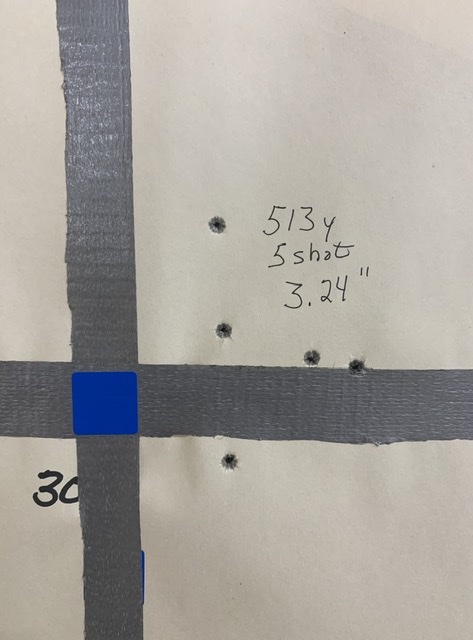

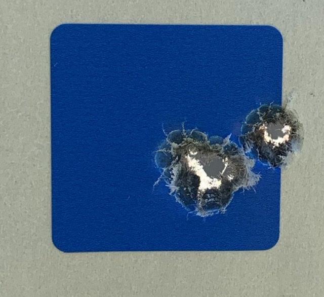

Verified zero and trued at 500 yesterday.
100y -5 rounds
513y- 5 rounds (mirage was high with 3mph L-R wind)
