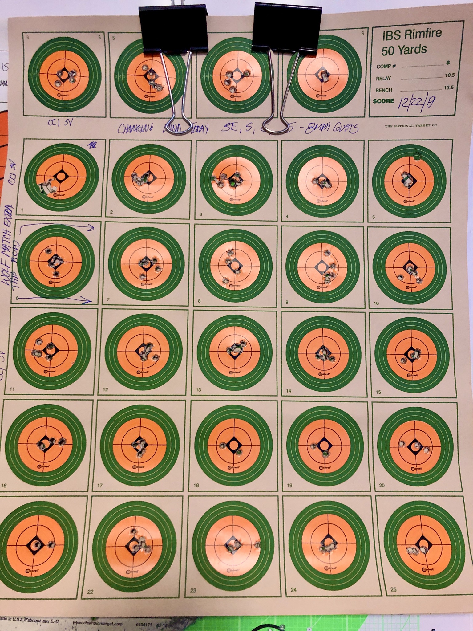

Wanna open the rimfire can o' worms a little farther? Cold weather. I shot a match yesterday where temperature was around freezing at the start and never got much above 40. In preparation for this, I tested Lapua Center-X against Lapua Polar Biathlon in a similar temp range. At 40-45 degrees F., the Center-X was showing about 1065fps, down almost 15fps from temps above 65. The Polar Biathlon gave me 1103fps at 40-45 degrees. Accuracy was identical - same bullet/lube in both as far as I know. Hmmm......
Edit: My point was not made at all... which is, CCI SV and similar can be bought cheap and can work very well for practice (my major weakness by far is moving to and getting stable in position quickly and smoothly, not marksmanship per se), but better-quality ammo is going to get you better accuracy, especially at extended range.
I have been using CCI SV with my CZ457 VPT Manners lately with results I am good with in practice. Today at the range the wind shifted from 4 different direction at 50 yards. Additionally I made some basic mistakes that also compounded my accuracy.
Interesting to note I used Wolf Match Extra on one row, where the wind slightly subsided, and the hits were not as I thought they should be. At the end of my target shooting CCI SV were most consistent $3.69
