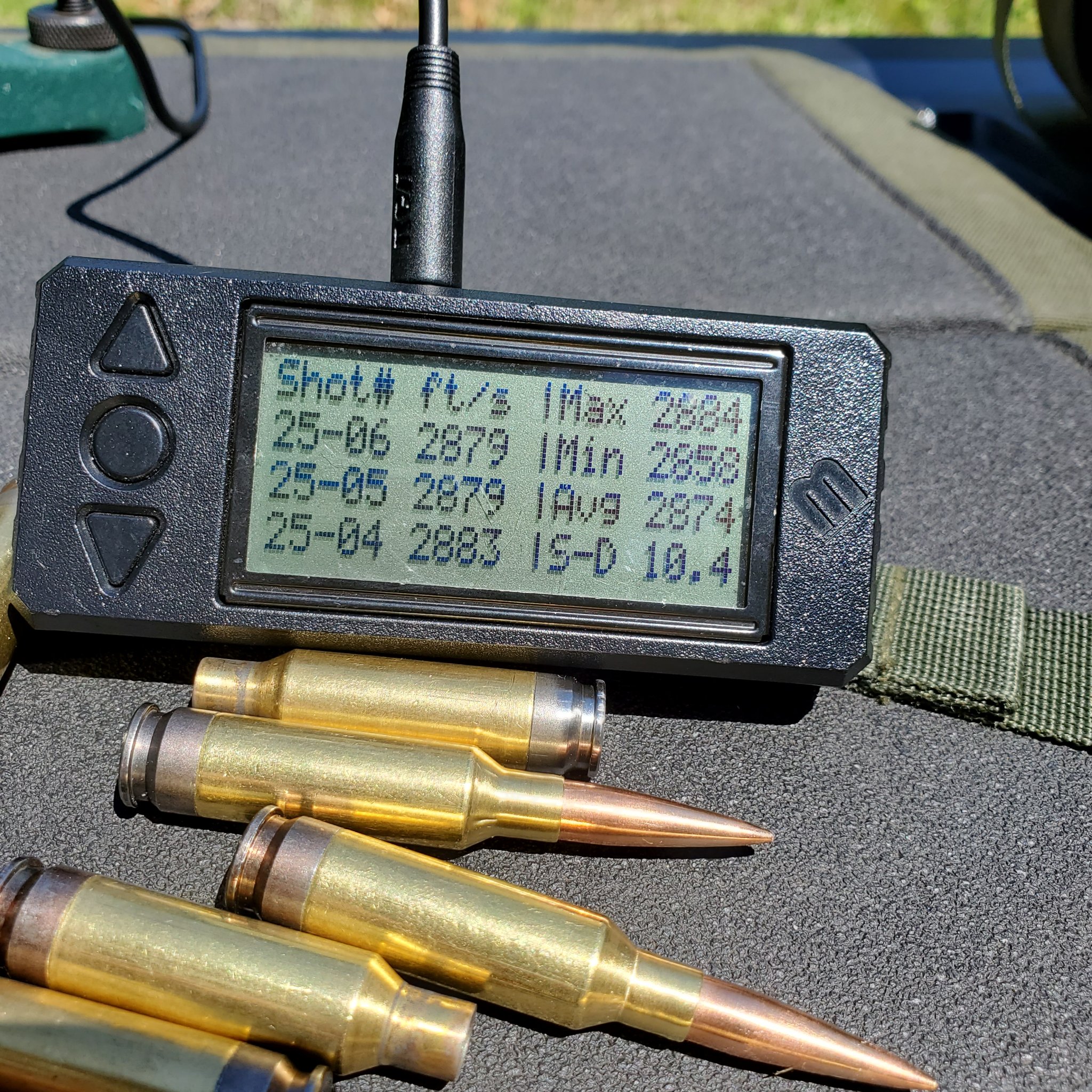

I use Remington 700 actions. Tons of aftermarket stocks, triggers, and magazine styles to choose from. Fairly cheap and accurate.
Perfect for the 308, 9 twist Bartlein, Rem Varmit contour, 22" to 24" barrel. I chose 22"
Stock of your choice, or alum chasis and center feed mags for 2.990" long cartridges.
Or real performance go with a R 700 LA 8 twist Bartlein 30" barrel heavy palma contour, center feed chasis 3.4" cartridges out of the mag...
2860 fps with 200 gr .715 bc bullets. Or 230 gr Atip 2620 fps. Even the 250 Atips are on the table.
Lots of improvement to be had with the 308 case, over 3600 ft/lbs of muzzle energy with brass cases and over 4000 ft/lbs with hybrid cases in the 30" barrel.
Dial the weight you intend to carry and the performance you desire.
308 Win case 200 SMK .715 bc 2874 fps ave, good load, easy to attain with hybrid cases.
1400 yds no problem, even with 155s back in 2003.
Modernize it or not the 308 Win is still capable of excellent performance.
