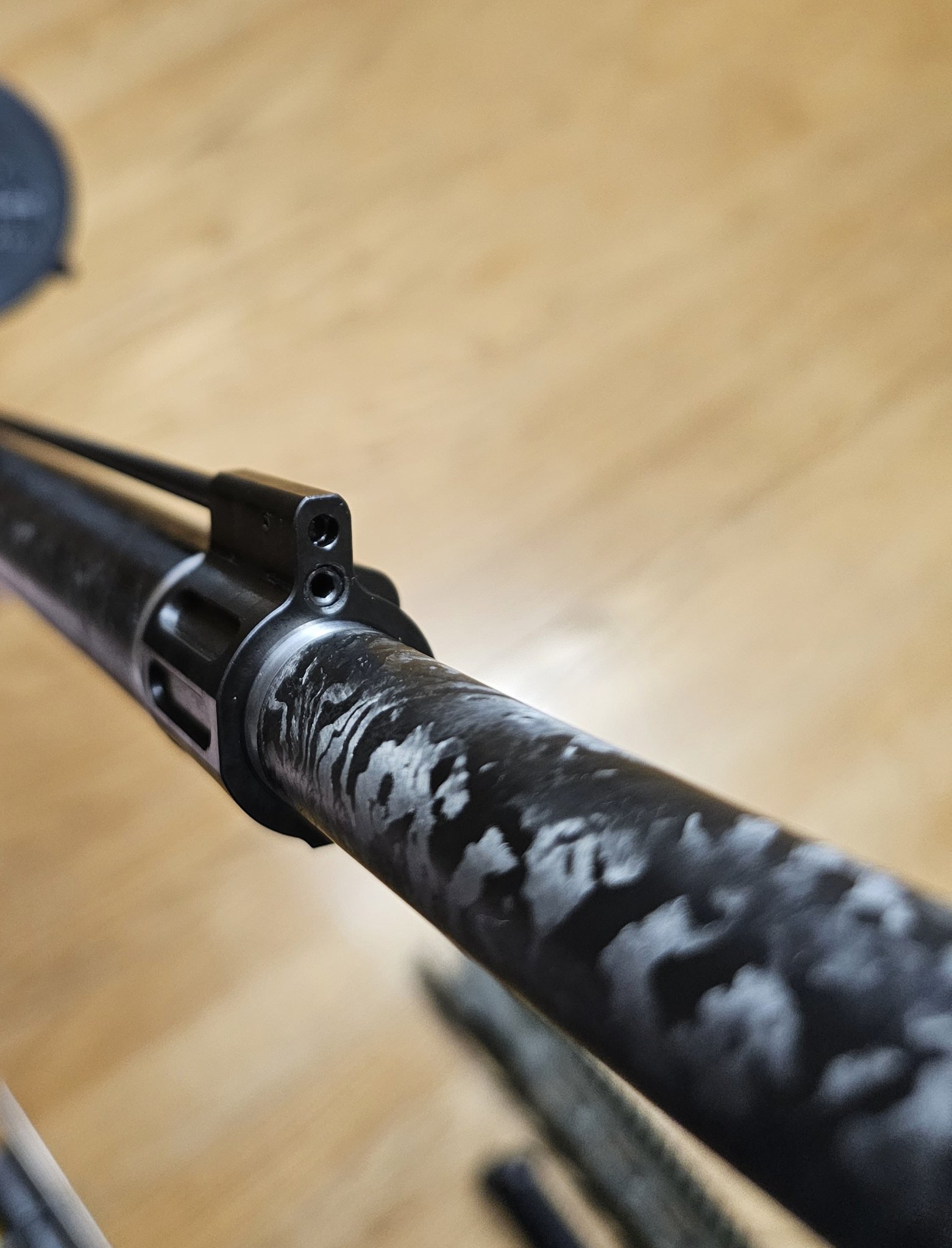

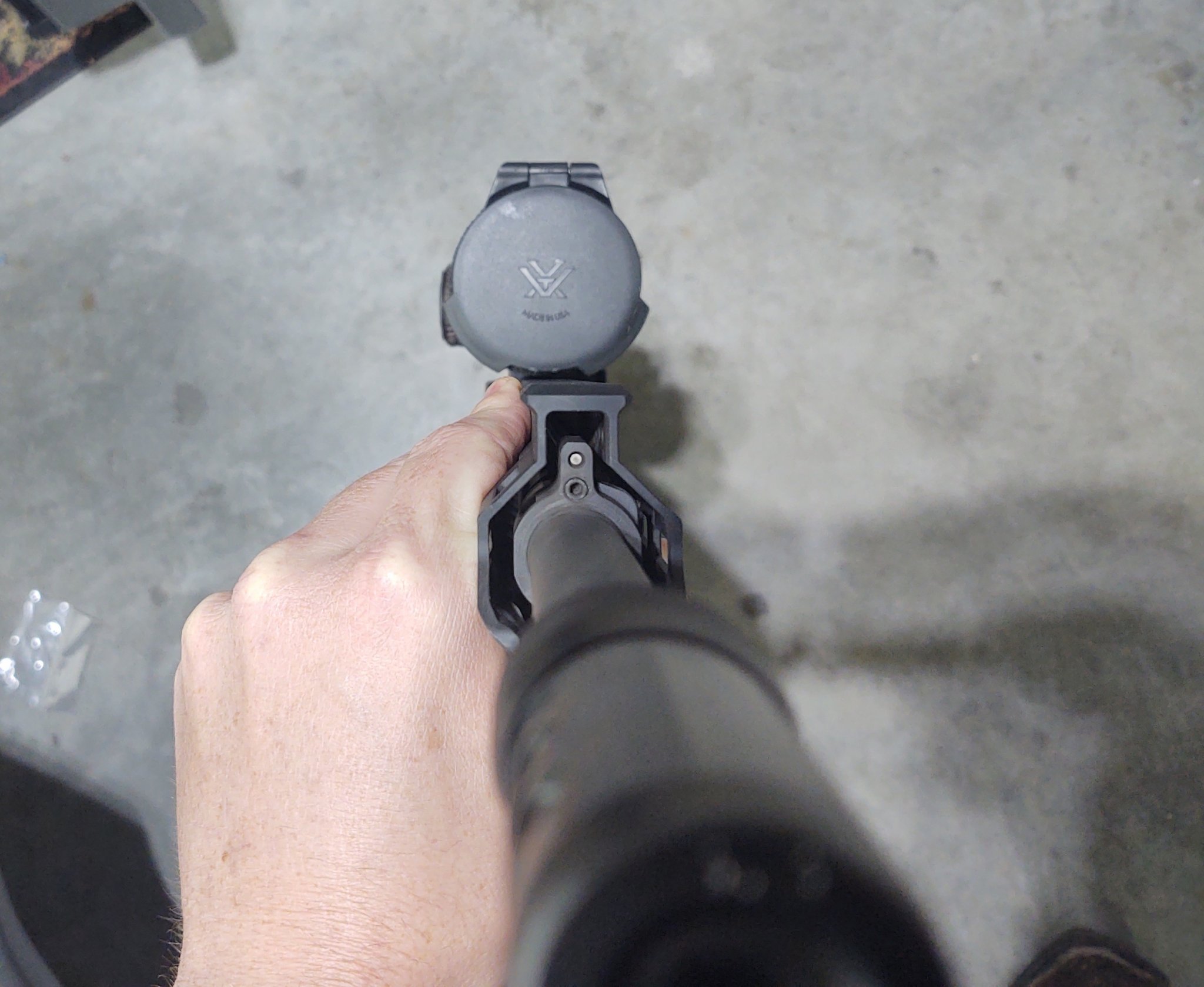

The problem with most of the adjustable gas blocks is the side projection(s) on the blocks. The SLIM rail has "scalloping" inside the handguard at 1-4-7-11-O'Clock. I just pulled the trigger on one of Daniel Defense's 15" MFR MLok rails. It looks to be the same, if not very similar to BigJake83's post. In the picture, there is no intrusion into the barrel channel inside the handguard. And I purchased 3-4 different blocks to see which fits best. It's for a JP Enterprises upper in 6 ARC mated to a DDm4V7 lower. I initially wanted to use the spare DD Slim rail I had, but now don't GAS. I just want the gun to shoot suppressed & unsuppressed. Everything arrives today.
