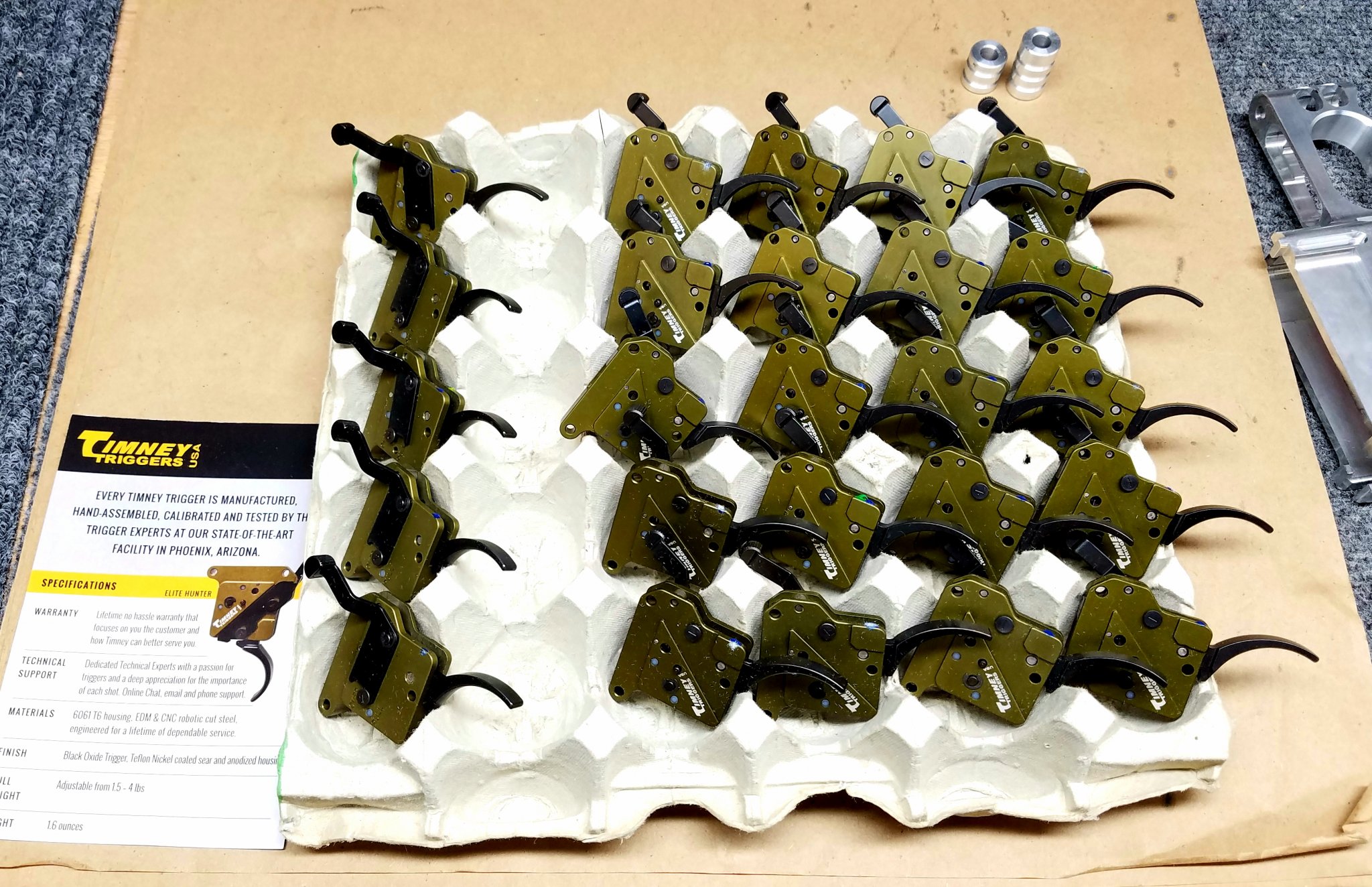

I have been using the Timney 510 and 511s in all duty rifles being shipped out for the last few years. The new 510-V2 is even better. If you are wanting competition (light) pull weights, check out their new HIT.
The 510s have a very simple internal geometry, minimal number of interacting parts and a housing that has a minimal amount of openings for crap to get into. The V2s still have these same attributes.
This is part of the last batch of Timneys after unpacking at the shop.
Reactions: cruze5 and Rob01

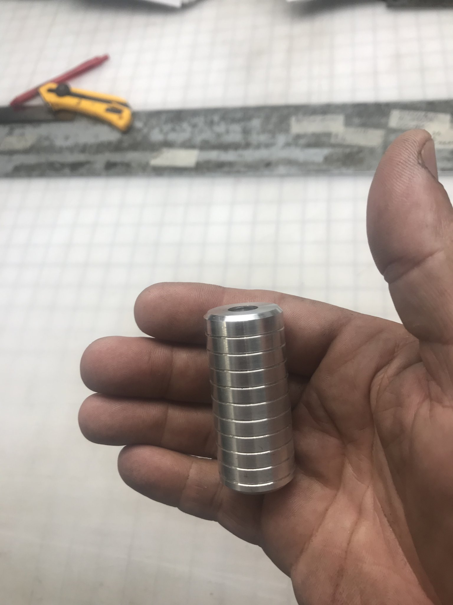

The small washer and hex screw are to hold back the cocking piece for disassembly. The large washer is to pull back the firing pin spring and castle washer so you can adjust the castle nut to disassemble or set firing pin protrusion through the bolt face.
ARC actions are shipped in shipping grease; I’d recommend cleaning/degreasing, and adding new grease to the cocking ramps, bolt lug backs, bolt shroud detent pin, and extractor/bolt interfaces.
This!
I made this for the striker spring as it much nicer than the big washer.
