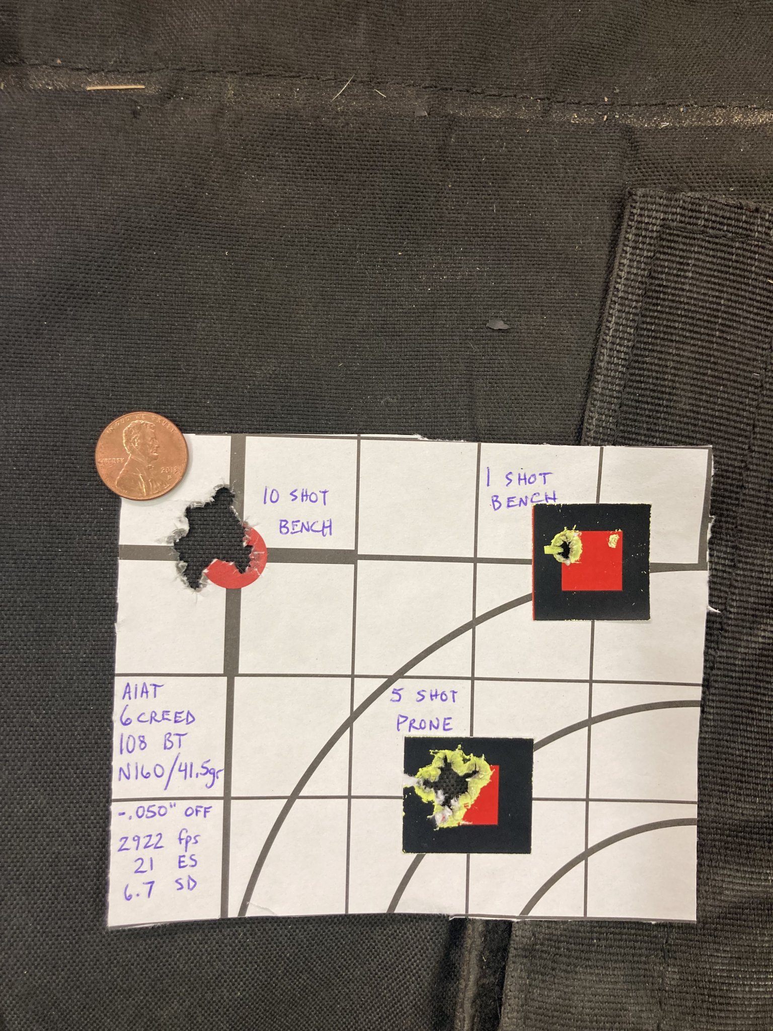

The most recent barrel i put on a rifle a couple months ago...i happened to verify in 2 positions while zeroing...shot 10 off the bench, then 5 prone...had 1 round left so shot it from standing behind the bench...good to go
