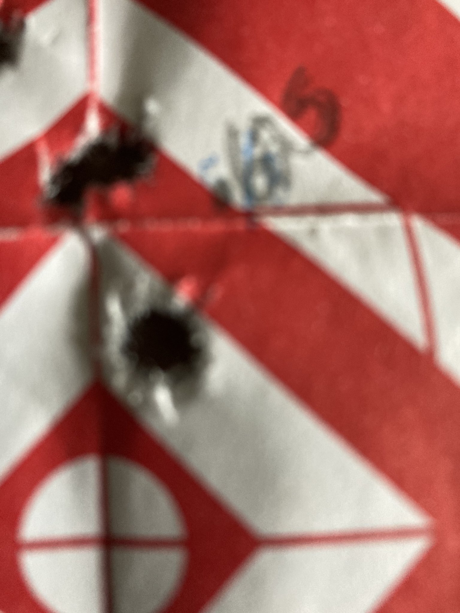

The first target - and these are not necessarily cherry picked but fairly representative of what I get with this load
First target is 43.3 Varget - yes only 3 shot group for this one as the first 2 with this ladder were my spotters . But 3 into .625 and the first shot is the low flyer .

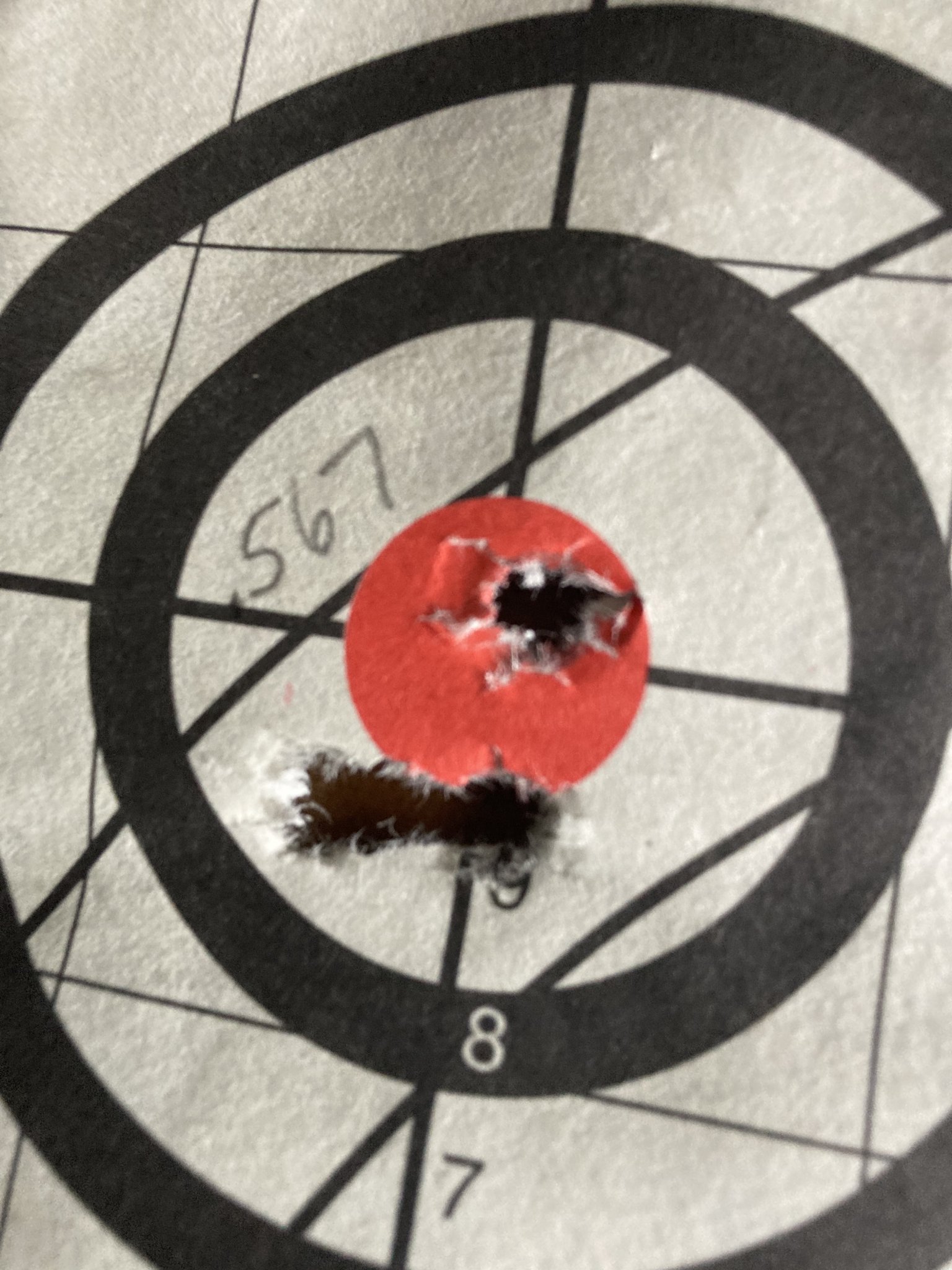

Second target is a 5 shot group for all you purists . 43.5 Varget. First round is again the flyer and about the same amount high this time .
100 yard range - bench with bipod and rear bag. Trying to use all the skills I e learned here and through regular trigger time .

That's a great group for a Frankengasser. It is a known phenomena for gassers to have a first round flyer (not always). The theory is that the first round is loaded into the chamber differently from the rest because of action speed, etc.

I guess no real problem, but I’ve seen some lots actually of those little bug hole groups here at at the range and I was wondering why - any way to remedy that first shot high or low flyer I’ve seemed to be cursed with.

OP: I had a .223 wylde barrel that would exhibit similar once. Turned out there was a little burr around the gas port that would sometimes cause a couple shots to be way off. Random, yes. And probably not the cause for everyone, but a statistic nonetheless.

The second group is a 5 . As stated I’d only loaded a few of each node from before and restarted the project this winter . I went to the range with like 16 rounds . And had to sight in a new optic and then did 2 spotters at 100 before shooting those two groups .
