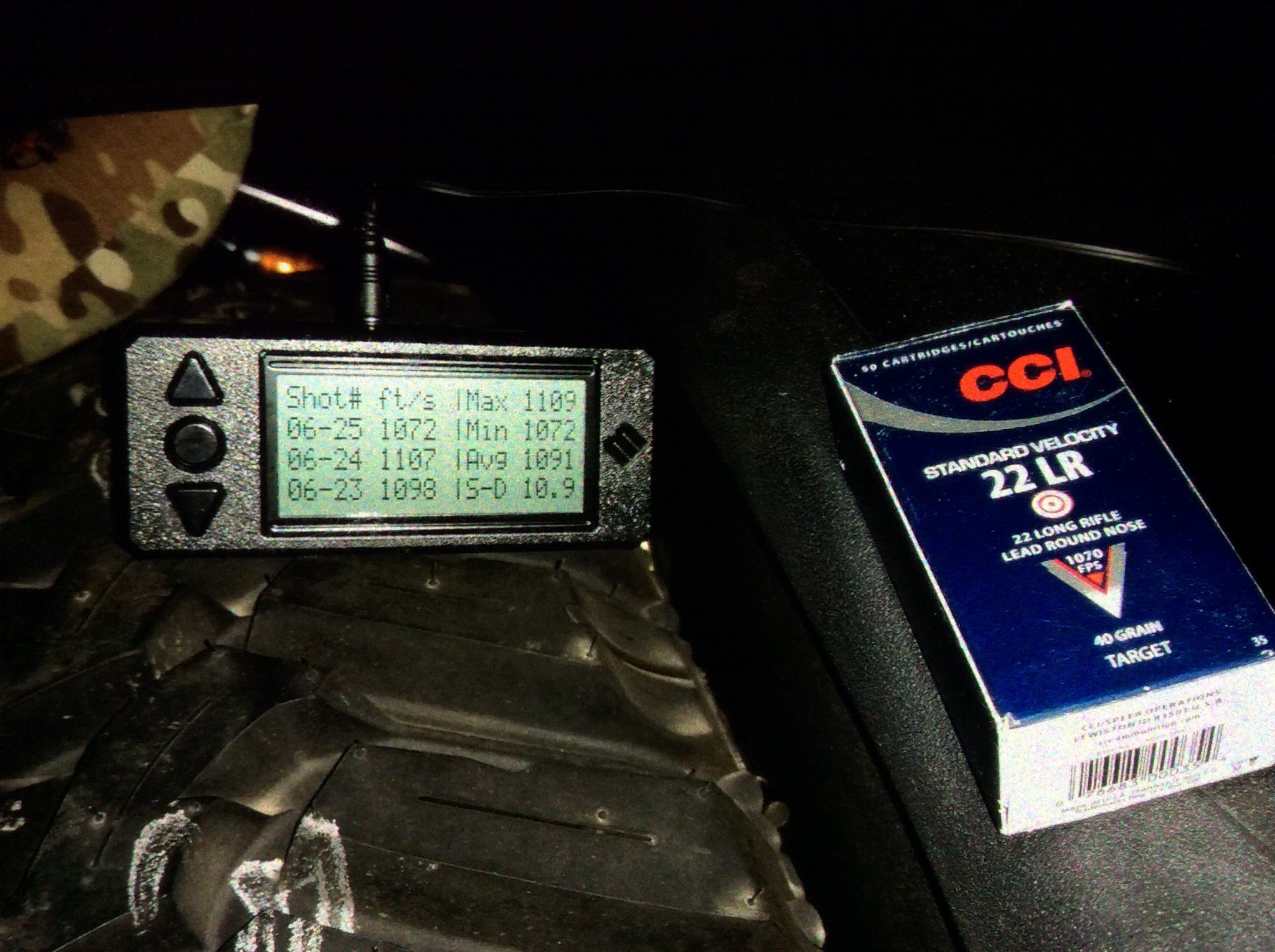

Thanks for the info. I will make sure to attach chrono data from my V3. I was surprised at how consistent CCI SV was in my CZ.
25 shots
Max: 1109
Min: 1072
Avg: 1091
ES: 37
S-D: 10.9
I’m sure there is better out there, I was just surprised I didn’t get a wider spread.
I was surprised at how consistent CCI SV was...
ES: 37
That seems better than I thought it would be, too, not a ton more than the Tenex numbers Justin posted in the pic above.
But, the way I understand it, ES of 37 would still account for almost 4” of vertical dispersion at 200y based on velocity alone.
I’m gonna have to invest in a chronograph; that’s pretty interesting...

Added chrono photo on the CCI Sv. Stamper,you speak the truth. After shooting this ammo at 50 and 100 I went back and bought everything I could find from the same place. Ended up getting some of the same lot and about 7 from a different lot. Totally different results. Rim fire lot numbers mean so much more than centerfire in my opinion.
Also, thanks for the information on the bullets and lube.

CCI 0035 seems like it is really pretty decent field ammo (it is) until 225. At 225, it goes from maybe 2-3 MOA to hell and gone.

I came up with my own conclusion based on the information provided.
It's rimfire and the manufacturing process allows variations in quality and assembly of the components.
Quality control and the testing/sampling done at the factory determines the labeling.
What if the portion of the batch sampled and tested shows excellent results
but the remainder had a hiccup during the rest of the run, you won't know until you shoot it.
It may be labeled X-Act, but it produces trajectories like CCI SV.
A slight misalignment in the bullet seating, brass dimensions or a tiny blockage in the primer feed
can cause mv's to spread and trajectories to wander off on undesired tangents.
A company representative can't say that, it's not in the job description.
On the other side of the coin, what happens if the factory sampling shows poorer results?
It gets labeled as midgrade ammunition and sold at much cheaper prices.
But when you get your hands on it, it turns out that the factory tested the wrong portion of the batch.
That's when you have lot numbers of CenterX that are better than all the other Lapua offerings.
Same thing happens with the RWS and Eley brands.
Match ammunition is the best produced by the factory, as tested at the factory.
It gets boxed, labeled and sold as the best offered by the brand.
Further testing by the purchaser decides if it really is match ammo
or just expensive practice ammunition.
