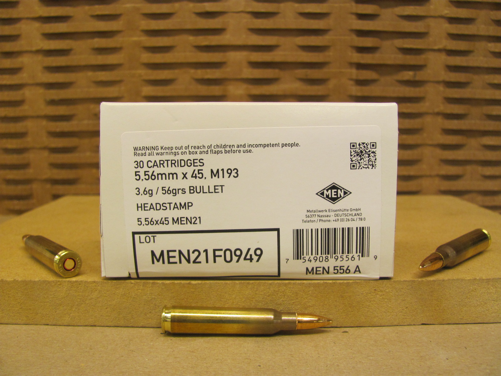

Getting an AR put together and wondering what ammo and barrel twist is best. Leaning towards 1000 rounds of some type of M193 ammo. Please advise.
1:7 twist. And as far as which M193 to pick....
M193 is M193 is M193 is supposed to be a 55gr 5.56x45mm NATO spec made to run at a certain pressure/velocity spec no matter the manufacturer; as long as they follow the specs. IMI, Federal, Winchester, MEN, Norma, PPU, CBC, Wolf Gold, PMC, whatever.
Winchester white box 223Rem 55gr does not run as fast as Winchester M193. Both will reliably function in your rifle.

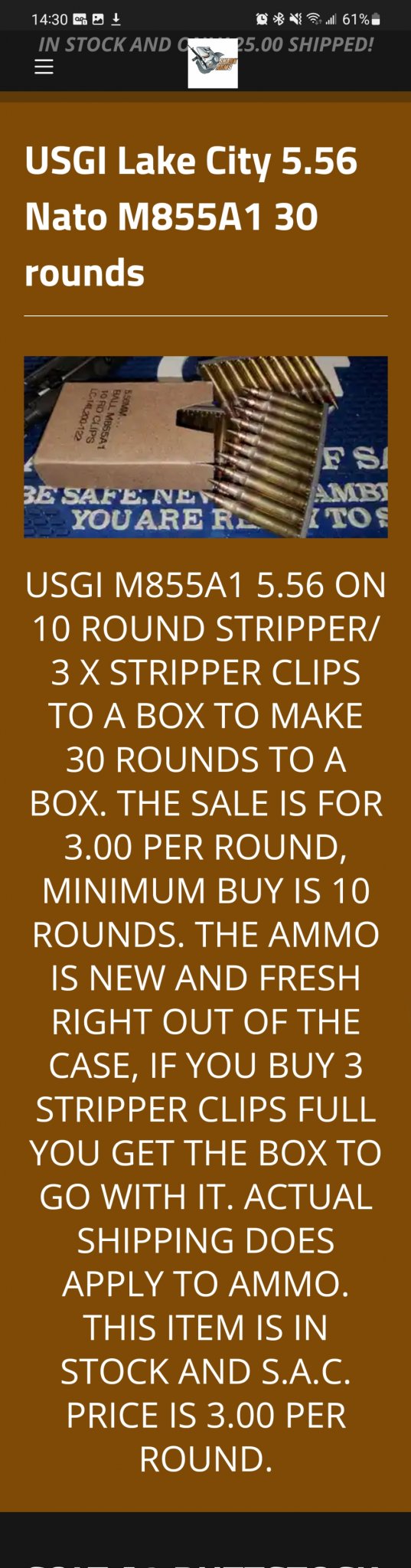

Good luck getting 855A1. If you find it, it’ll be >$2/round. It is radically different than ancient M855. I’m sitting on ~2K rounds of it. It likes to punch holes in 1/2” AR500 plates at 100-yards. Regular 855 just leaves a modest divot.
