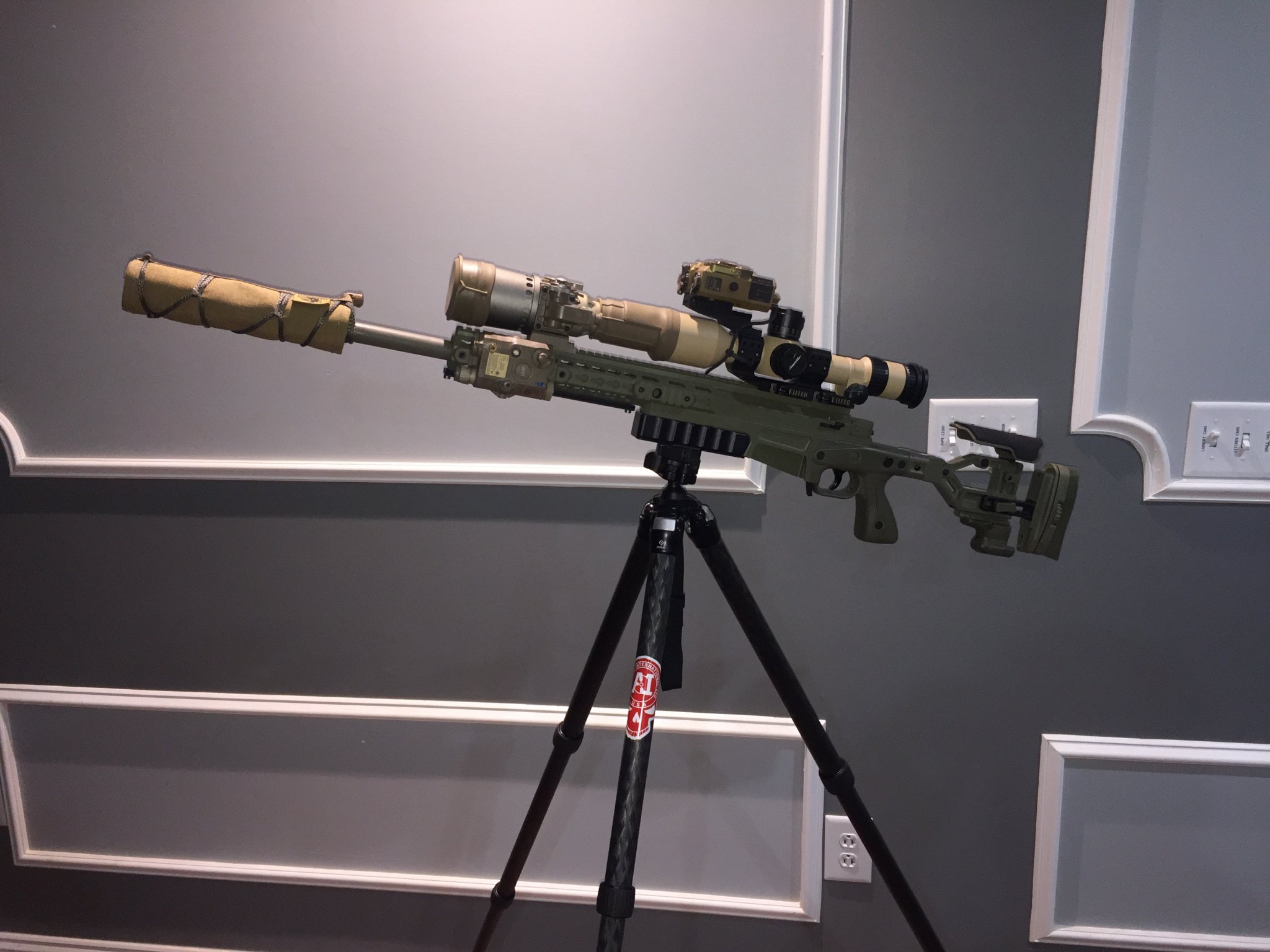

From what I've seen now sturdy quality build, and seriously stable platform while providing smooth movement when unlocked, also the lever release is quicker than the arrest knobs. My question though do the platform bases provide anything when the Anvil 30 is paired with a non RRS tripod ?

It pays to read all before posting, my search had brought up the BH30 not the Anvil 30 as I had clarified after being shown the error by other Hide members. Had you read on you would have seen this too, so to both of us "attention to detail!" Nice set up, however.
