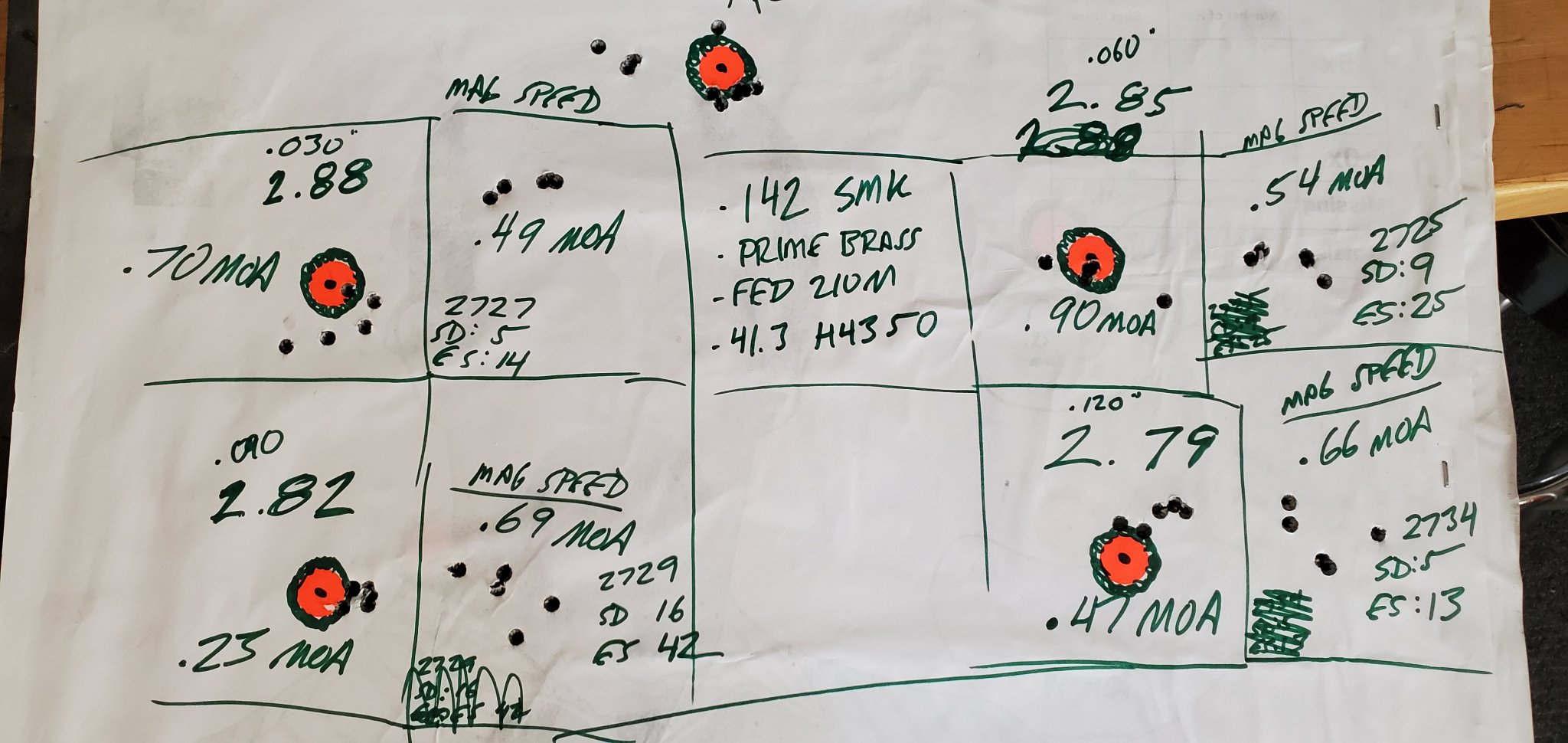

I regularly make 1/2-3/4 Moa or better Ammo on my progressive press with Lee dies without being too OCD about things.
This was at 200 yards when I was doing a seating depth test:
Here's the thread I started when I needed some assistance with seating depth:

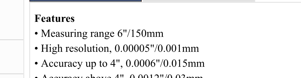

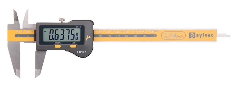

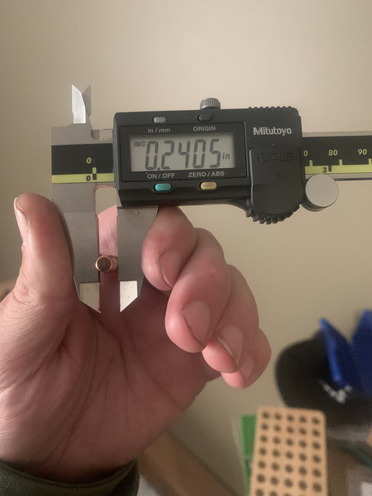

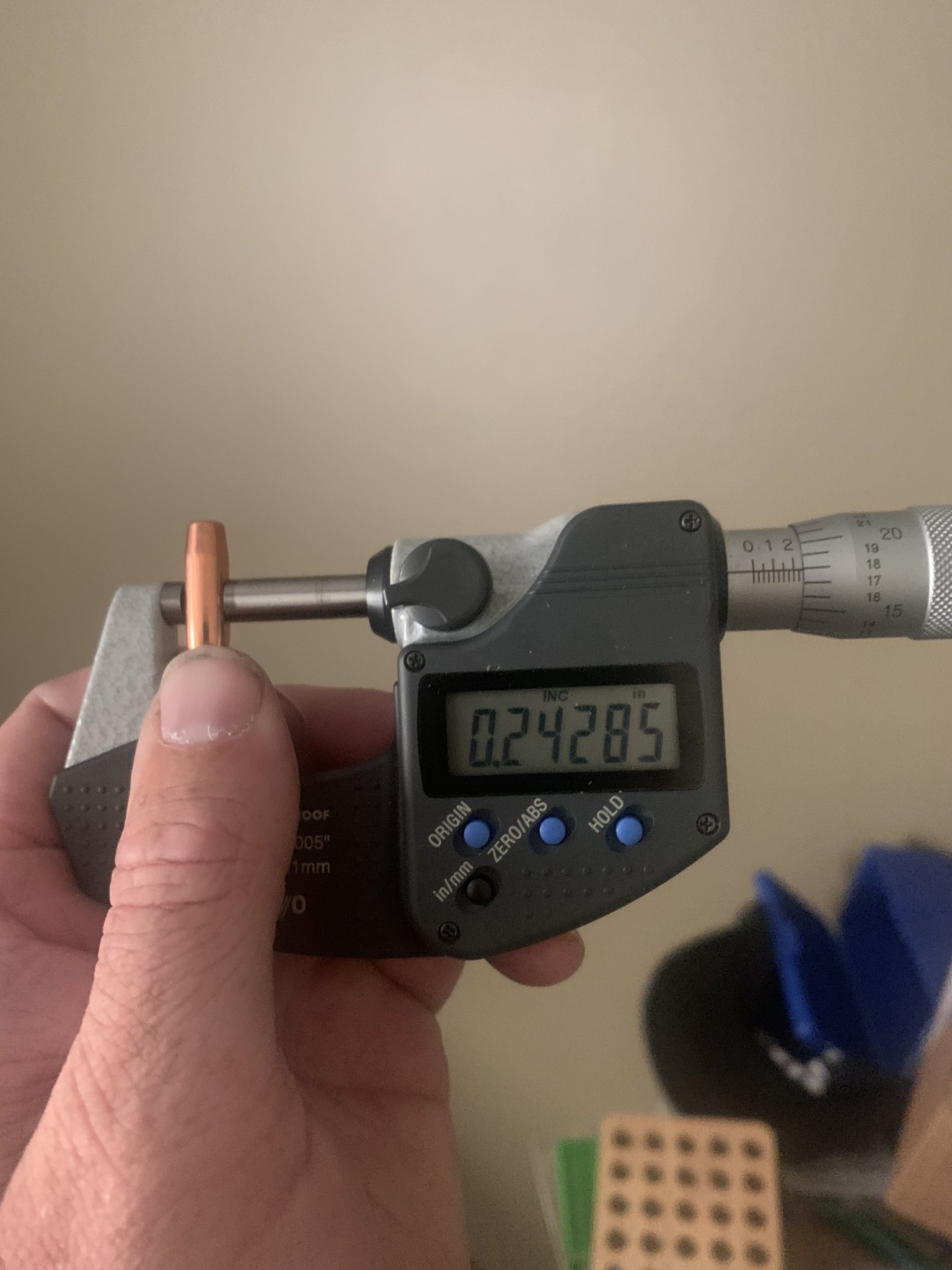

I'd like to know what lasers you're using to accurately measure to half a tenth. Your measuring equipment has greater tolerances than your ammo specs.
Lol.
I'd like to know what lasers you're using to accurately measure to half a tenth. You measure equipment has greater tolerances than your ammo specs.
Yeah.... primer pocket depth and neck wall thickness to 2 tenths or less. I didn't even know that was a thing people measured.
A caliper is accurate to +/-.002”. Doesn’t matter if it’s Vernier, dial, or digital. It doesn’t matter that it displays to half a thou.
A micrometer is accurate to +/-.0002”. Doesn’t matter if it’s Vernier, or digital. It doesn’t matter that it displays to half a tenth. Tools that can get better than that are many orders of magnitude more expensive, and you’re not doing it outside of a temperature controlled inspection facility. Especially not in something with the expansion rate of brass.
You are not accurately checking to half a tenth in your garage at your reloading bench with a Harbour Freight caliper and micrometer set.

If you’re using a caliper for all your measures of size, the best you can hope for is +/-.002”.
Here’s an example of the typical “gold standard” caliper for reloaders. It’s not a stupid expensive set, but you’ll see them on most serious loader’s bench.
It was checked with a .5” gauge block. So were the outside micrometers. Both the mic and calipers read 0.5000 exactly.
And here they are measuring the same .243/6mm bullet immediately after:

You can spend an inordinate amount of time finding the perfect load vs a good one and shooting more. It depends on what interests you.
So, here is my process which yields sub 20 ES and sub 10 sd consistently. Along with load development method:
(new brass)
Run in sizing mandrel for turning
Trim to uniform length
Neck turn on lathe (.005-.006 neck clearance)
Size under where I want to be
Experiment with mandrel until I get .002 tension
Use pin gauge (.241 for a 6mm) to spot check tension
Lube inside of brass (gives consistent friction for seating)
Use hydro press to seat and cull any outliers on seating pressure
Load development:
Groups of 3 or 5 at .3 increments
Shoot over chronograph only (no groups).
Pick node with the most consistent and acceptable ES. Load in the middle of that node
Load that charge in 3 shot groups starting at .005 jump in .003 increments to .040 or .050 area.
Shoot groups (no chrono) and find seating depth node. Use the long side of node to account for throat erosion.
Load 5 shot groups in .1 increments across a 1 grain spread (.5 each side of the node you just loaded) and shoot over chrono (no groups). Find your “micro node” inside your node and pick the middle of it.
Now load a bunch of that charge with the chosen seating depth. Shoot 3 shot groups and use barrel tuner to tighten group up as much as possible.
Done
