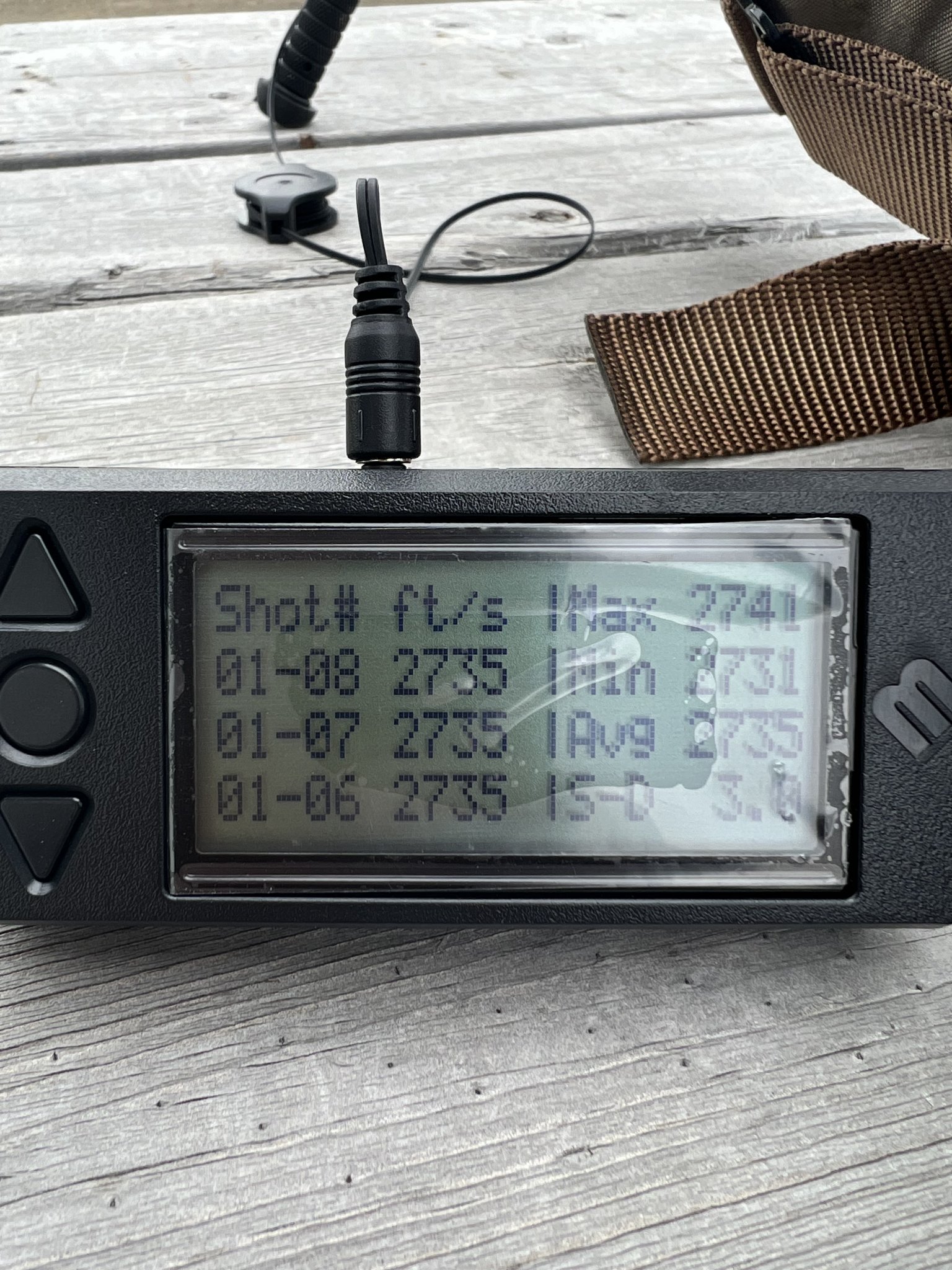

338 Norma is a sweetheart IMO a much better cartridge than 338 Lapua. I was in the same place as you. Tried the 338 lapua, then tried 300 nNorma,finally settled on the 338 Norma. Much like 6.5 x 47 Lapue, it's just easy to load to for. All my groups were sub MOA and fairly consistent speed wise.
See my load data with 88.5 gr of N570 behind a 300 gr Berger OTM
2735 fps is still a constant.
This is my first round hit gun regardless of distance.
