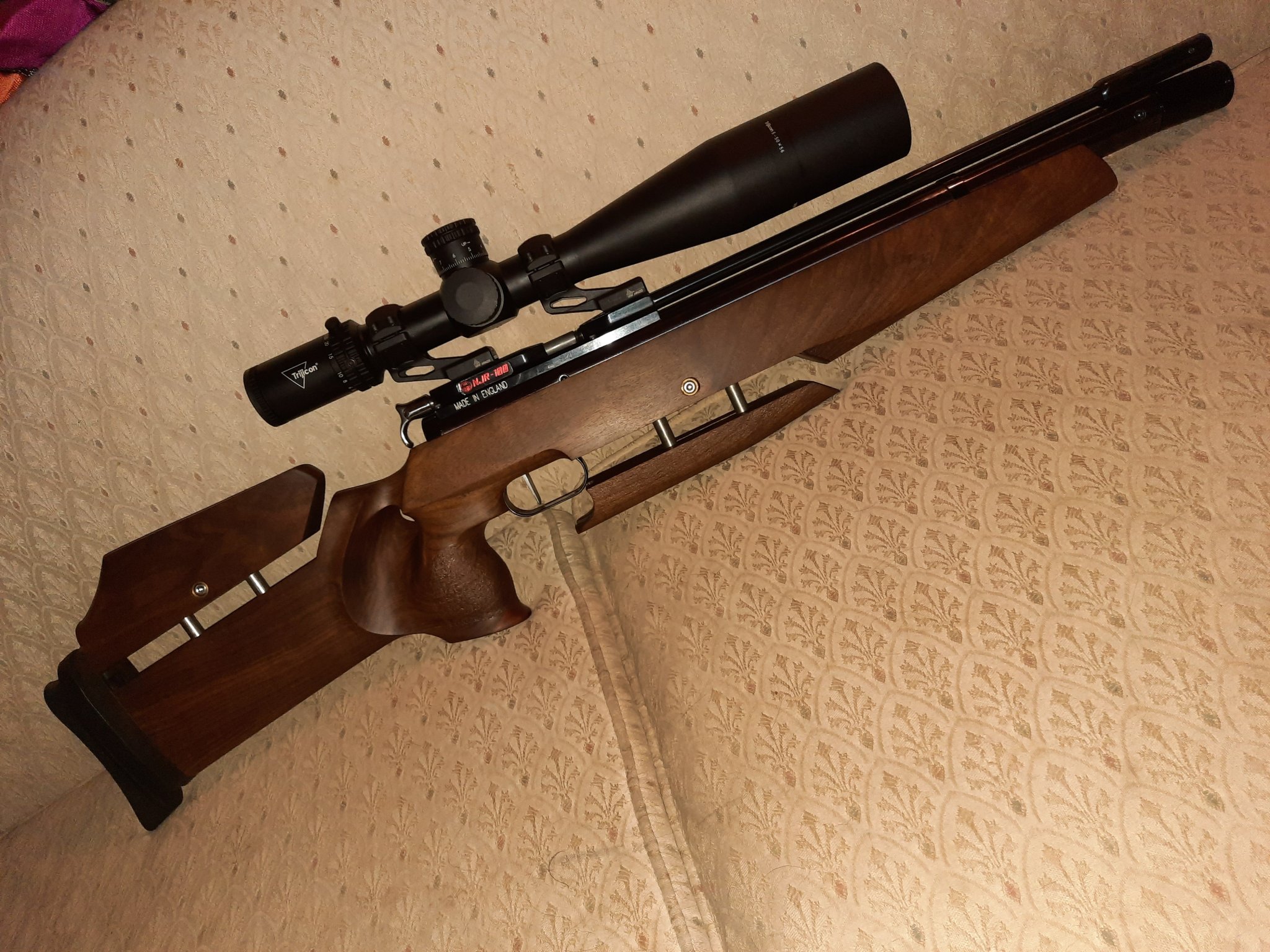

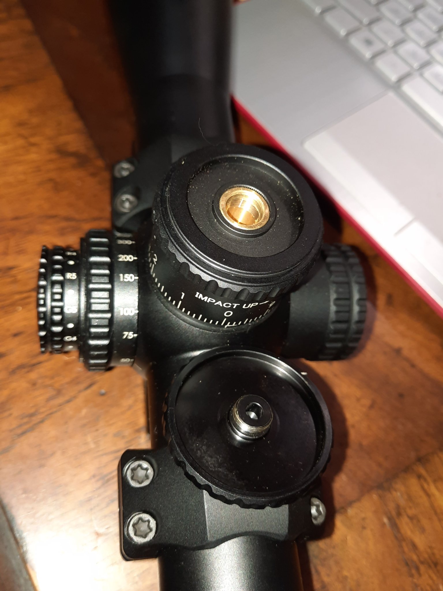

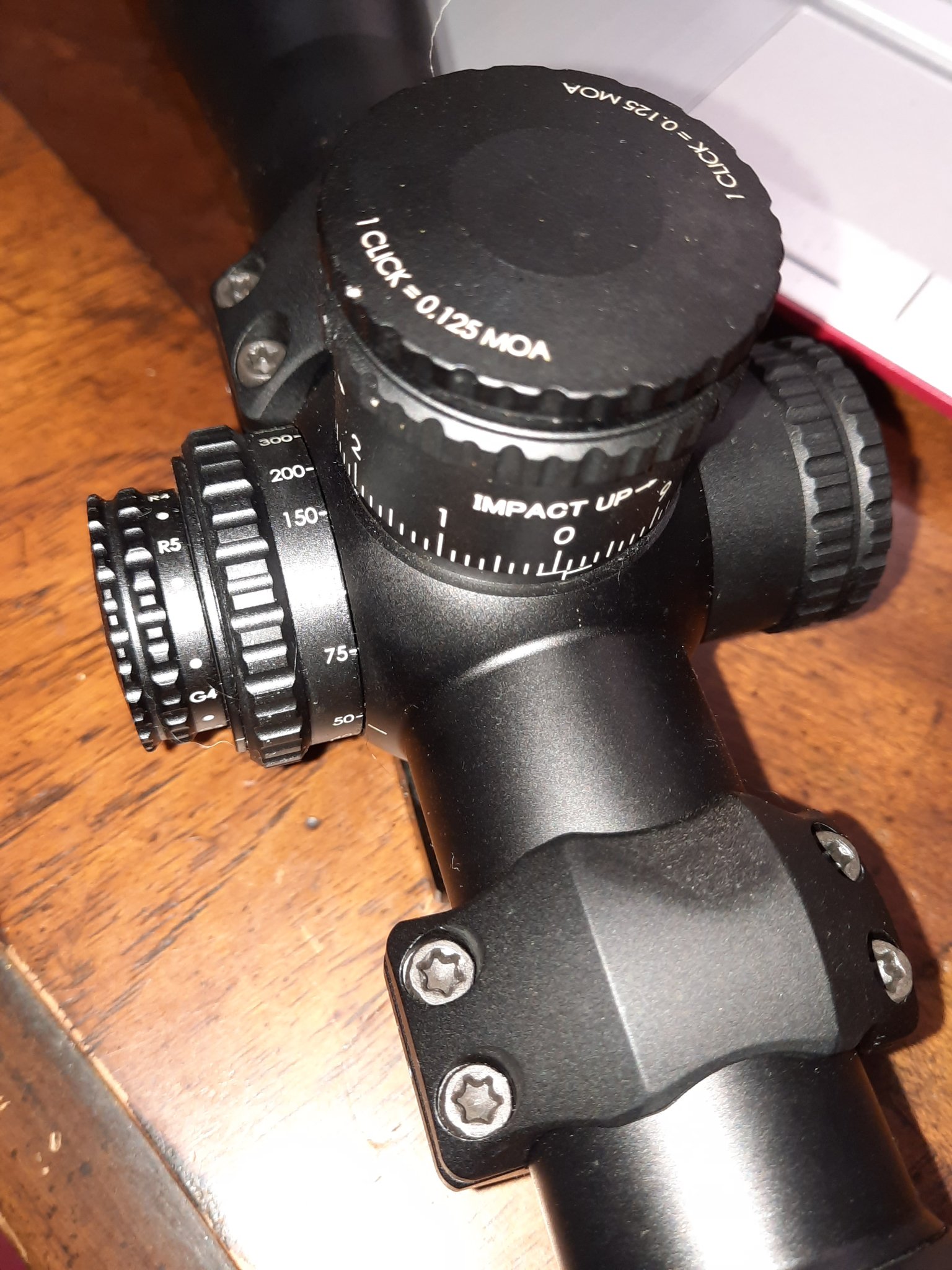

Although I only shoot at home and haven't competed since the mid 90s, I use my Trijicon 5-5x56 scopes.
They are 1/8 MOA clicks which is a must have for me, they focus down to about 9 yards and the hi power and parallax
allows me to use them as range estimators.
When the object is in focus, I look at my oversize parallax wheel for the yardage that I have marked on it and then adjust
for elevation using my DOPE card. At 40X the reticle is at a 1:1 ratio and works great for quick hold over or windage.
Sometimes I use the reticle but most often I use the turret for elevation. I always use hold over for windage.
I love the tool-less, zero feature. My normal zero is 50 yards and I set my zero stop 5 MOA lower than that for closer
targets. In that way, I don't risk getting lost with my up / down. It's not difficult to do if your shooting 10 / 100 yards and
constantly spinning the turret between lanes.
I need to see and evaluate things before and during the shot, not to evaluate things afterwards.
I use them for all of my accuracy testing..... even on my average rifles. See last photo. LoL
B&H photo will allow you to test drive them on your gun for a month and will take them back if your not happy.
With that kind of offer, I could not pass it up. Bought the second one a few months later. I wanted to try a March
8-80 but they stopped making them.

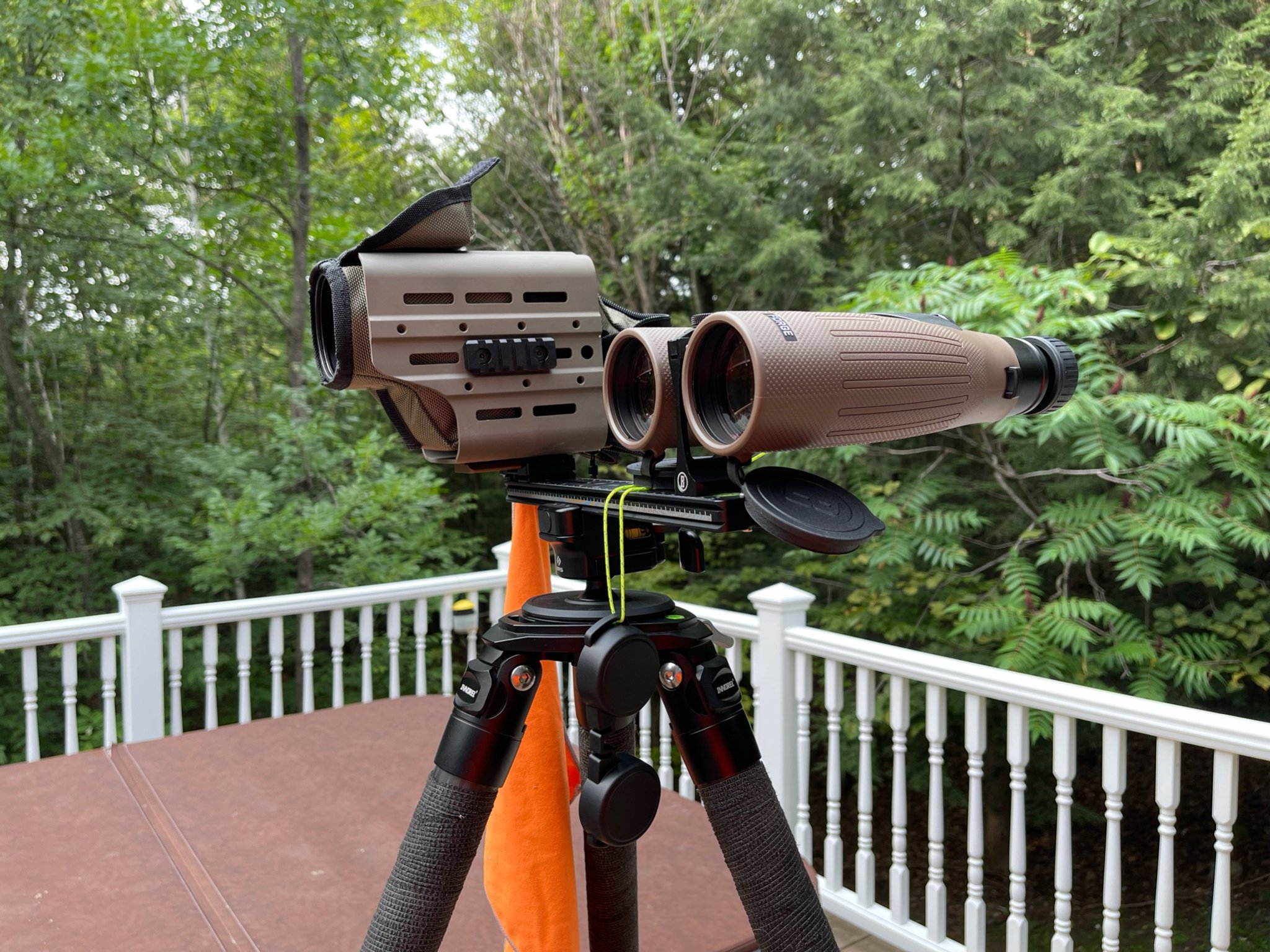

For centerfire matches I use 15x binos, which offers perfect magnification and it translates well for getting behind my actual optic for a stage because I shoot everything right around 15x.
For rimfire matches I've found 15x is just too much. You end up having to pan on your tripod to transition between targets on a stage because you don't have enough FOV on 15x binos. For rimfire matches I use my 10x Sig BDX 3000s, which works out twice as nice because we use them to verify range on targets as well. If you've got $1k, I'd highly recommend the Kilos so you get the ranging functionality and a great bino that can be used to spot both rimfire and centerfire matches if you wanted to.
