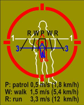

Might be true, but then again - some math might be quicker compared to this:
Aiming heights with colors: green = 200m, blue = 300, red = 400m.
Leads for moving targets: P = patrol, W = walk, R = run, S = sprint.
Maybe 4 numbers would be easier to memorize?

I don’t even know what that is or why it’s posted. You’re making this complicated.
I agree: the picture is complicated. The point I was hoping to rise is that lead for 308 in my DOPE card is neatly speed in km/h / 3. This is something I can use without using calculator, charts or ballistics computer.

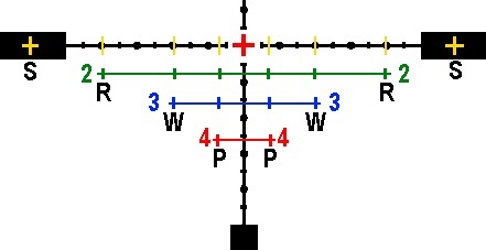

I tried to visualize similar information for Holosun Red-Dot for 5,56 NATO ammo - the sight is zeroed at 200m:

This is not long range, but for AR or similar 5.56x45mm ammo and HoloSun red-dot this would be the rule of thumb:
Should be good up to 200m (and is not needed beyond that range anyway).
