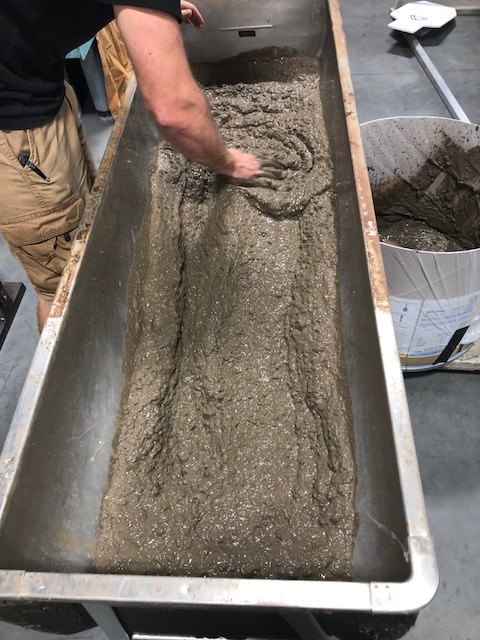

The practical question/answer is what is likely going to get into your action/rifle?
Dry conditions will mostly be the fine dust that gets blown around while carrying and set on the ground. Sand really isn't blown in most conditions, its the fine silt dust particles.
Rain/snow will be water. If you start dry then wet, it will be muddy moon dust. Otherwise, just wet and maybe frozen depending on temp.
If you are really in the wet for a while, unless protected, you can get mud on gear from all sorts of things if you are handling your rifle and without a way to get clean. If you've ever camped in the mud, you know it can get everywhere.

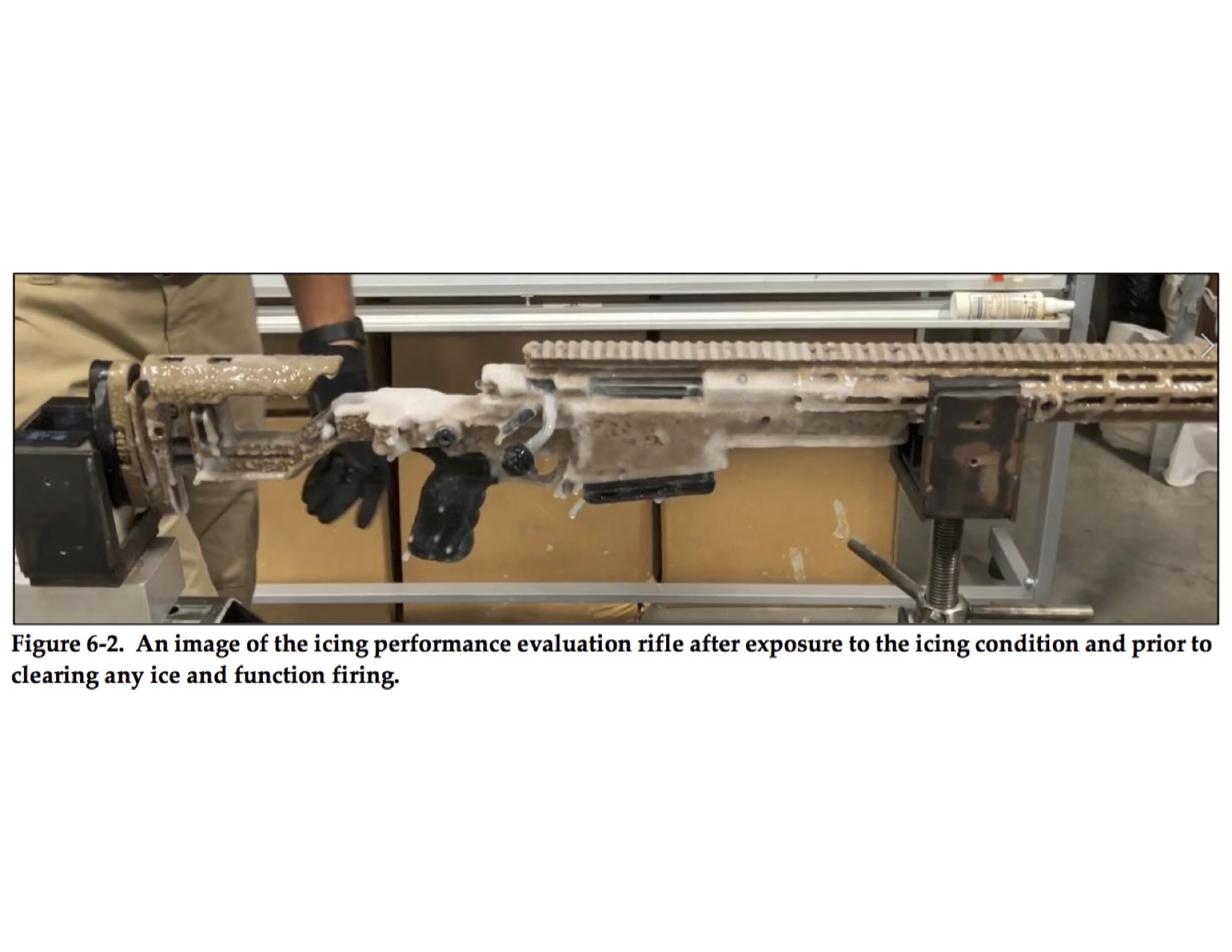

So, I'd test:
water/ice
mud with different sizes of particles because it will carry sand, vegetation, even small gravel.

soil mixed with vegetation is a good idea, flat surfaces/leaves will not roll off easily

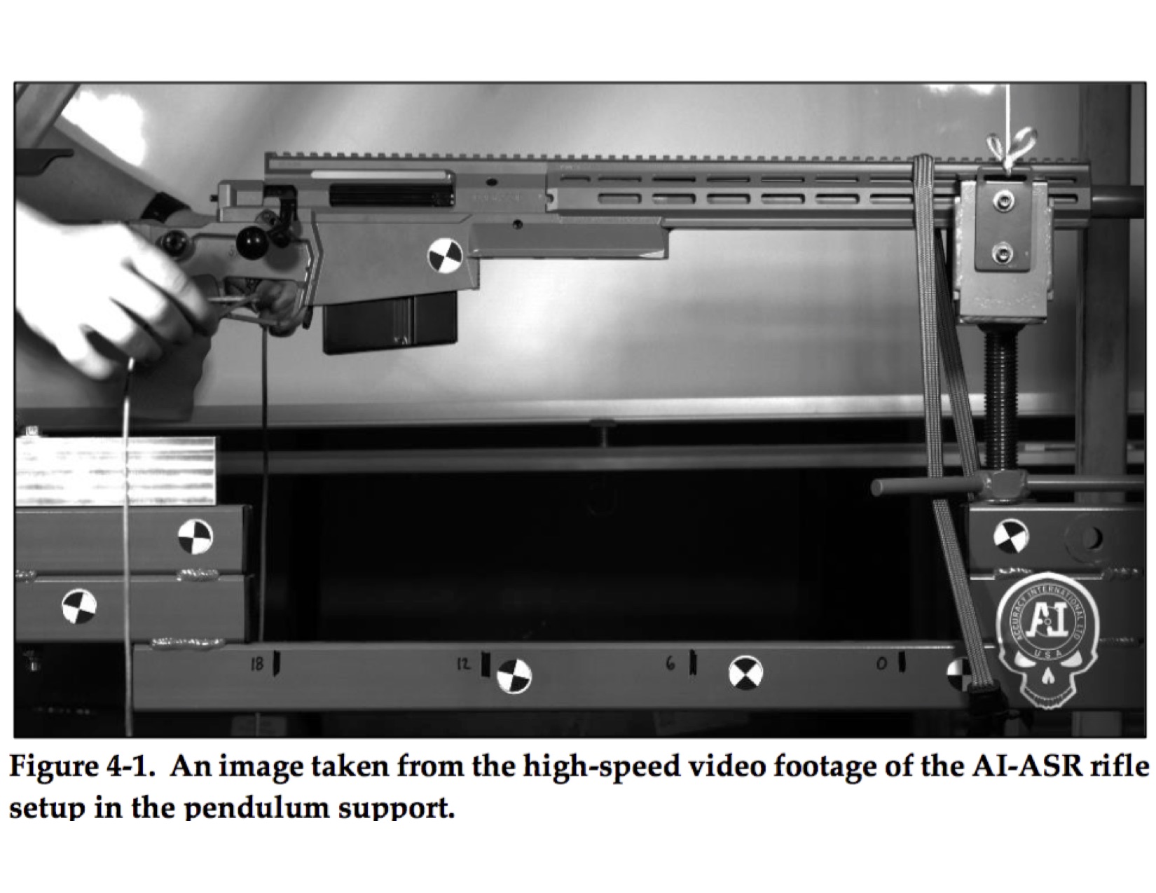

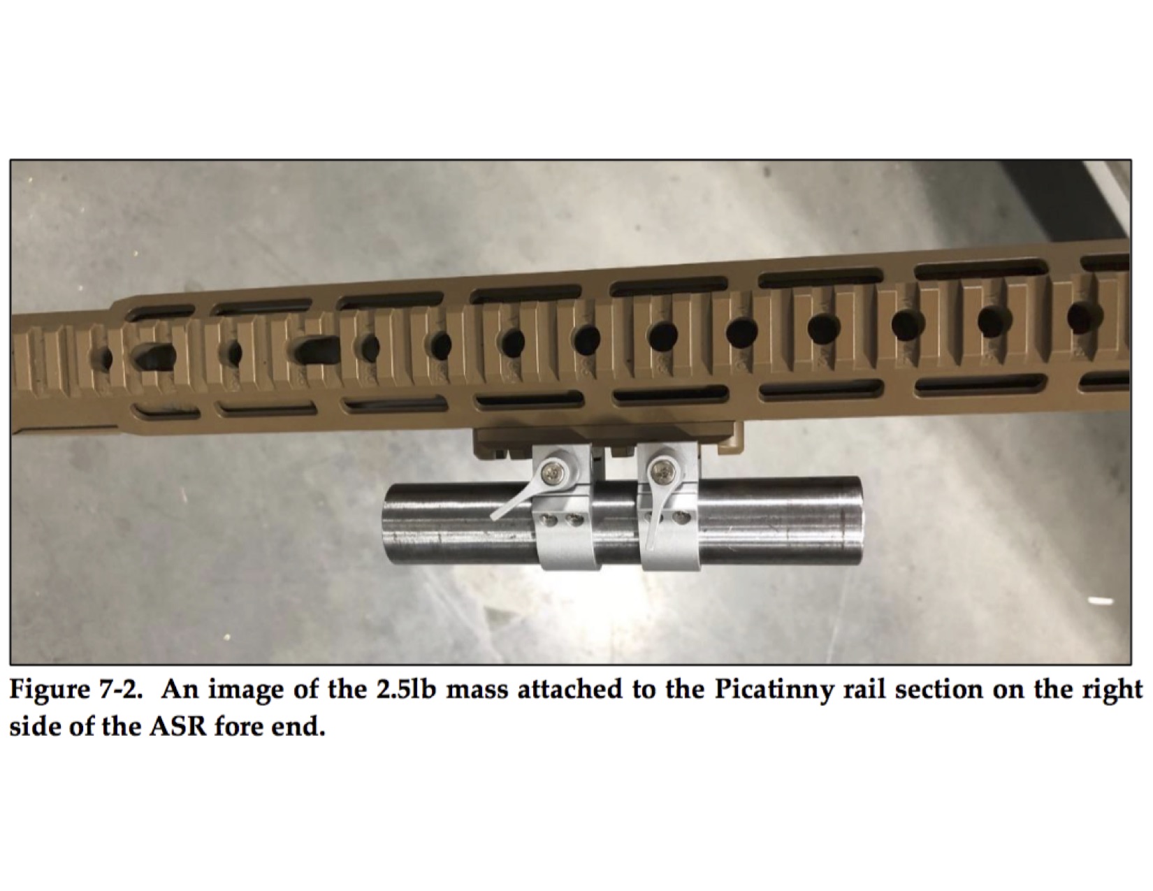

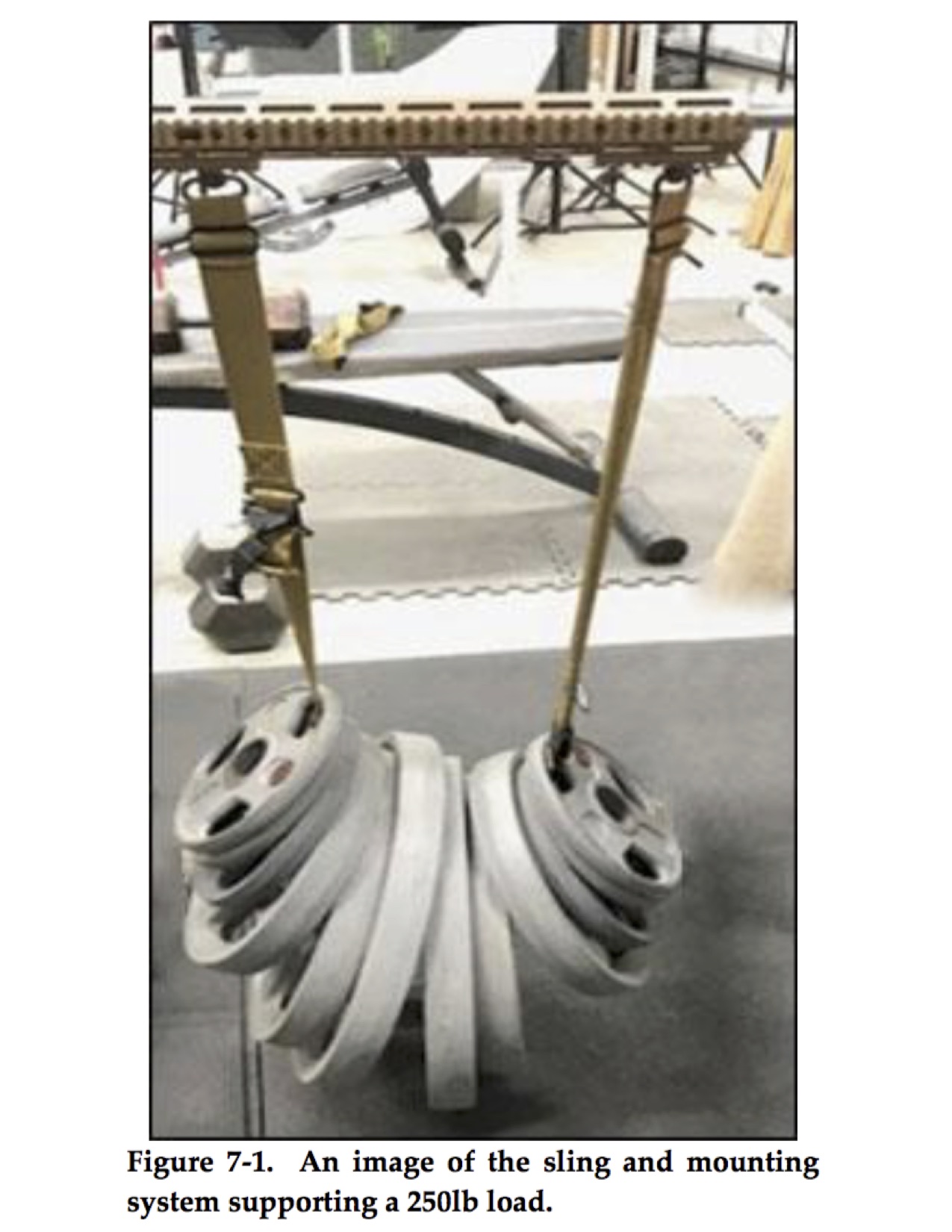

It is ashamed that the firearms manufacturers as a whole do not support and take part in the NDIA more thoroughly.
The NDIA has a specific Armament/Small Arms Division as well as a Testing & Evaluations Division
Also ashamed that private companies such as HP White put out Small Arms Safety Examinations and Test Procedures instead of the industry itself. (Although severely dated, lololol)
Sincerely,
Theis

If you've never experienced brownout from a helicopter in general, its pretty rough. The 47's with both rotors and being much more powerful is pretty forceful. Every guy in the platoon had a little pre routine with their facemasks/goggles/shemaghs/shirt/etc. to help reduce the amount of shit would get in your collar, ears, eyes, skin, under your dick lol. It was nasty.
I would zip up my combat shirt like a turtleneck, stuff the bottom of my oversized shemagh in the collar and up over my face. We all had pairs of goggles we'd wear as regular eye pro was useless. Then after the 47's flushed you'd shake it all off and get ready to walk lol.
To give an example of the force of wind and where dirt could get. Our mag pouches had small drain holes on the bottom of them, and we kept mags face down. You would get dirt up through the hole and easily be impregnated onto rounds in the mag 10rds deep. Cleaning out mags was almost a daily thing, maybe weekly at the least.
I DO think that natural high winds could have a similar effect, but no way natural winds are creating that much down force which created like the bottom up mushroom clouds of dust from below.
IME it was not the triggers that had any real issue, it was the bolts and bolt carrier. The first time I used zero protection on my 46, it gummed up pretty bad, to the point where I'm not sure it would have cycled completely or not jammed lol. And for all the Chair-force morons out there, our platoon had mainly worked in Northeast AFG, so the brownouts weren't that bad dirt wise. Southern AFG was a whole different animal.

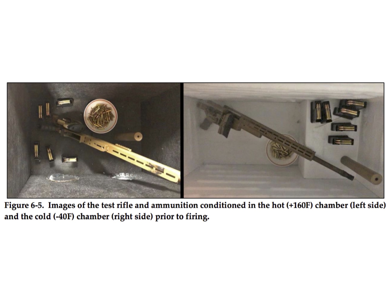

In the auto industry, exterior components need to go through a combined Arizona dust + salt water spray. It's nasty. Interior parts get subjected to stuff like the "Coke spill test", which is exactly what it sounds like with a 24-hour bake at 85C (about 185F) for 24 hours that does a good job of setting up the sugary fluid into a sticky goo.
There is also a fun thermal shock test that involves heating a part to its max operating temp and then dunking it in ice water, which does a good job of sucking water past any seals. I don't think that applies to rifle actions, but it would fuck up a scope quite nicely.

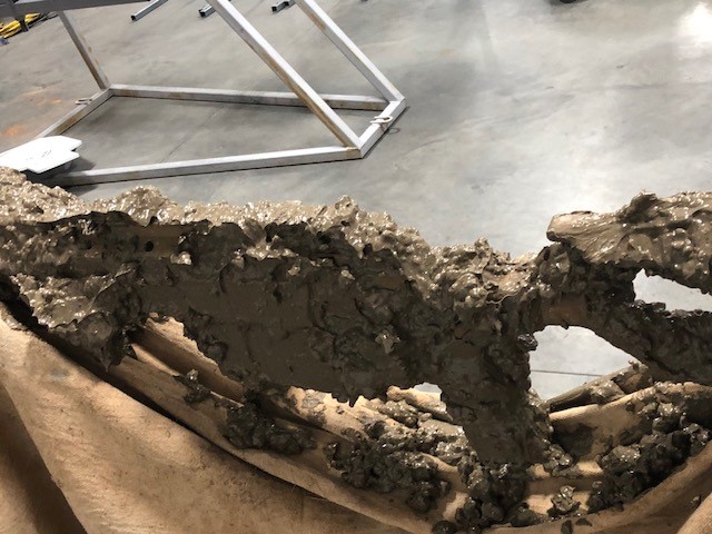

Does it need to work when muddy? Did you know there is a MIL STD mud recipe? Yes. The rifle is completely submerged.
Ready to shoot.
Do you expect it to be hot? Again, there is a MIL STD test specification.
Will you encounter freezing rain?

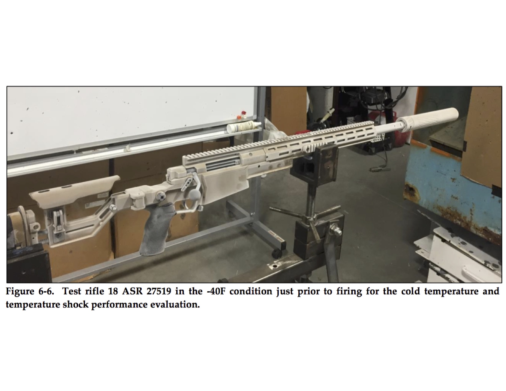

What if it's really cold?

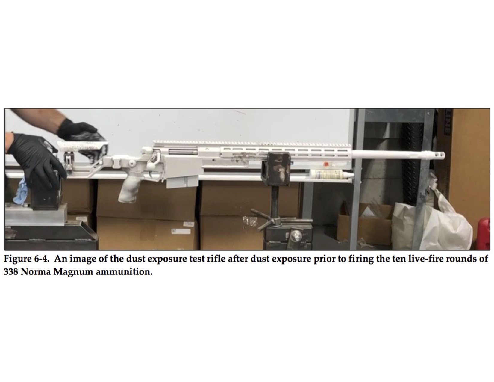

Do you expect it to be dusty? That's a pretty dusty rifle. There is a MIL STD recipe for dust. Who knew?

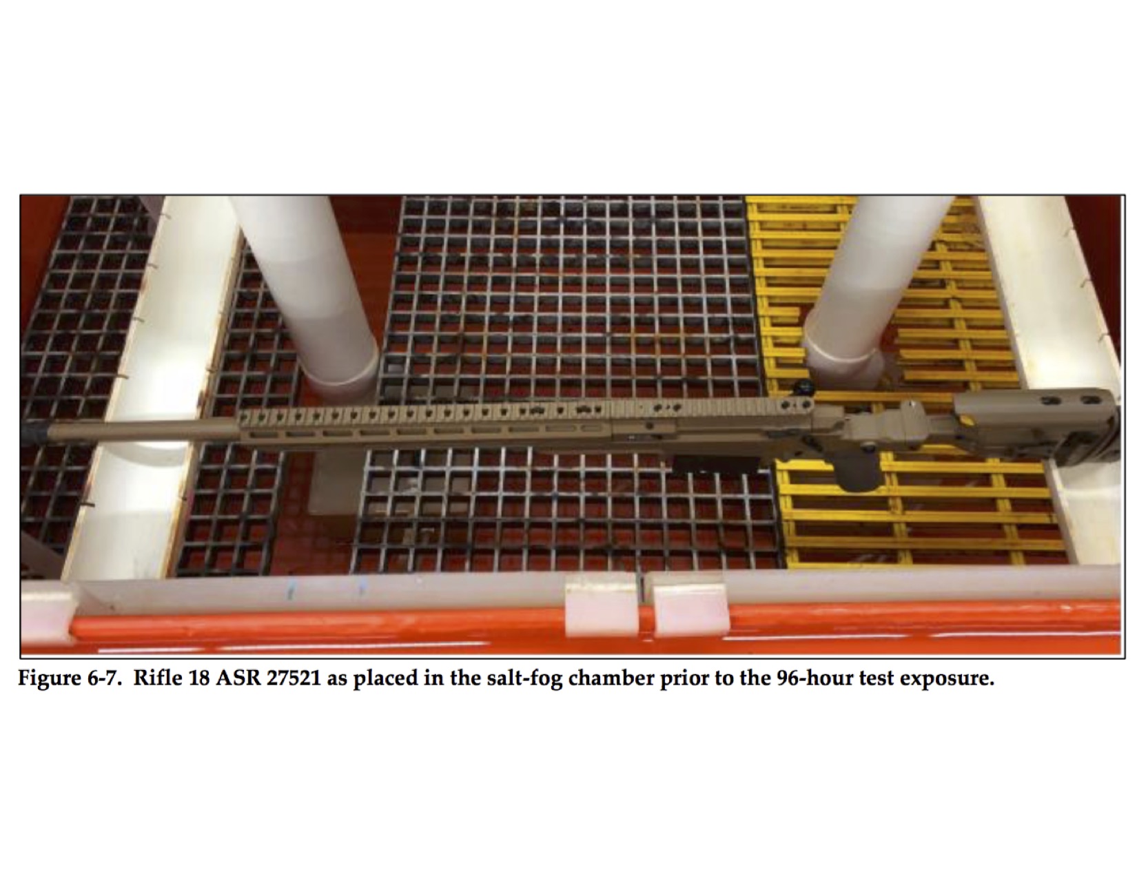

Marine environment and salty conditions? Maybe for four sold days without interruption?
Do you expect the rails and sling points to stay put? Lots of shots fired with various rails to test for movement.
A simple but effective test for sling and sling attachment loading.
Maybe you need to bail out of a plane at high altitude and you need your rifle to operate on the desert floor a few minutes later? Could happen.
Do you absolutely need to understand the recoil impulse of the rifle system with and without a suppressor and guessing is unacceptable?
