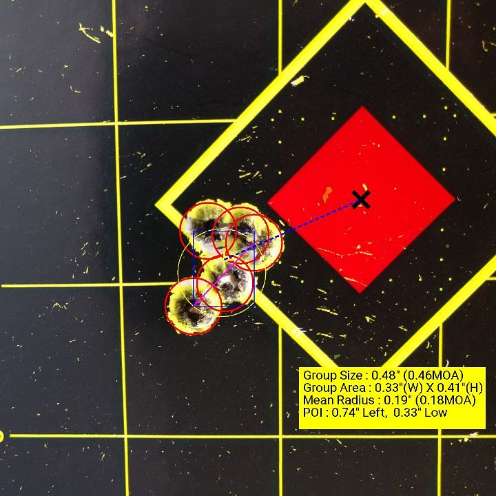

This is a group that I shot at 100 yards with the 129 gr Superformance. It's the tightest group I've shot so far. The Prime 130's I can't seem to shoot worth a crap with my gas gun or rpr. The Hornady 140 elds shoot about the same at the Superformance out of my gas gun. I haven't tried the Winchester 140's yet.
