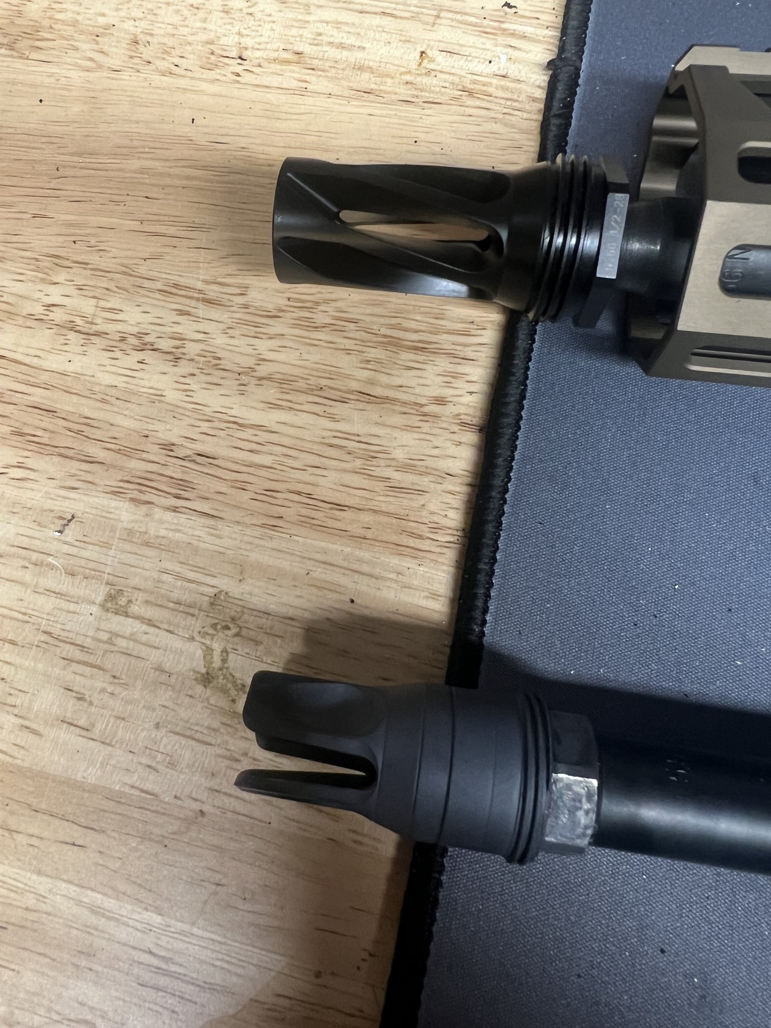

I have removed at least 20 muzzle devices. I use Chamber lug block or barrel vice and a butane torch with great success….. until I came across my 16” sig spear LT. Removed my sig spear 300 blk easily then came tried this dirty #%##. Have put way more heat and torque than usual on 3 attempts. Haven't tried boiling because I have a torch. Going to give it a try because lower and slower may do it but I doubt it based on my limited understanding of metallurgical stuff. I figure a torch expands the muzzle device circumerentially as you appy more heat to the outside making it “looser” and breaking down the rocksett. The advantage of boiling would be breaking down the rocksett more? I could also use a better barrel clamp as a next step.
Here is a pic of my spear 300 blk for proof I am not a total moron.

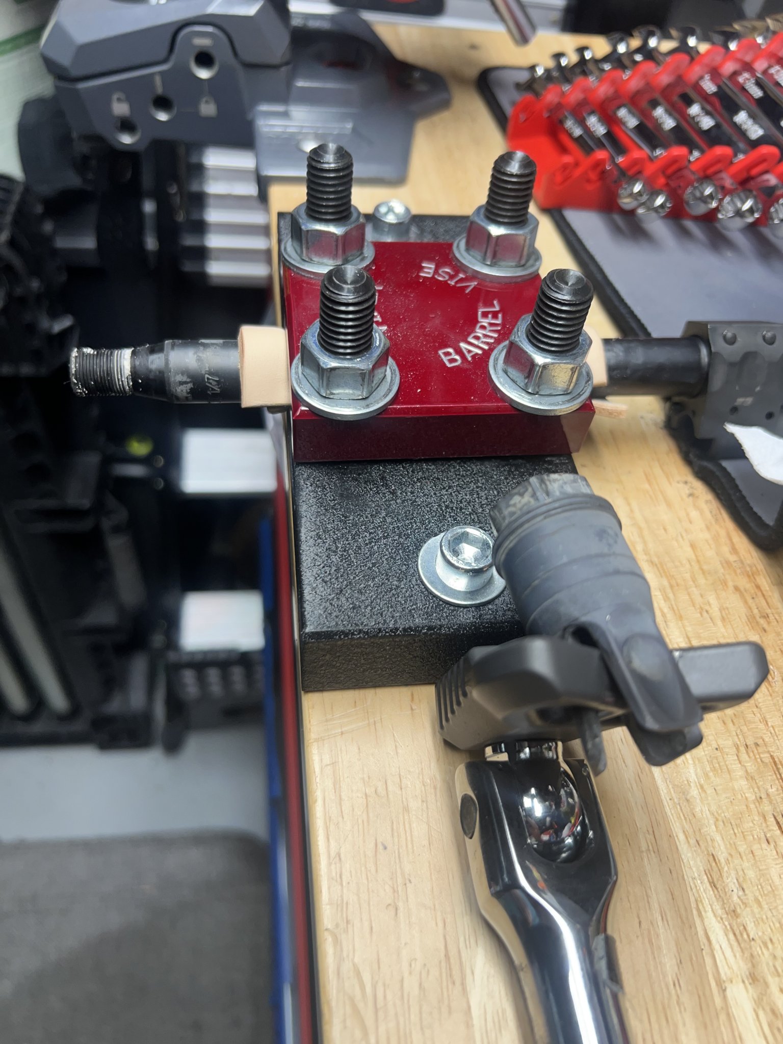

on that topic, i recently looked into the geiselle reaction rod. bought one and have barreled a few things with it and used it for flash hider work
is the much of a down side to using the barrel extension this way and putting force on it?
Reactions: Yondering
It's actually the preferred way. I have one for my Sig Cross and need to pick up one for the AR's.

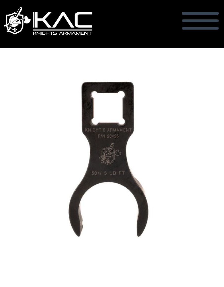

this KAC wrench? thats different than the geiselle reaction rod. it goes into the barrel extension and locks up on the splines.
i needed it for doing a left handed upper. not many options for lefty shit.
