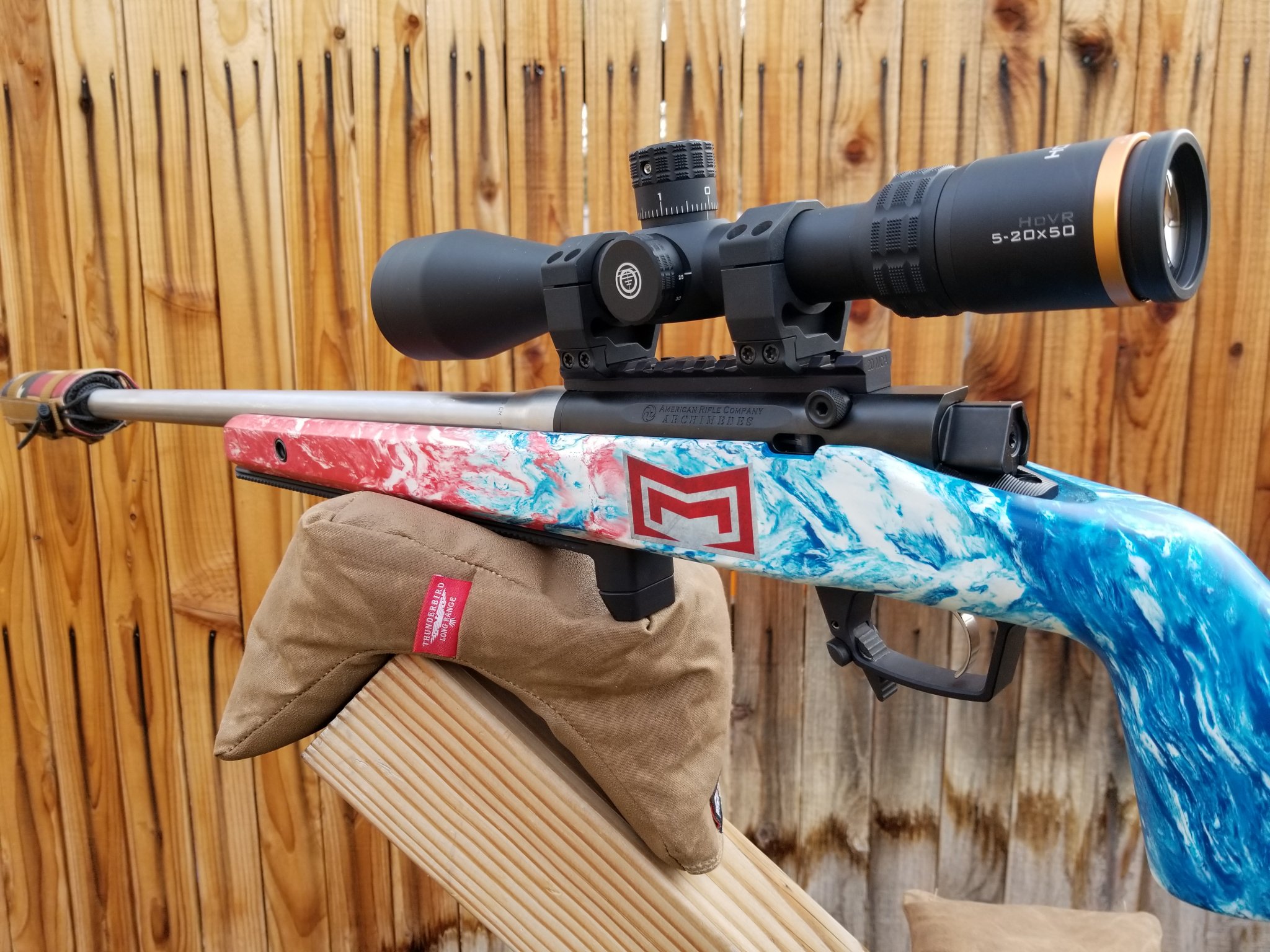

Proof barrels and their prefits are awesome. My Savage prefit on a Nucleus in 6 cm is my match rifle.
