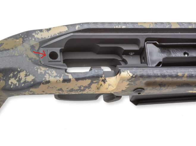

    From the info I've gathered so far, the Manners Mini Chassis is the only inlet that seems to confirm the rear tang is floating. Manners calls out 65/45 for a front/rear torque.
    MDT, MPA, XLR, and KRG all call out 65/65 F/R. AI-AICS calls out 53/53.
    I don't know if that means the rear tang is in perfect contact on those inlets? Or if possible there is still some rear tang float?
    Just one point- Manners had the raised bolt tang support for awhile now, no?
    I know my krg doesnt as I had it out recently enough to fresh memories, not sure of the mdt or xlrs, never paid attention to it.
    Is that the Gen 2 MCS-DBM Mini Chassis? I'm struggling to find pics on Manner's site that show that, or if the Gen 2 calls out a different torque spec.
