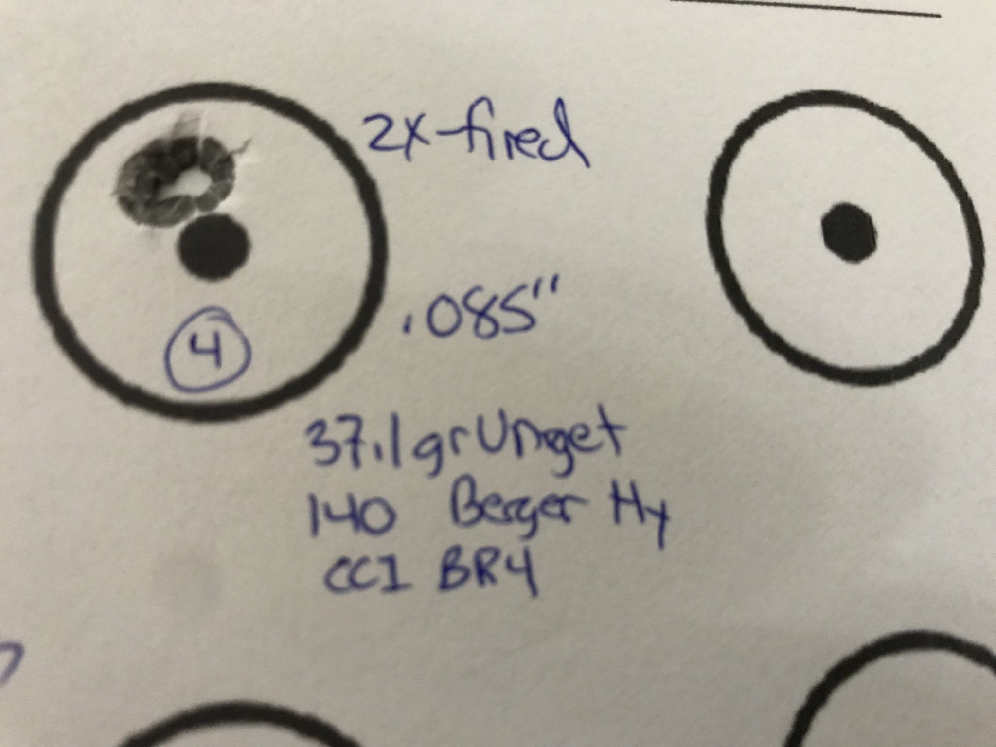

140 Berger Hybrids & Varget. I’d love to shoot a lower cost bullet, but none of them seem to be as consistent or as accurate for me.
At just under 2000 rounds on my current barrel, I re-measured length-to-lands, adjusted seating depth/COAL to match original load, and shot a quick 3-shot group (prone/bipod) to check zero & re-check load accuracy.
