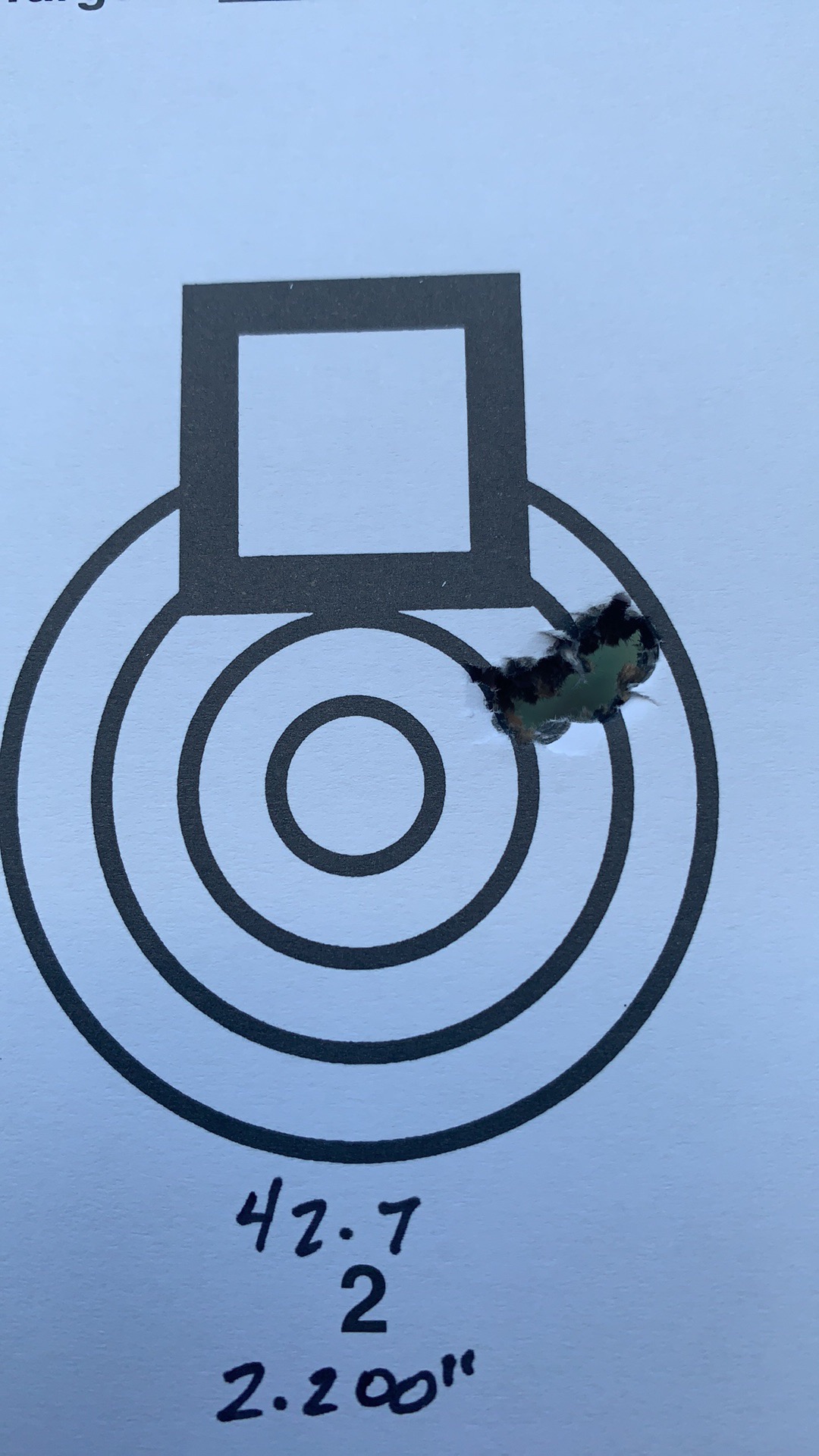

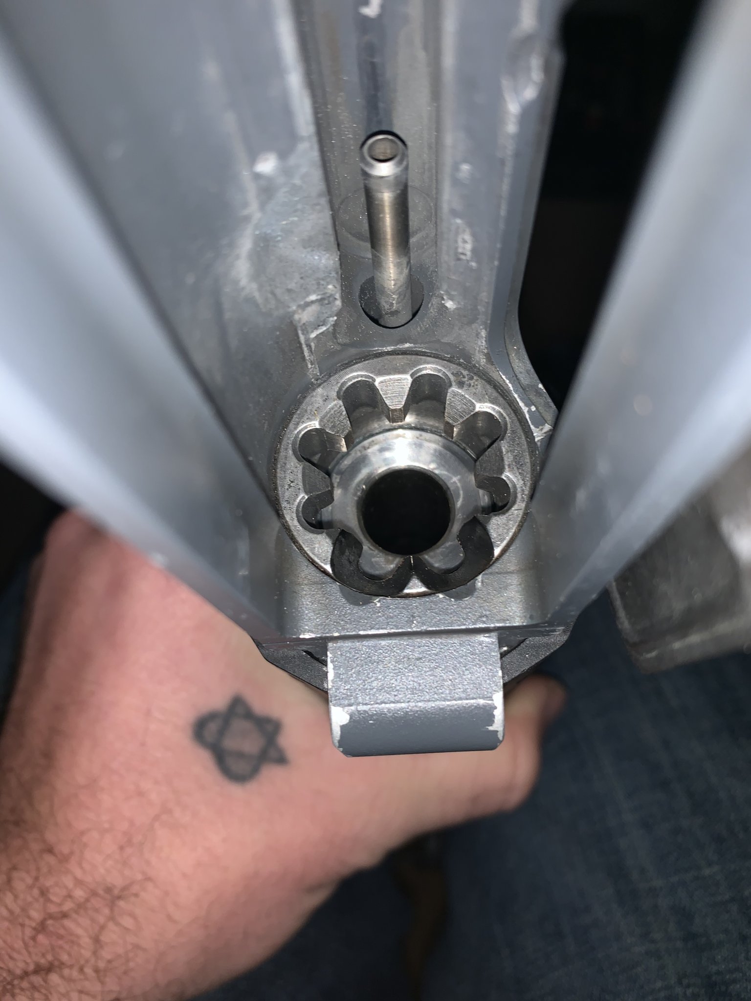

My bad on posting on the wrong forum... I’m a cherry on this site! But while I have someone’s attention... make my brain big!
Second pic (pretty crappy) is of my extension and barrel. The first is of my final load dev group prior to my discovery. So the barrel and occasionally myself are capable of getting around 1/4 moa. On the barrel pic, If you look closely, you can see where the meplat has been striking the barrel at the 5&7-o’clock .
