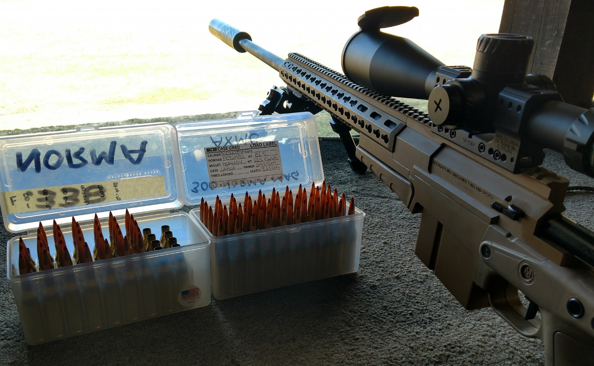

300 or 338 Norma Magnums. I can appreciate the extra case capacity of the "improved" versions but I run the standard shouldered calibers because dies are readily available, no need to fire-form brass and very easy to load for. I would think the 300 PRC would be another viable candidate as well.
As I sit here shooting my new 338 Norma barrel comparing the two?. LOL
