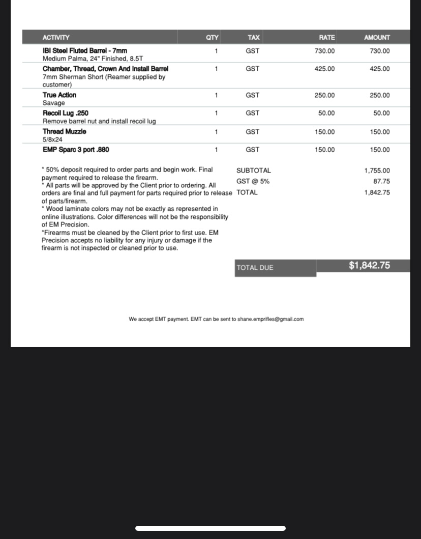

I have 2 Savage 110 tacticals both in a 6.5 PRC, I really don't want to sell one but instead i want to keep both of them and try to find benefits of having two rifles, in the same caliber. I was origanly going to convert one of them in a 7 SAUM, but I learned that cartridge would perform better in a long action instead of short. So now I'm back to square one. Any help would be need, i appreciate it.
I’m in Canada a btw and this is what they’re charging for a cartridge change, which 1366 USD

Holy smokes. That's not even shouldered, correct?
PVA prefit is the way to go for sure if you can get them to send it up north. The osprey prefits are top tier and PVA will supply the sherman reamers.
I have an American address so I’m gonna go through with them and get it done. Do they do 50% deposit or pay all
Upfront? What do you think of the rock creek? I only ask cuz the Canadian/USD currency exchange is brutal lol

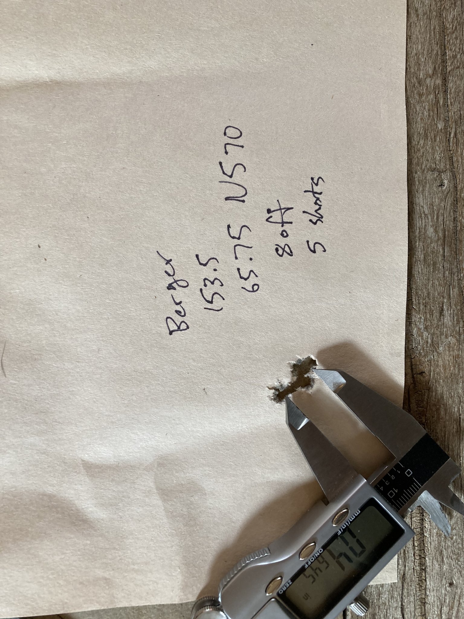

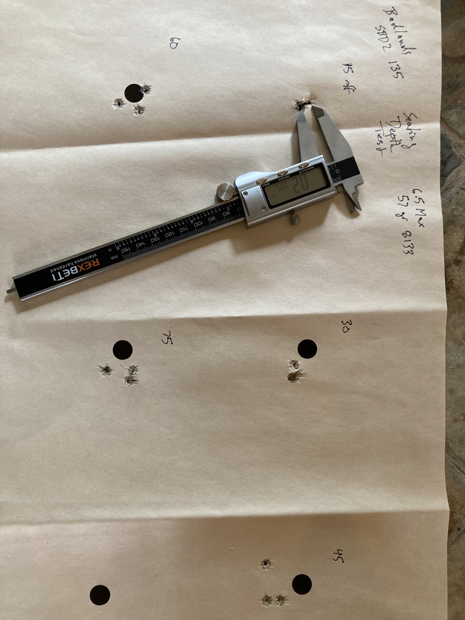

Here is a control group with Berger 153's, followed by a seating depth test of Badlands 135's...
***Rich recommended close to the lands - forums said not with solids... see who was correct...
Reactions: AppaDaSquid
View attachment 8038733View attachment 8038734
