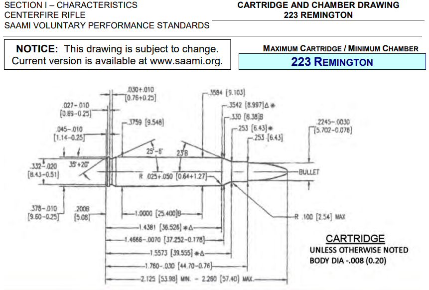

You'd think there would be some kind of standard drawing. Hmm.
Reactions: simonp
