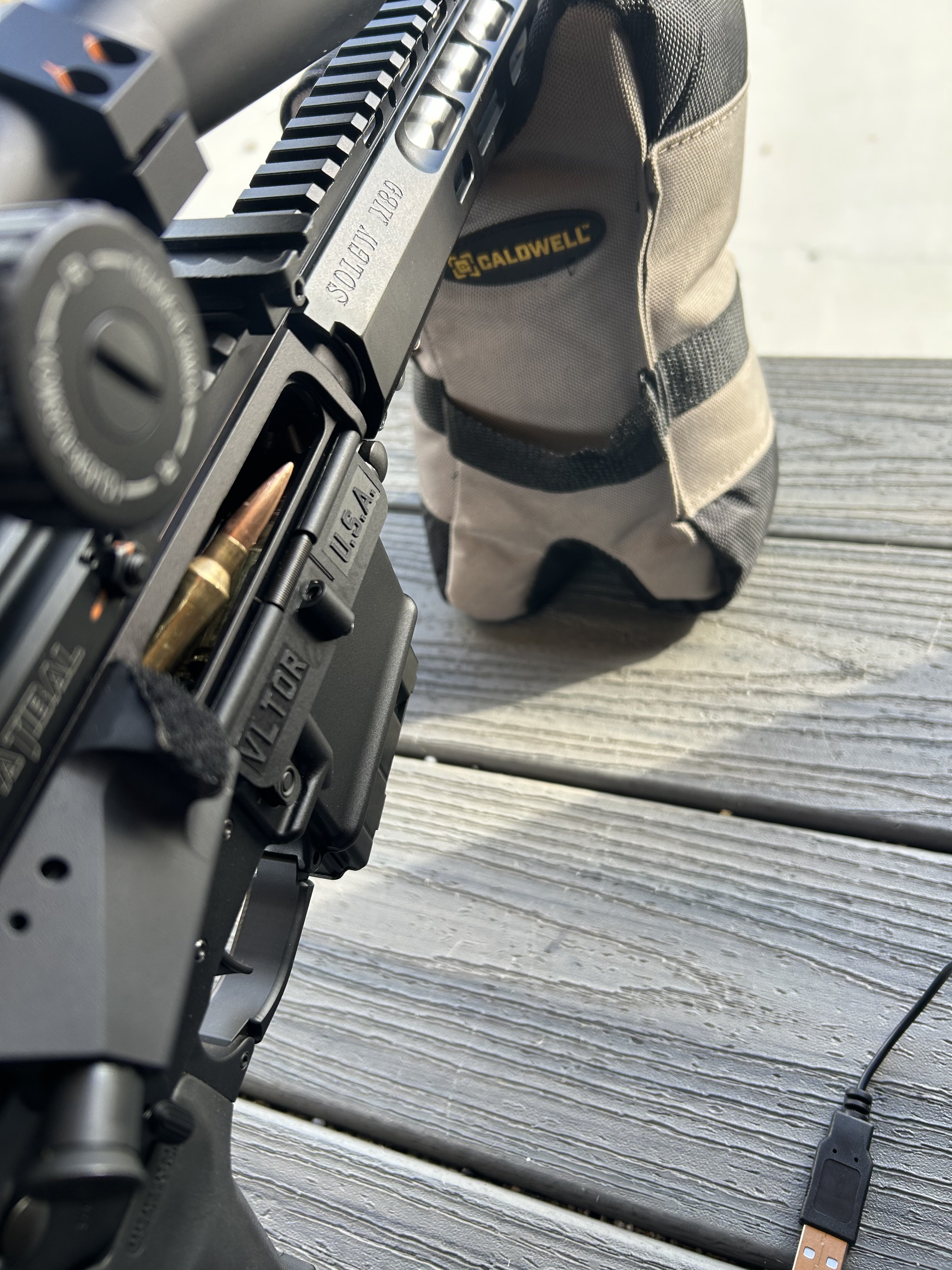

The below happened when I was at the range today and manually cycled the action to make sure there wasn’t a sticky bolt close/open. It closed and opened fine but when the cartridge got to the point where it should have shot out of the upper it didn’t and instead it just clung to the extractor claw. I had to pull it off by hand. It didn’t happen for every round in the mag but it did happen maybe 2-3 times out of 10. I checked and the ejector plunger moves freely/isn’t sticky. Mag being used was a duramag 6.5 gendel 10 round.
This is a rubber city armory bolt with sprinco 5 coil extractor spring (with insert but no o-ring) and sprinco ejector spring with only 100 rounds on them.

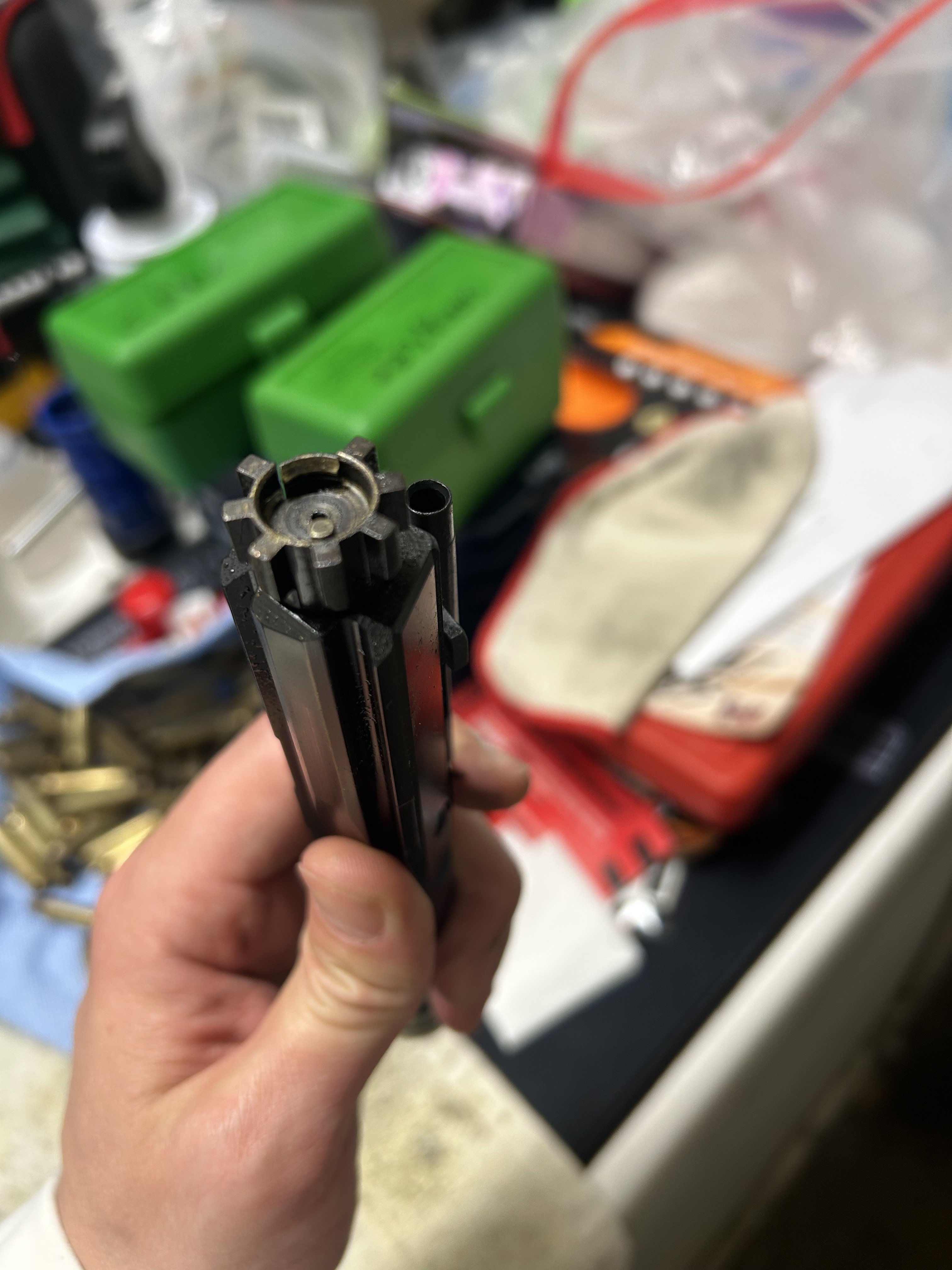

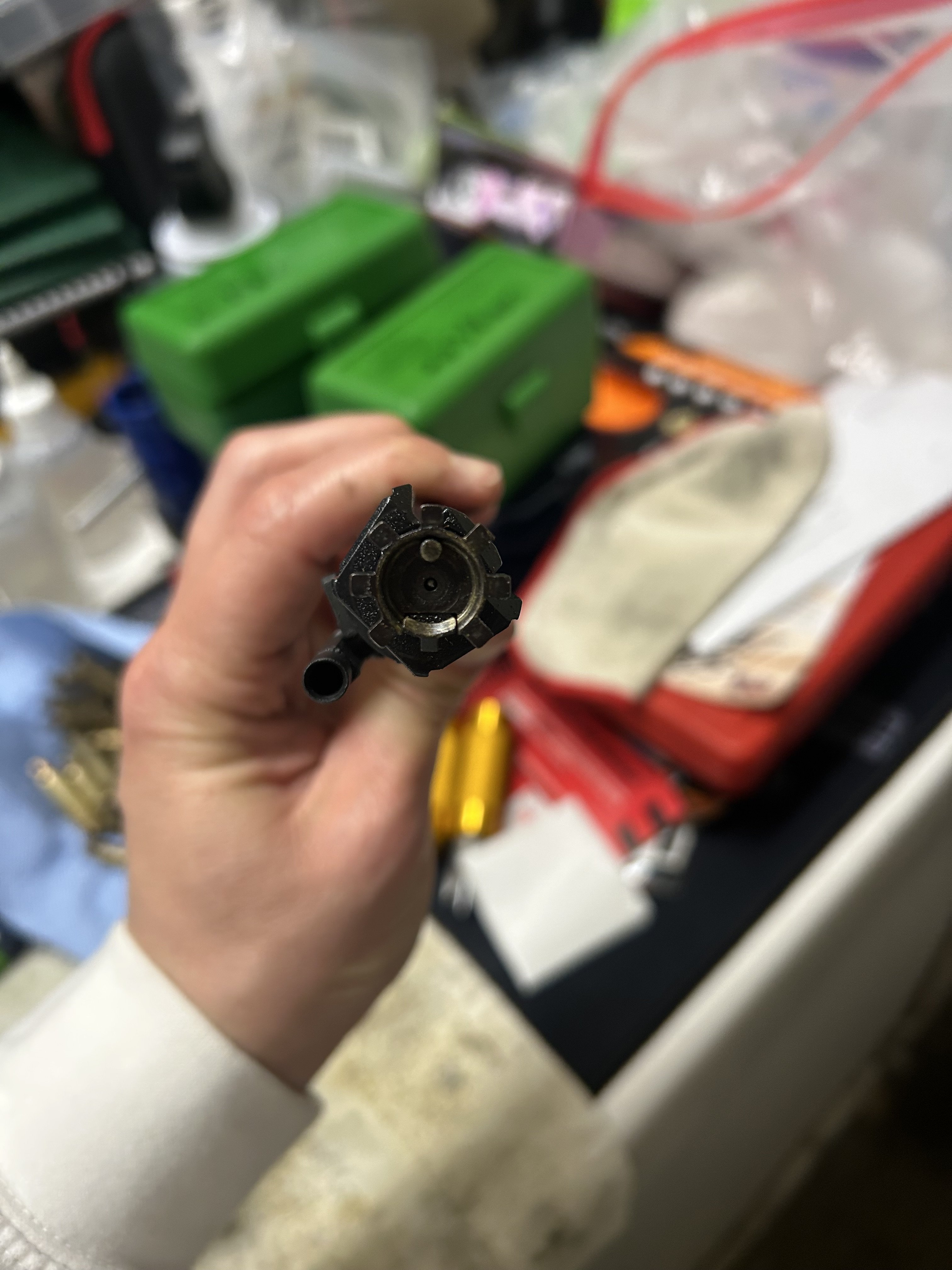

Issues with the ejector and its spring, perhaps?
Resistance should be significant even when using the cartridge as a lever.
Issues with the ejector and spring, perhaps?
That was my first thought but the sprinco springs in the bolt are still practically new with only 100 rounds on them. I can swap the springs out pretty quickly or I actually have a spare bolt I can try to see if that narrows things down.

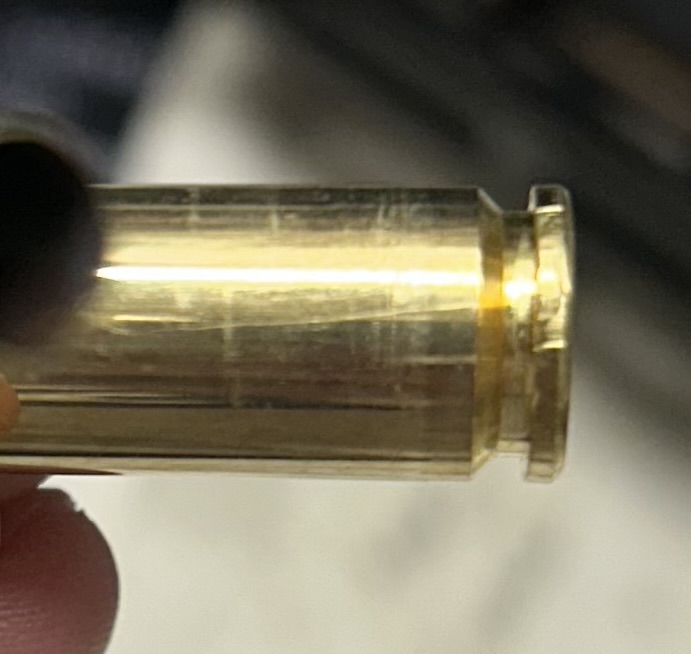

Sometimes they can dig into the case head and some folks will bevel the top radius. Have read reports of folks finding that step helpful, but never done it myself. This would be different from its cylindrical trueness, and more about its top edge that contacts the case head during extraction.

Yeah good point. The top edge of the ejector does have a bevel. After looking at the brass some more and reading comments in the thread im pretty sure the extractor is the culprit but Ill be doing a few things to narrow that down (put original extractor spring back in, use completely different bolt, etc.)

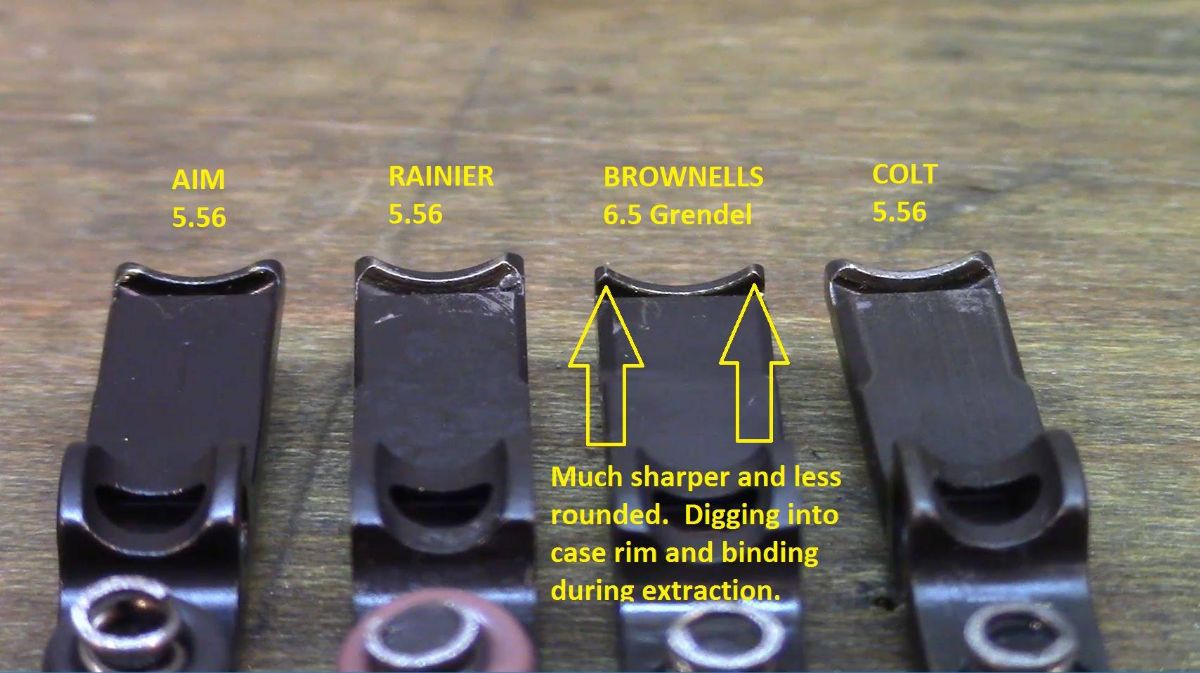

Without looking or feeling the extractor edges, my money would be on Cascade Hemi's reply.
I will always polish the "teeth" to make sure they are smooth. I have seen them pretty sharp. A cratex wheels, and about 2 minutes including looking at the finished product under a magnifying lamp, and those gorges on case rims just about disappear. Everyone has their own opinion on extractor springs, but that donut gets chunked in the trash on mine.
